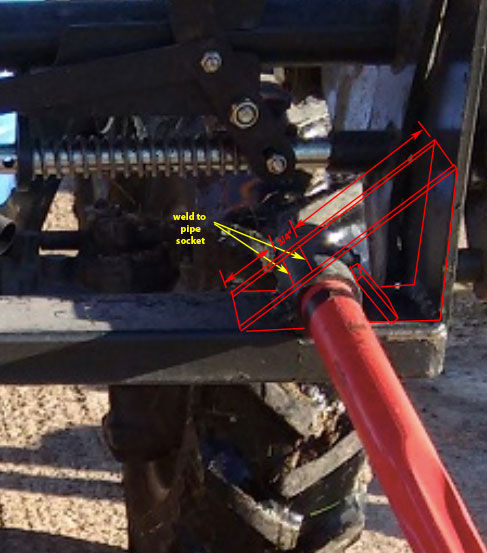

Here's another way to brace it, would look clean and be very strong. Two triangular gussets then box it in. If you put two separate fill-in webs 3/4" apart then you can weld to the pipe-socket and it will be really strong with the pipe/socket is braced at 4 points around. Easily done with 3/16 or 1/4" material.

Sodo, thanks for marking up the pictures, I can see now how those gussets would make it much stronger.

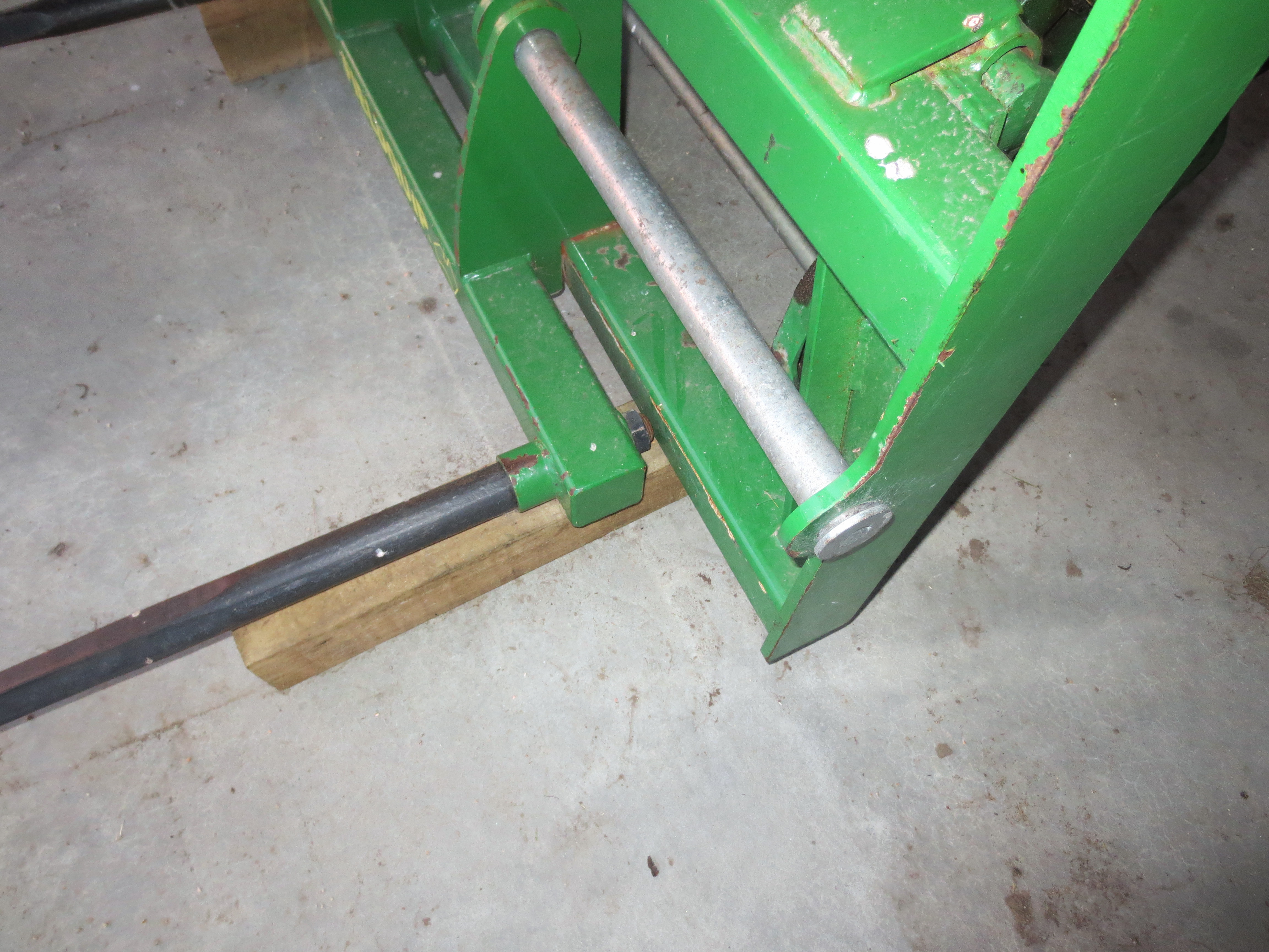

Wagtail, that's another interesting take on how to do it. Is yours sleeved with tubing where it goes through ? If you get time, a picture would be great.
I thought you might ask Mate, so I've 'run' out to the shed and took a few snaps. On my backstop/frame I can swap between the bale spikes or a set of (bloody heavy) pallet forks by un-pinning the shiny steel poles & then sliding them out enough. However the concept of the sleeve going through the tubing is there. The bale spikes are then bolted on at the back.
It's a very robust set-up as I've handled well over a thousand rounds of hay with it over two haying seasons and around my own property.

G'day Eric. If you're going to replace the entire rectangular tube then might I suggest that you make it so that you can drill/bore out holes and mount your spears through the tube. That is how my spears are mounted. It eliminates the potential weak-point of the weld.
This is the way to go. I'm with you Wagtail.

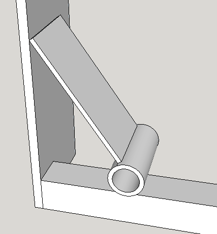

Much more elaborate than I was thinking, I had in mind something like this:
I know how easy it is to get carried away with some of these things and add a lot of extra weight which then takes away from how heavy a bale you can pick up. 10 lbs here, 20 there adds up...

^^^^ fast best idea right there, will be stronger than stock and easy fix

GLyford, that looks a great way to do it. Keeping the weight down would also help when it comes to putting the spike on and off as, unlike other implements, it is something that can be easily picked up by hand.
Since sleeping on it for a few days though I have gone and convinced myself that it will be an advantage to set the bale spikes a little wider while I'm at it, so I will put the sleeve right into each corner.
