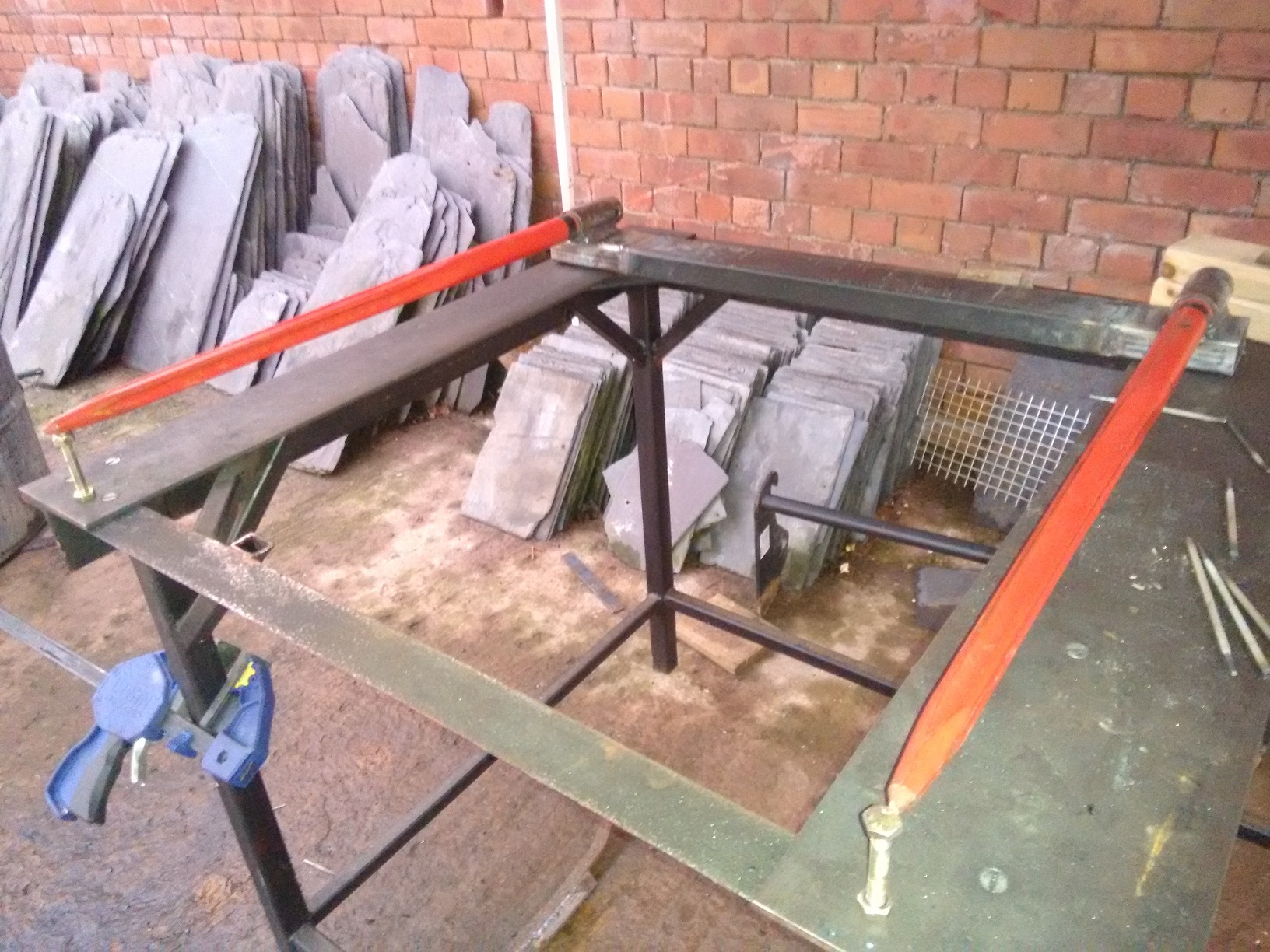

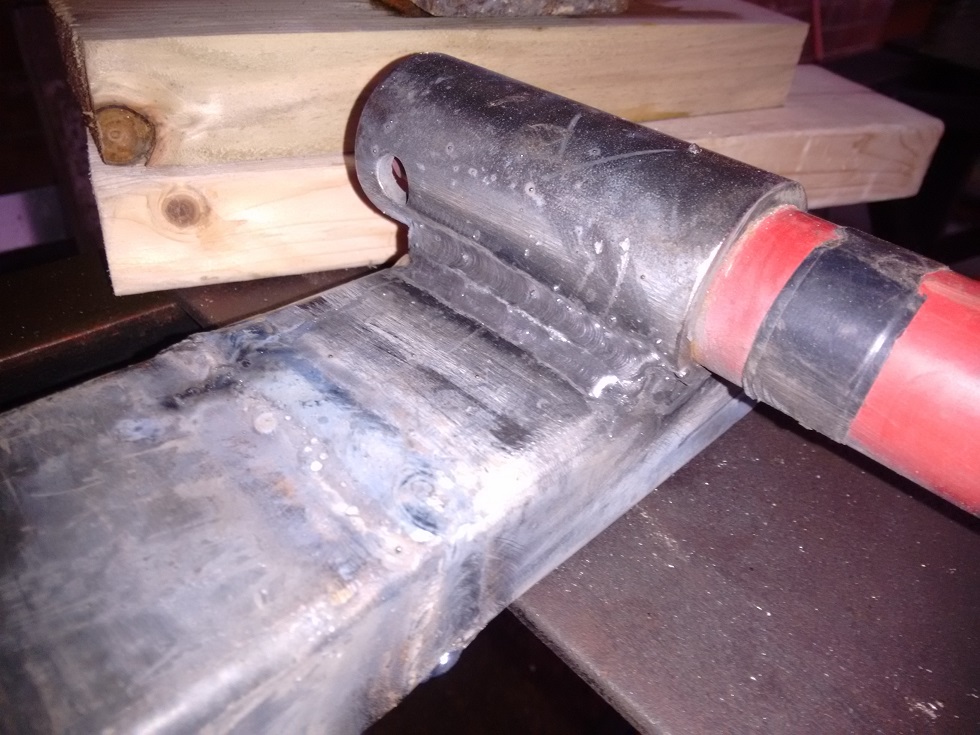

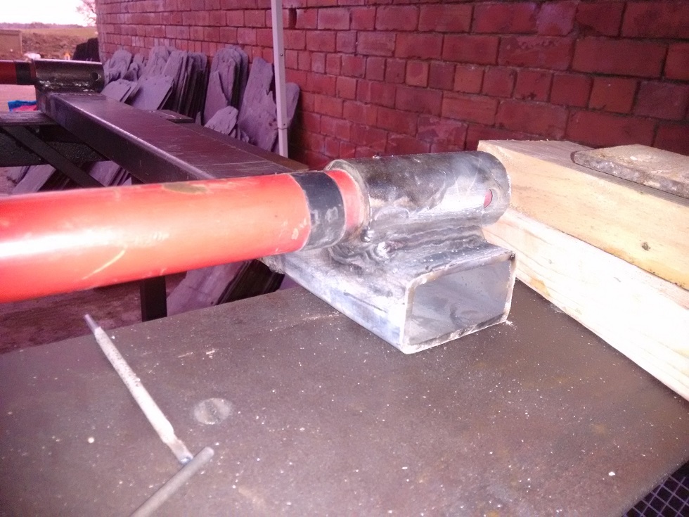

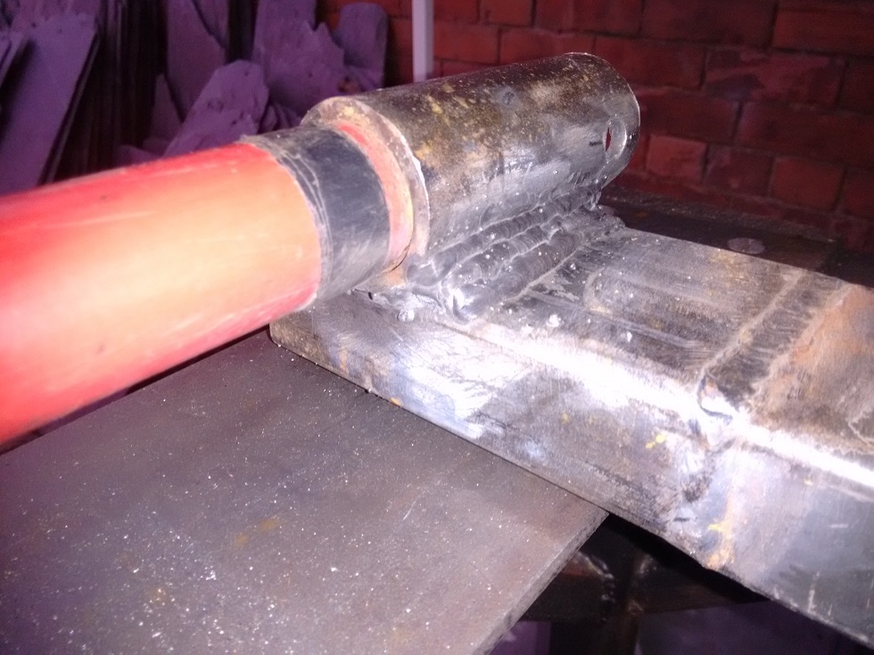

Although I'm keen to learn, my arc welding skills are still very limited, so this bale spike has been taxing me to my limit and then some. The old MIG welds are now cut out and ground off and I have a new bottom piece, made by cutting out the middle section of the old rectangular tubing and then butt welding a 5 inch length of thicker walled tubing onto each end.
Today I got on with the thing I had been dreading - welding the bale spike sleeves on. I struggle at the best of times welding round tube onto a flat surface and I feared with heat distortion, I would not be able to keep the spikes parallel and level. I've been taking it very steady and kept re-checking everything was in line.
Just hope these novice welds will hold up when I get it back together.

I think I would still put an angled brace in the corner. If you are like me you go way passed the limit of your equipment. So brace the heck out of it the first time. I have a saying. Do it right not twice.
:thumbsup:
   / Oops, I think I killed my bale spike #34
Ain't nothing wrong with your welding skills. I would put the little angle brace in there too. It would only take a few minutes and would make things much stronger.
   / Oops, I think I killed my bale spike #35

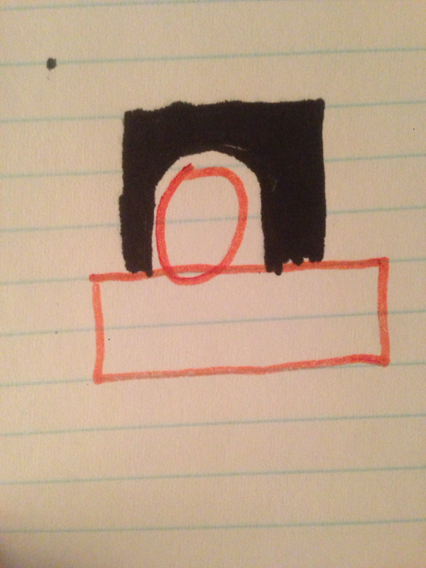

Those welds look fine to me. I would add some reinforcements though. Here's how I would do it.
   / Oops, I think I killed my bale spike #36
Nothing wrong with your welding, looks better than somepeoples that call themselves a weldor......Mike

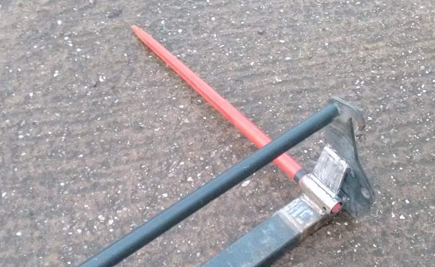

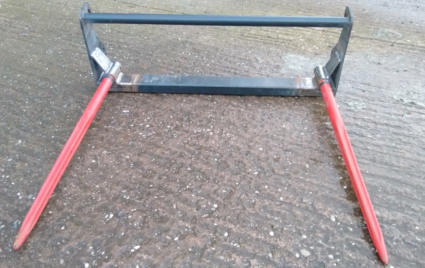

I need to move bales tomorrow, so I took time today to finish the modifications.
Many thanks for all the great ideas and support you have given me - much appreciated.
