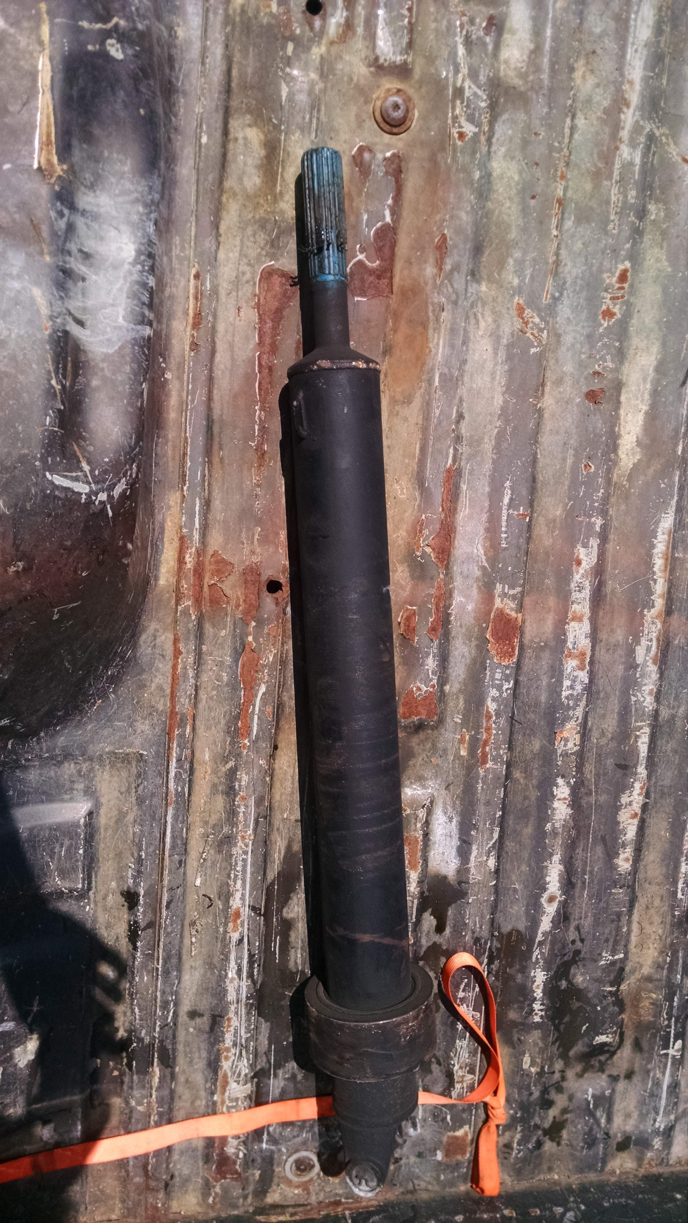

Yesterday's adventure, on the highway, at 60MPH, towing the tractor, of course...
Been a rough week.
