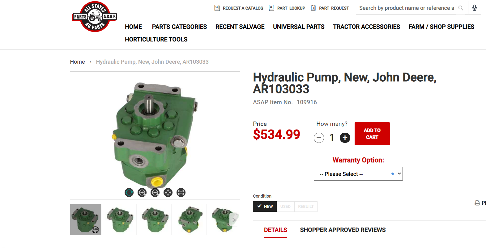

Just because the CC pump has a stroke control valve & inlet/outlet valves doesn't classify it as "gizmo" category to me. But I understand how a closed center hyd system was designed to function. My JD 4255 which has a similar CC hyd pump that I've owned since Feb. '93 has over 11,500 hrs on original(untouched) hyd pump that I could purchase a ""new hyd pump"" for a little over $500. Can you purchase a new hyd pump for either one of the tractors for $500? I'll bet it can't happen.

Nope. I did a pump and it was waaaaayyyy more than $500
