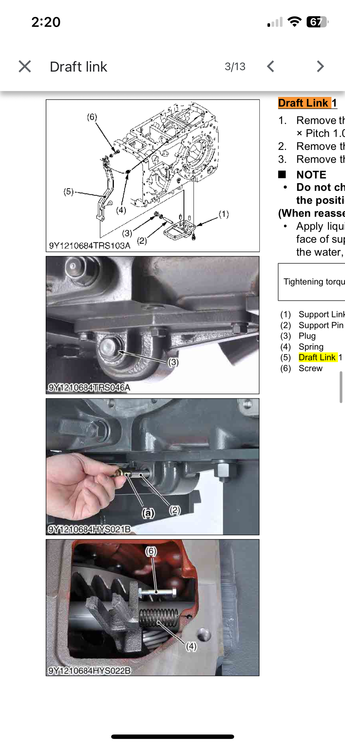

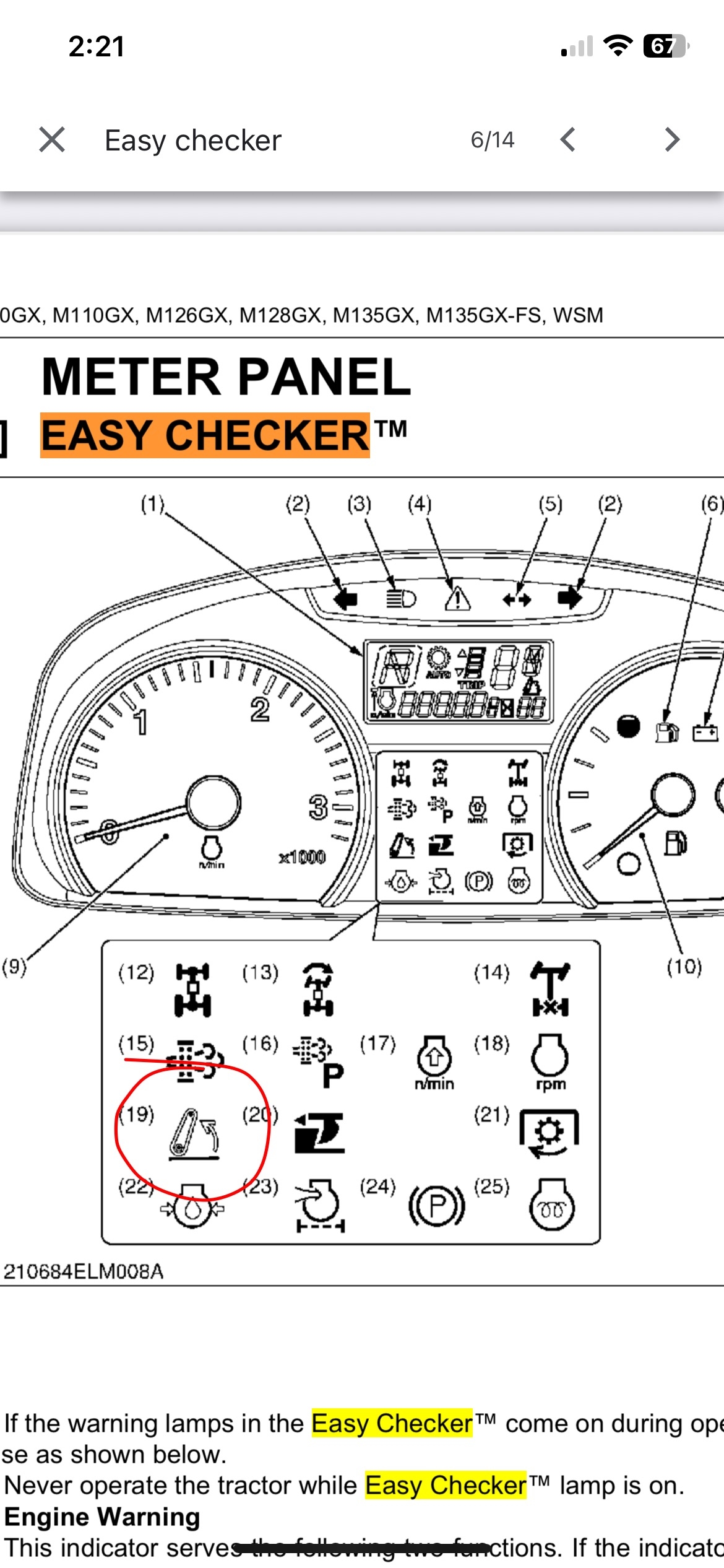

For whatever reason my draft link at the bottom can be seen dripping slow drips of hydraulic oil. Also I have this icon on my dash (unsure why ) . From the back , the switches allow me to lower and raise the 3 point hitch . Still no loader valve . Taking the timing to de-grease everything. It is a slow process . Stuck or failing valve somewhere ??

Sorry for the late reply . As for the update . Only getting low pressures on the gauges. The 3 point hitch goes down , but won’t lift with 2-300 lbs on it. I have noticed some leaks which I’m working to mitigate . I don’t think it’s the pump but I can’t say for certain . My next guess would be the pressure relief valve . It’s worth looking into .
/ open hydraulics #26
Since neither the FEL nor 3 point is working checking the system relief would be next logical step but a little unusual for relief to fail completely open but anything thing is possible.
