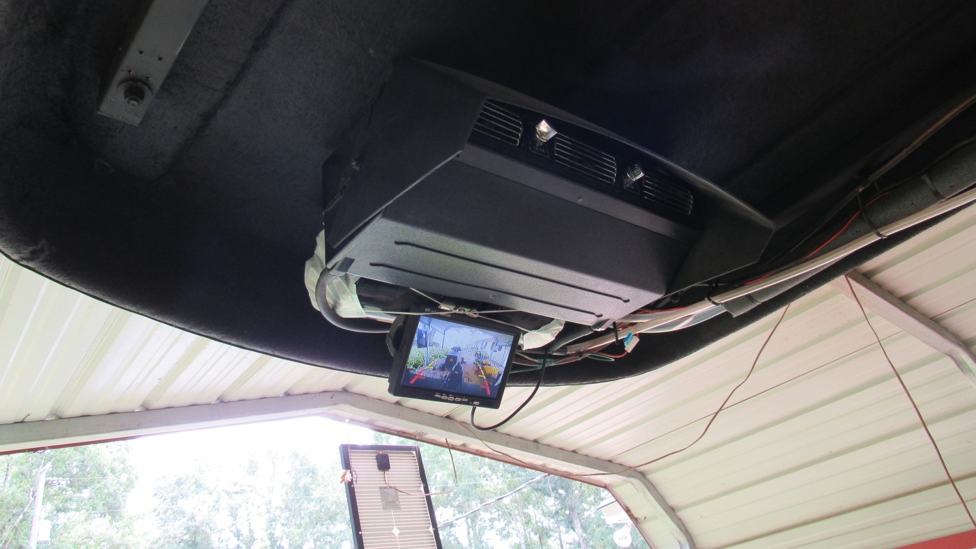

This has turned into just a fancy fan but it works good still. Just thought I would share my half failed attempt at an open station AC unit.
The original idea was some way to get cool air blowing on me as I work. I acquired a under dash evaporator unit off of eBay for about $75. I looked at several and selected one with all the vents in the front that had the highest CFM fan I could find. Next I ordered two 90* fittings that would connect to the evaporator less the expansion valve. Not having any space for a compressor I intended to pump ice water through the evaporator. I removed the expansion valve and connected hoses from a 360 GPH bilge pump to the evaporator. I powered the pump through the thermostat so it could cycle if it got too cold.
At the end of the day it worked as intended but it would melt down 20 lbs of ice in about an hour. Not being practical to refill with ice every hour I ended up removing the cooler and pump and just using the fan. I had to add some face masks to the fan inlets so it didn't pick up dust and blow it back in my face.
Here is a photo of the under dash evaporator unit. I made a deflector to redirect the air down to me.
Here is the cooler setup. I have since removed the cooler but left the frame in case I get desperate and revisit the pump idea. It did get old peeking through the gaps when hooking up attachments.

I did try a single chip Peltier cooler but it wouldn't keep up. They actually work okay in a cooler but for trying to cool circulating water is a much larger task.
That one in your link calls for a 50 amp power supply. :eek:
If I were doing it over I would have probably just got one or two of these fans from Amazon.
