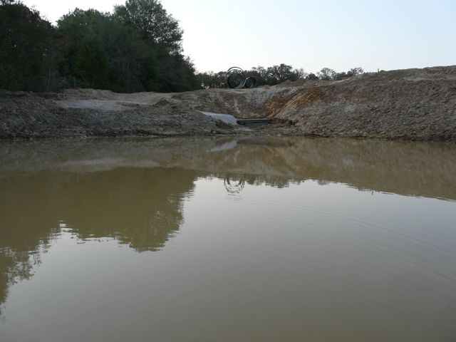

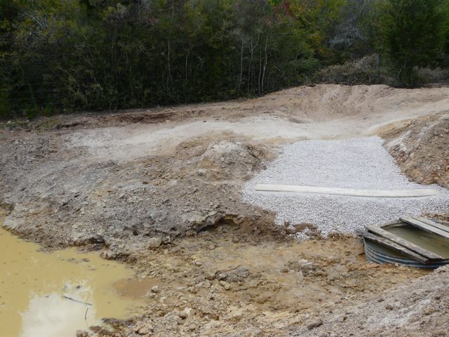

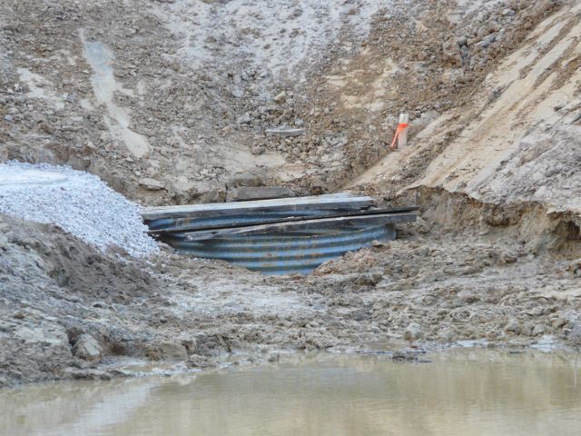

Pacerron, the water in the bucket of rock was perfectly clear after 3 hours and the PH changed slightly from 7.6 to 8 after 12 hours.
My additional stack of culverts is ready to go.
I'll take some pics when I put on the BH.
In the picture with the stake the orange ribbon is 6" above the level of the spill way (according to my laser level) and will be the height of the small (30"X6') culvert.
As you can tell the water is still rising at a good rate, I'm feeling a sense of urgency to complete this.:)
Monday will be pea gravel day and Tuesday will be installation day.
Any last minute advice is still welcomed.

Looks like your ready to dig. Where are you going to pile your spoil as you dig? Who knows, you might hit a big layer of water sand.
Can you tell from your water well log at the house what type of strata you may be getting into? It won't be horizontal but the layers may match and you know what has been cut through already.
Whoever bulldozed your pond shape and field water barrier wall did a good job.
Last minute advice: Big drinking water jug, tall barn boots, and have somebody up there while your digging the pit. The dog doesn't count.

Don, your rock looks fine to me for your purposes. That washed handful and the bucket show that it is not flat chips, but various sizes that will allow water to pass just fine. I don't think you'll have any problem with it packing and sealing.
The small pea gravel my well driller used was tiny because it had to fall down on the outside of the casing in the space between the hole wall and the PVC casing. Keeping small pea sized gravel ensured there were no dams forming and stopping the gravel from going all the way to the bottom. In your case, you'll have no worry with anything like that.
Edit: Don, isn't it odd in the middle of a drought to be talking about water rising too quickly?:confused2: You obviously have one heck of a good spring. Elevations considered, isn't the spring's elevation above the creek bed where we built the bridge?

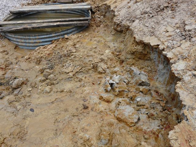

When they did soil testing on the hill for the house foundation they did hit a layer of coarse sand after the red clay. I just don't remember at what depth it was.
The spoils will go on the bank (to the left of the picture below) and I can take them further up after setting the culverts.
The cave-in shows the virgin soil red clay with streaks of water laden sand. It looks like two areas of springs in front of the culvert also.
The culvert filled with water last night. I'll dig a small hole on the down side to drain it before digging.
It's good to know that that rock will work.
Jim, the bridge in the back is a lower elevation but is on the up-side of the fault line. Looking at the attached map at Lee county, the Carrizo-Wilcox Aquifer outcropings follow the fault lines through Lee County right through the middle of our place.

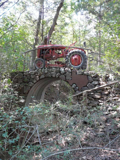

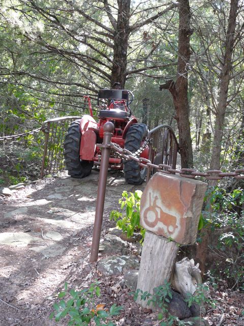

In 2004 A group of TBNers in Texas and one Okie got together near Dallas at Harvey's shop and built a bridge out of metal. We got to use a forge, wagon wheel maker, MIG, Cutting torch, stick welder, plasma cutter, metal benders, etc..... Whole families came out and we had a big BBQ. It was the best of times! Here is the 900+ post thread:
http://www.tractorbynet.com/forums/south/42887-norte-tejas-north-texas-project.html
After it was done we unbolted it and took it to Lee County to my creek. We had another big party as we attached the rock facing a couple of months later. That's when harvey got stuck and my cousin was called for the rescue to pull him out with his dozer. I remember it all every time I cross the bridge and see everyones TBN name on the Large Texas shape on the side of the bridge.
