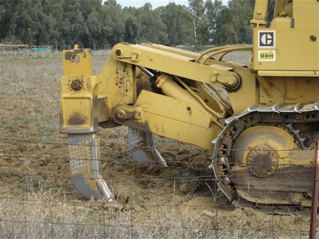

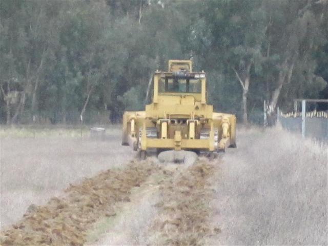

If you're serious about planting an orchard, you should dig a narrow trench 3 to 4 feet deep and check the sides of the trench to be sure you don't have a dense clay layer (hardpan) under the topsoil. If so, you'll have to use a subsoiler to break up the hardpan so the trees can get rooted properly and so water can get to the deep roots.
When my neighbor decided to put in about 8 acres of English walnut trees, he had to get this D8 Cat with dual 4-ft rippers to break up the hardpan before planting his orchard.
Good luck.

Thats a nice machine for subsoiling
Im not going for 8acres. Maybe 10-15 trees. Ill clear a space and then measure out for proper clearances (20-25ft circle). Good tip on the hardpan. Thanks.
