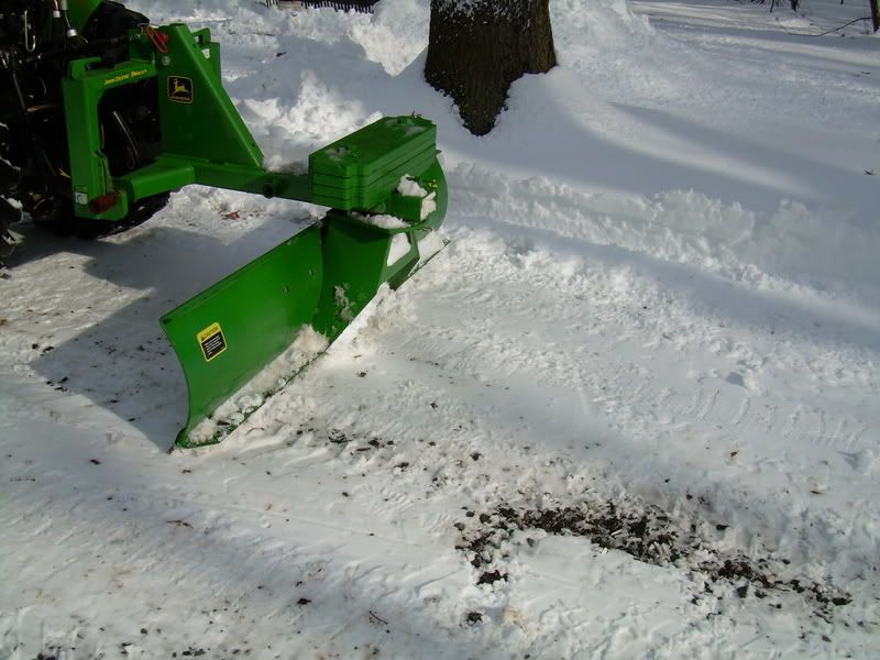

good pictures JB4310-I am one of thooes guys who has only used his rear blade going forwards.
After these posts I am inspired to try my 6 foot rear blade going in reverse but we haven't had any snow in a week now. It's suppose to climb to 5C on the weekend.:(

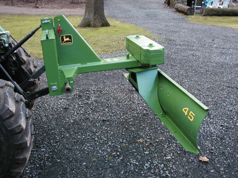

JB4310, I see you have a John Deere 45 blade on your 4310 with the imatch attachment. I have a 7' 45 blade on my current TC40DA New Holland which is being traded for a JD 4720 in two weeks. I ordered the Imatch with the tractor.
Did you have to do any modifications to the blade to make it Imatch compatable? It looks pretty slick on your 4310.
