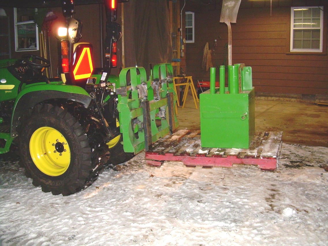

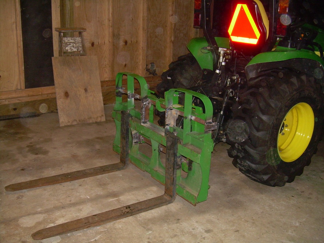

TCowner,
As long as the new tractor has the same cat 1, 3 pt hitch and the I-Match is the same model, then you will just have to drill the hole for the top J-hook of the I-Match on the plow (look at the prev pics) I think it's 3 inches lower than the original hole, but double check your self.
I'm lucky, so far I've been able to adapt all my implements to the I-Match-the ballast box which required no mods, an old off brand HD box scrapper which required a good deal of mod, a land pride rake that already had the lower hole drilled for the top J-hook, the plow with one hole mod, a set of front forks just done this past week (see attached pic) and my latest project a pto generator carrier that came this week unable to connect to the I-Match.
How many Horse power will your new tractor have? and is it a cat 1 3pt hitch?
