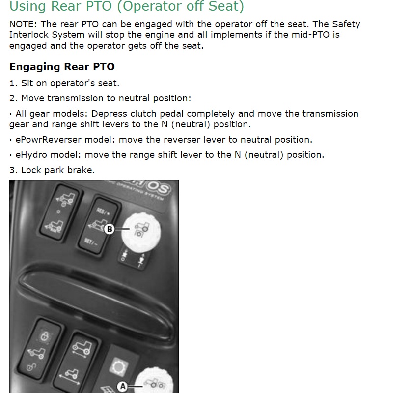

Loaned my wood chipper to a friend and we found out you can't get off the JD 4310 with the PTO engaged.
I won't say how we got around the problem that day but we would like to know how the people at John Deere expect you to run things like wood chippers, generators, and any number of other attachments?
There is a LOT more work for the chipper at his property and I won't be able to be there all the time.
/ Operating a 4310 PTO? #2

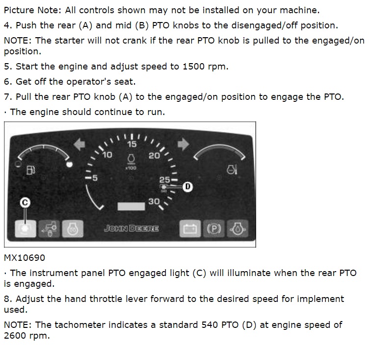

The heading "Using Rear PTO (Operator off Seat)" in the operators manual gives the procedure.
From the manual..in two attachments continuing. Hope this helps.

Thank you beenthere, we didn't have a manual but I figured there had to be a way.

Here is a link to the manual.
OMLVU13193_H2
