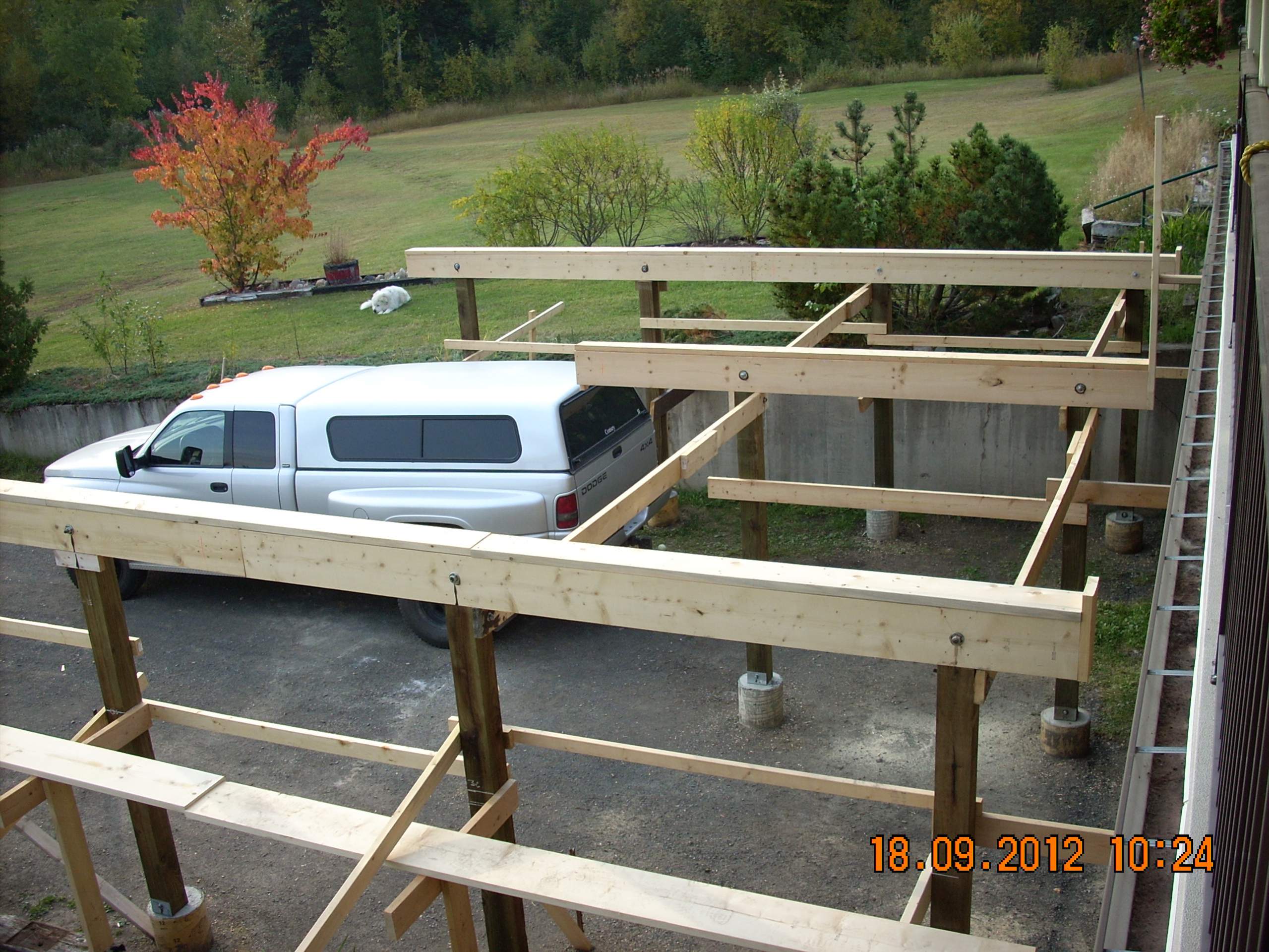

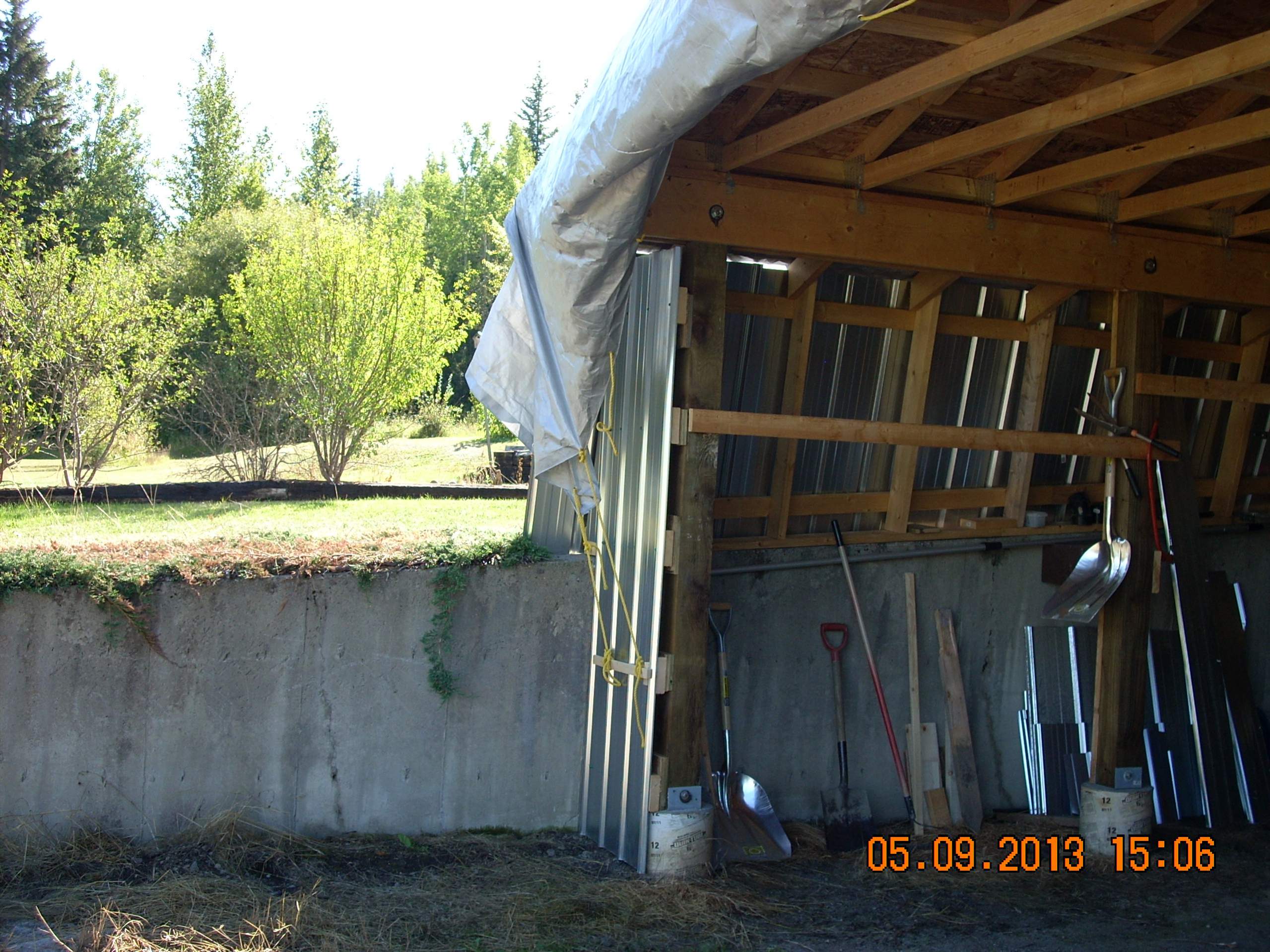

I bought a PHD to make holes for the carport post I built. I also added a 12" extension to the auger, which gave me a consistent 4'6" depth. Actually got a couple to around 5' deep. I also used the "sona" tubes and extended them above ground by about 16" (should have gone to 24" I now think). After all the work was done I sold the PHD, extn and auger for almost what I paid for it new - all bought on sale. I also put 3 pieces of 5/8" rebar down in the holes prior to filling with concrete. So far in three years they all look to be good (post footings).
