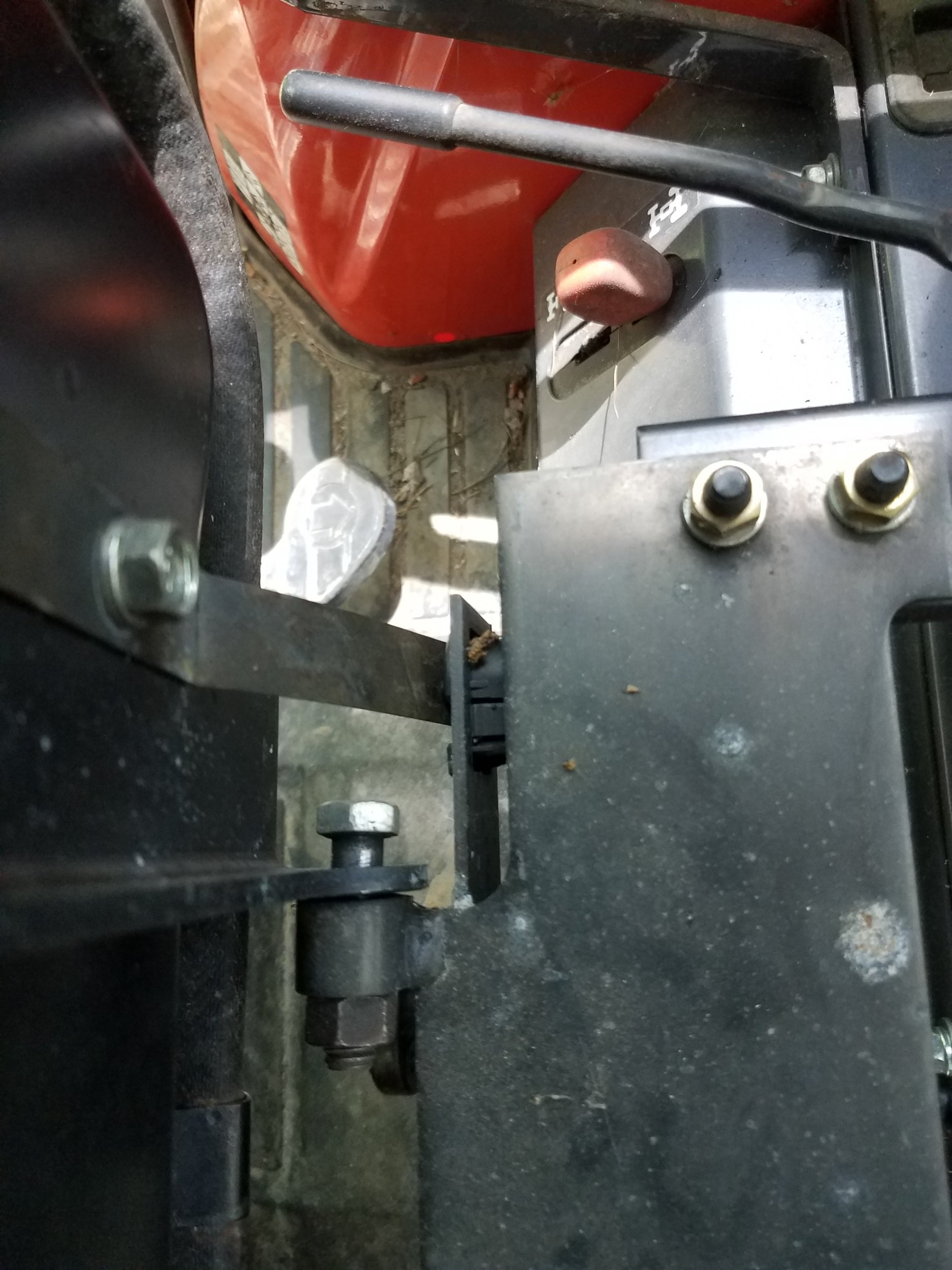

Yes Sir, you are correct that this is the way it's supposed to work. Unfortunately it doesn't - it kills the engine when I engage the PTO. I suspect that one of the sensor switches has a bad connection or is defective and needs replacement. The two seat sensors are easy to get to but the others aren't as convenient (not even sure where the hydro petal one is) and I've not had time to really check them out.
   / Operating PTO implement out of seat? #23
I had the same problem with mine until I realized that the lever that pushes in the sensor when you lift the seat wasn't depressing that button. I took off the lever bent it so that it applied more Force to the button, reattached it, works great now. Thanks for all the information!!
