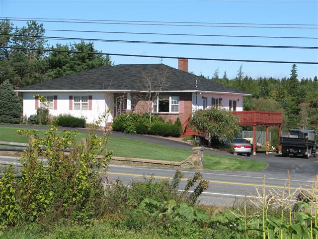

I had a similar situation happen to me a couple of years ago. I was unloading my cub tractor from the back of my one ton. If you look at the pic you can see the truck I was using as well as the yard. I backed up the incline till the back of the truck was at the red set of steps. After putting the body up a little and lowering the tail gate I set my ramps up and hooked to the inside of the tailgate. This looked like a good idea as there is a lot less angle on the tractor, being on a incline.Well I started backing up the tractor and just as the back tires started down the ramp I put my foot on the brake. When I hit the brake the weight of the tractor pushed/slid the ramps clear off the tailgate. The next thing I knew I was sitting looking at the sun and holding on to the steering wheel so not to fall off. The front tires were still on the truck and I figure inches more decline of the body and it would have been over. It happened so fast there would have been O chance of escape. By the way there is no rollbar or seatbelt on a 1954 cub /forums/images/graemlins/blush.gif The problem was I had not secured the ramps well enough to stop them from sliding. Only ever done that once /forums/images/graemlins/blush.gif
