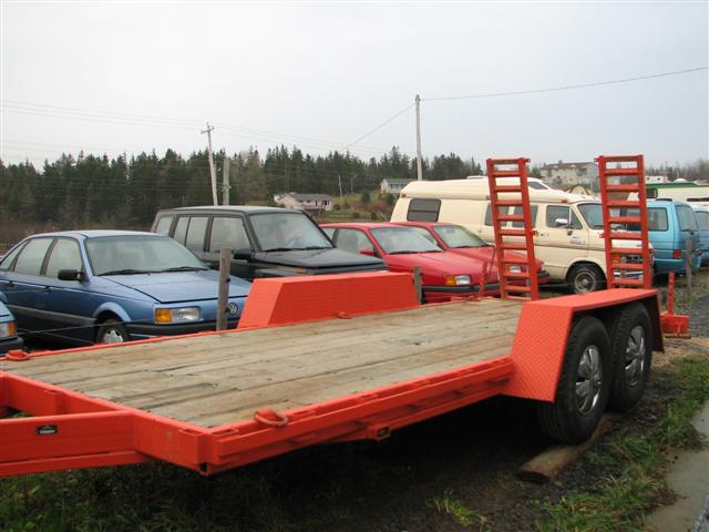

If you can see the square stock protruding up wards on both sides in the back of my trailer. It is 1 3/4"? square stock with holes every couple of inches. This fits into a piece of 2" square stock with one hole that is welded to the trailer. The 1 3/4 piece has a foot on the bottom approx 4x4 so as not to push into the ground. One of the benefits of this is you can adjust for uneven terrain while keeping the trailer level. I have many times loaded the excavator onto the trailer while it wasn't hooked to the truck and the legs easily held the weight. Simple, safe and permanently attached. Just remember to lift them up before taking off /forums/images/graemlins/blush.gif

I have used wood ramps in the past for light things like a riding mower, motorcycle or 4 wheeler under 800#. Now I use aluminum ramps for those items that are rated for 1500#. I'd never use wood ramps for a tractor or a car.
My previous trailer was a 16' dual axle beavertail w/ fold down ramps that I built myself. When I bought the tractor and first loaded it, the back end of my truck came off the ground (negative tongue weight). From then on I used jackstands under the back end of the trailer to prevent negative tongue weight. I'd set them about 2" below the back and the tractor would compress down to the stands and stop. Once the tractor was on and moved forward the back lifted enough to get the stands out.
My latest trailer is a 20' tilt bed. After tilting it up w/ the jack, the front axle of the trailer is actually off the ground. I posted a trailer pic back in Sept that shows this. I don't know how to link you to it though. Loading the tractor on a tilted bed does'nt seem to produce any negative tongue weight since the back end of the trailer is touching the ground. My only concern on a tilt bed is that if you are loading by yourself you hope that what you are loading has a park position or very good brakes to hold it in place on the tilted deck till you can get off to lower the deck down. It's best if there are two people, one to stay on the vehicle being loaded and a second to lower it down.
