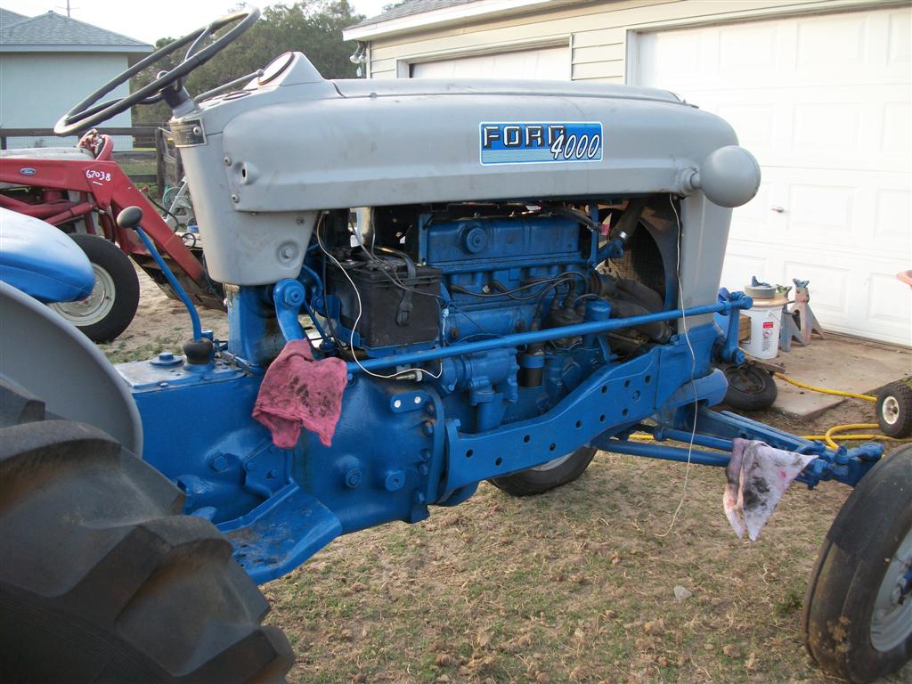

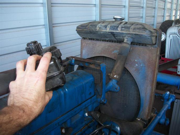

just came in..
got her all buttoned up.
tin back on, gas tank cleaned.. got new gas in her with a hefy dose of lubes..
warmed her with seafoam in the oil, drained crankcase, refilled with walmart synthetic oil.
started up, running great at all rpms.
still have a few wires to fix and am still running on the temp fule line (half rubber / half metal.. metal for the manifold side.. rubber for an inline shtut off for testing. )
other than that she drove up to the shop under her own power.. she had been broken down in the equipment barn .. etc.

Ok, it's been a week now and here's what I have to report.
She starts better than ever. no choke needed. I doubt the new synthetic oil has anything to do with this.. but rather perhaps cleaning up the valves, adjusting the valves and perhaps the head gasket... etc.
good oil pressure, perhaps 5 psi more than normal .. now THAT is likely the new oil talking.. :)
purrs like a kitten.. have used her to move a few things, back drag the pasture, etc.., blade the road and some lifting..
soundguy
