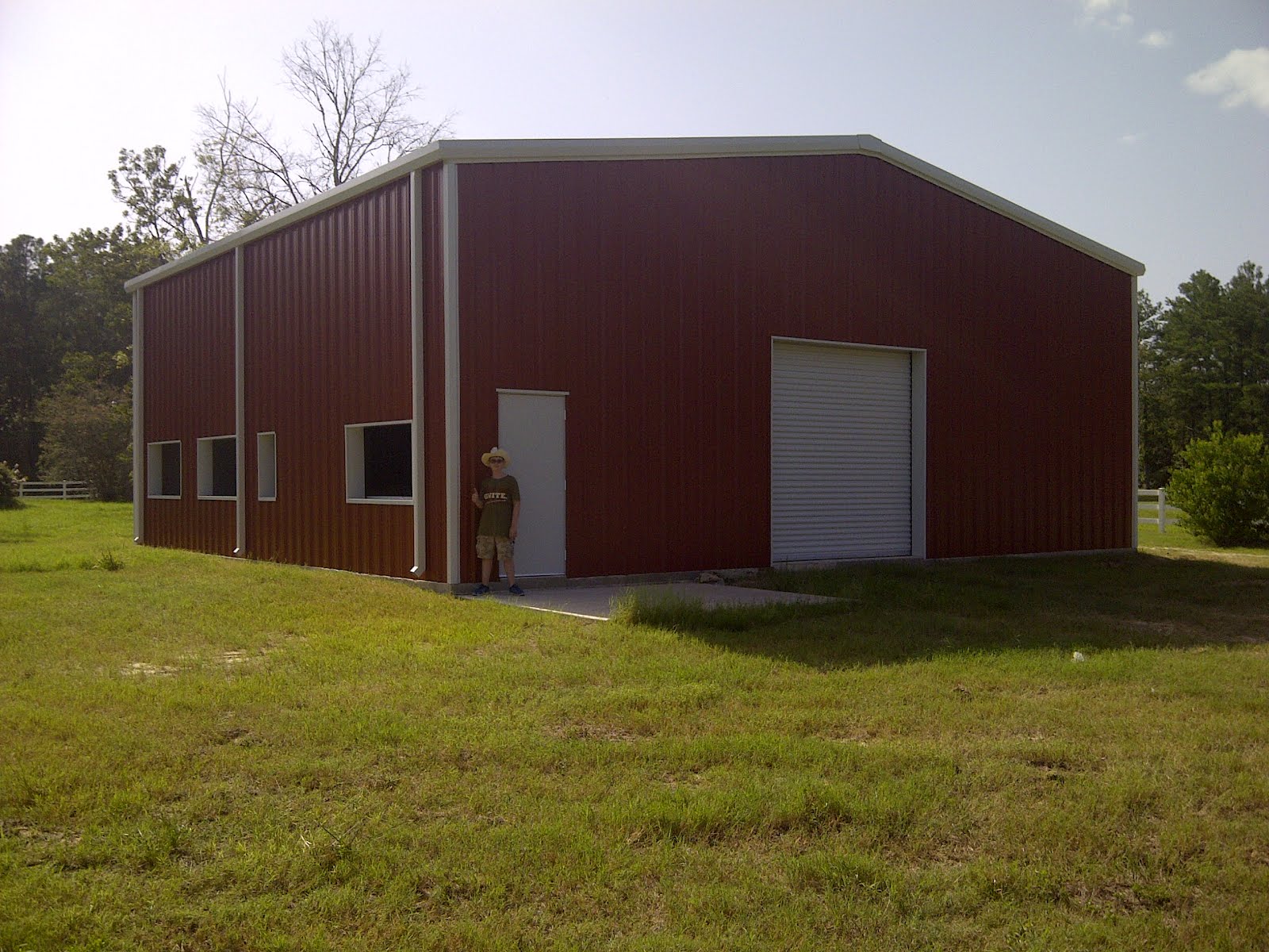

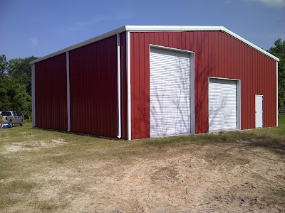

I'm not really clear on your doors. when you say 14' do you mean tall or wide? It sounds like you plan the left hand bay (not a pull thru) as your RV bay. If you have a trailer type RV a pull thru is a lot more convienient than having to back into the bay. Also keep in mind that some RVs are over 12' tall (I think, but do not know, that the max allowed height is 14' due to road bridges.)
   / Opinion please: Insulate Metal Building in South Texas or not?
#12
left door is 10 feet wide and 14 feet tall, middle bay has two 10 feet wide and 10 feet high doors.

I have a 40x40x17. Two 14' roll-ups (not insulated). Had it built last year.
I put 6 inch on the top (my roof is the galvanized), and 3 inch on the walls. Makes a HUGE difference. My weather is similar to yours. Gets as hot as 110F here. We had 31 days in a row over 100F last year. You can't even touch the walls on the outside of the building they get so hot. But inside will be 25 to 30 degrees cooler. Now by 5pm it will get pretty warm inside. Mainly because the doors aren't insulated. But it is at least manageable inside. In the mornings, it will make your nipples hard it gets so cold.
The roof dormers were a good idea as well. I did two, 14 footers. And I roll up both doors about 2 feet, and run a fan in each door, one blowing in, one blowing out. Makes a great breeze inside.
I am wondering, why would you do any 10 foot doors? Why not go 14? extra cost is minimal, and the doors will be more useful, especially if you sell your place sometime in the future.

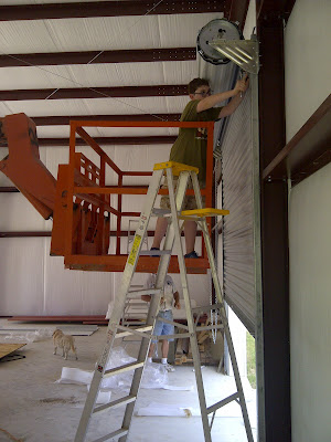

The insulation helps a lot. Its been 100+ today here in Houston and inside the building we had nice breeze and did not feel hot at all.
We finished the doors today! This thing went up in 3 days and then I took over with the doors.
Here is a shot at my son tightening up the stopper. In the back ground you can see the insulation. Its the typical white plastic lined 3". The roof and the walls are cold to the touch.
Nothing better than looking back at a great day spend with my son and got something accomplished!
