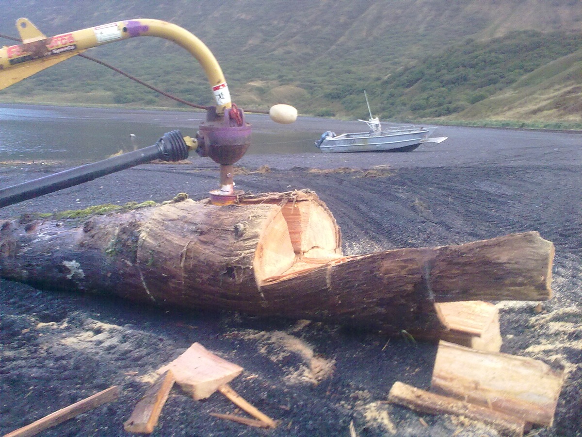

I put mine on a post hole digger and split whole logs not just the rounds then just lift the log up and buck off already split pieces. Depending on the log size I usually get 6 or so feet from the end and split. After you cut the other side of the auger it drops off, u turn the log a quarter turn then auger in again and that way you split it into quarters or more if it is a big one. Welded a handle to the PHD so I can put it exactly where I want it from the seat. Wouldnt want anyone next to it as I was splitting, usually the logs are too big to spin but the smaller ones will spin til the tire stops it. I love my setup and would not want to go back to a regular splitter or ouch a maul!

That's interesting, operated from the relative safe distance of the tractor seat.
is there any chance the log could be spun if the screw bound some how?
You could also set up a bunch of rounds and just drive up to them and split them. unless they would spin and not split??
JB.

I am probably going to get a screw type for my Hydraulic Post Hole. I won't be near it so I am a lot more comfortable with the concept.
Question for those who have this device... Does it bind up ever? If so, how do you extract the screw?
And have you ever split a stump with it?
   / Opinions of a Screw Type log splitter #48
Never bound up yet. Atom design adds a flared cone to the back of the screw. I think it should prevent it binding up in all but the worst case. I guess if it does get stuck you're going to have to shut the thing down, get off the tractor and use an axe or crobar to get the stubborn log off the screw.
Haven't tried a stump.

With your hydraulic setup you could just reverse it. And no it has never bound up on me and we have no stumps here so havent tried it
Rick
