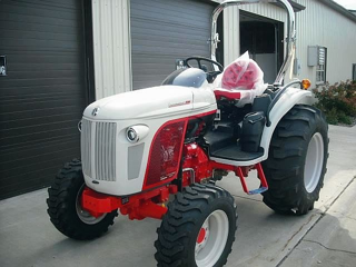

I found that I have a New Holland dealer near me. Does anyone have experience with the Boomer 8N? I love the retro styling.

The new 8n looks great. But for way less money you can get a 3050 and still have all the features. Same HP too.
