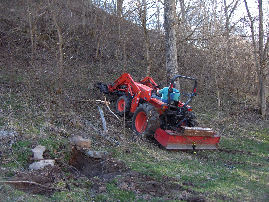

I dont know the weight of these rocks but the largest was all that I would want to handle with this sized tractor(Kubota L4400HST). Notice I have a
7 foot Box Blade(600#) on the rear and the optional weight box(500#) adds about 1100# to the rear and it needs it.

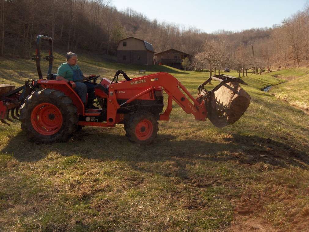

I could only get 4 pics to the post so is another pic. The Grapple is a
Anbo GRL 66" with 6" spacing between the tines. The grapple weighs Less than 400#.
