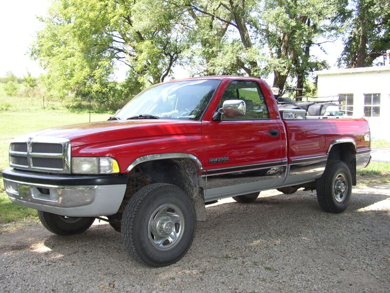

I never considered myself a Dodge guy, had GM and Fords before getting this one. That was 10 years ago. I did buy mine for longevity, mileage, and just because I needed a truck. Several others have said that the engine will outlast the body, and I know that to be true, but I can't imagine driving anything else now.
I've replaced the starter once and the lift pump. Other than that in 10 years it's just been regular maintenance stuff. Can't complain. Brother has driven Ford diesels (notice plural) for years, dad has had both Ford and Chevy diesels, neither can compare with mine for reliability, mileage, or just down and dirty outright grunt. :) Oh and one other thing, NO GLOW PLUGS! That right there in my opinion makes it a superior engine. Have not once had a fail to start in the cold.
