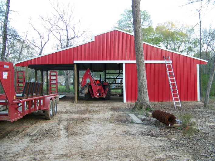

I'm using Mueller. Go 26 guage on the roof. I'm just down the road from them also.
hugs, Brandi
