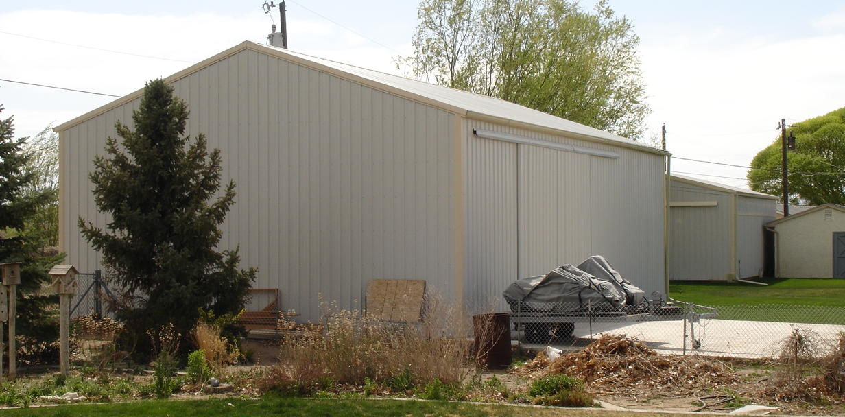

I can understand the advantages of metal buildings over wood frame with their low maintenance and all, and wouldn't mind one in my backyard. I just wish my neighbor had put up lower profile buildings in his backyard. To me, they give the neighborhood that commercial park look. He only has classic cars and other stuff that doesn't need the hieght. Maybe he got a good deal on them, I don't know. He told me a couple years ago he paid about $9.5K for one and $11K for the other, same size but different brands. Theyu were built about a year apart. I believe the price included putting them up too, and it didn't take long with the crews that came out.

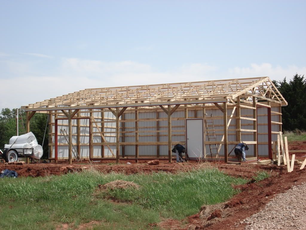

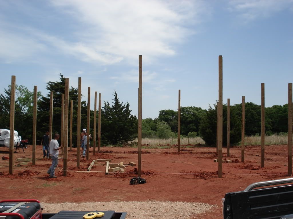

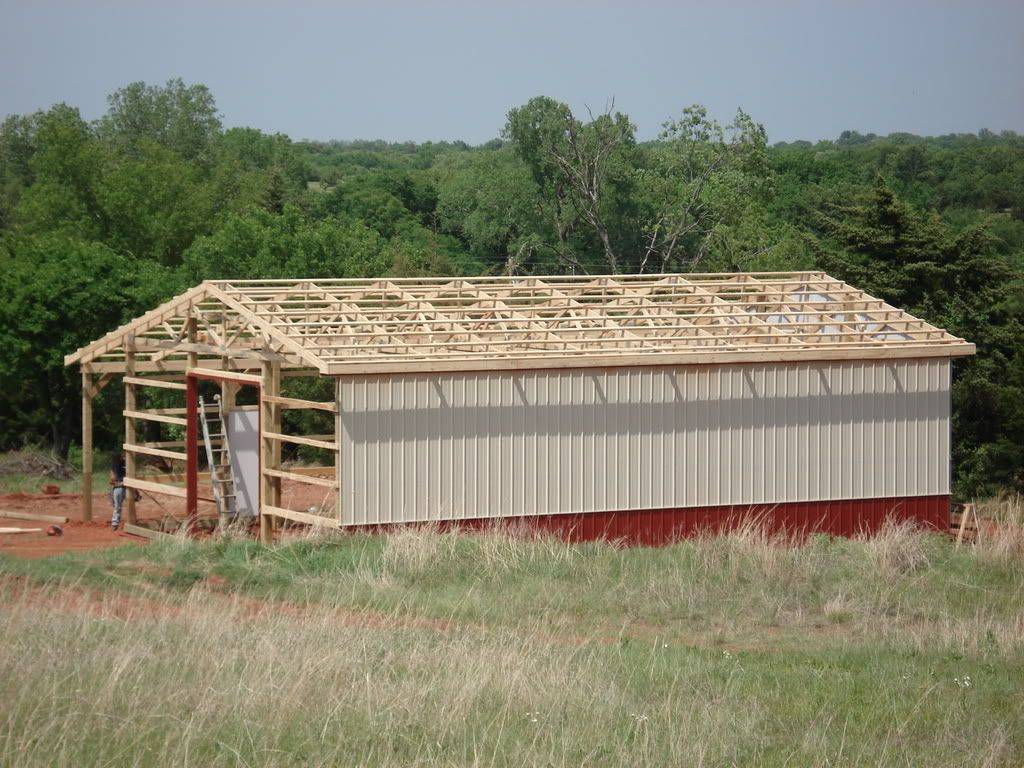

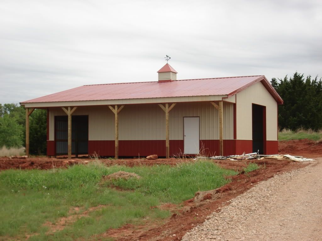

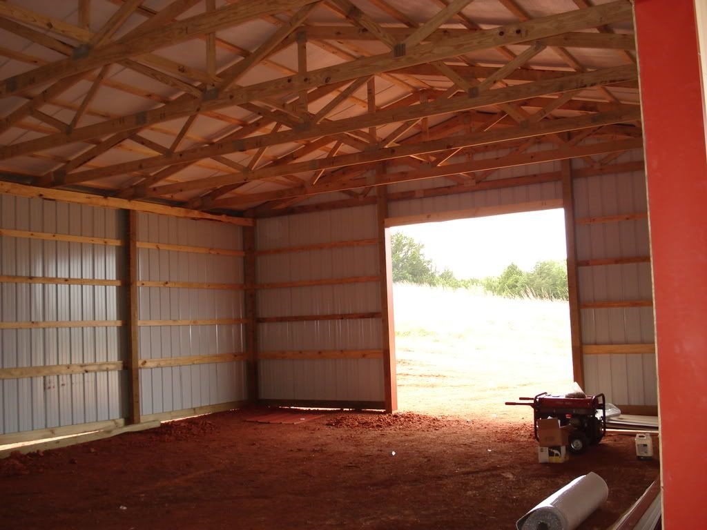

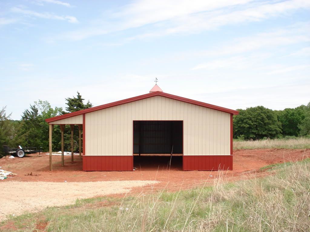

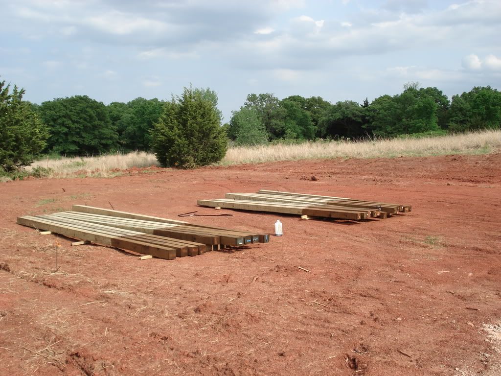

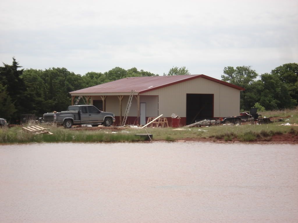

Here are some pictures of my barn minus the doors. It took a crew of 4, 2.5 days to complete. I am happy with the quality of materials and the quality of workmanship. If and when I need to build another, I will definitely give them a call. The plan is to install roll-up type doors. Hindsight, slider doors might have been ok, but I liked the looks and security of the roll-up doors.
   / Opinions on Steel Buildings #40
Beautiful!!
