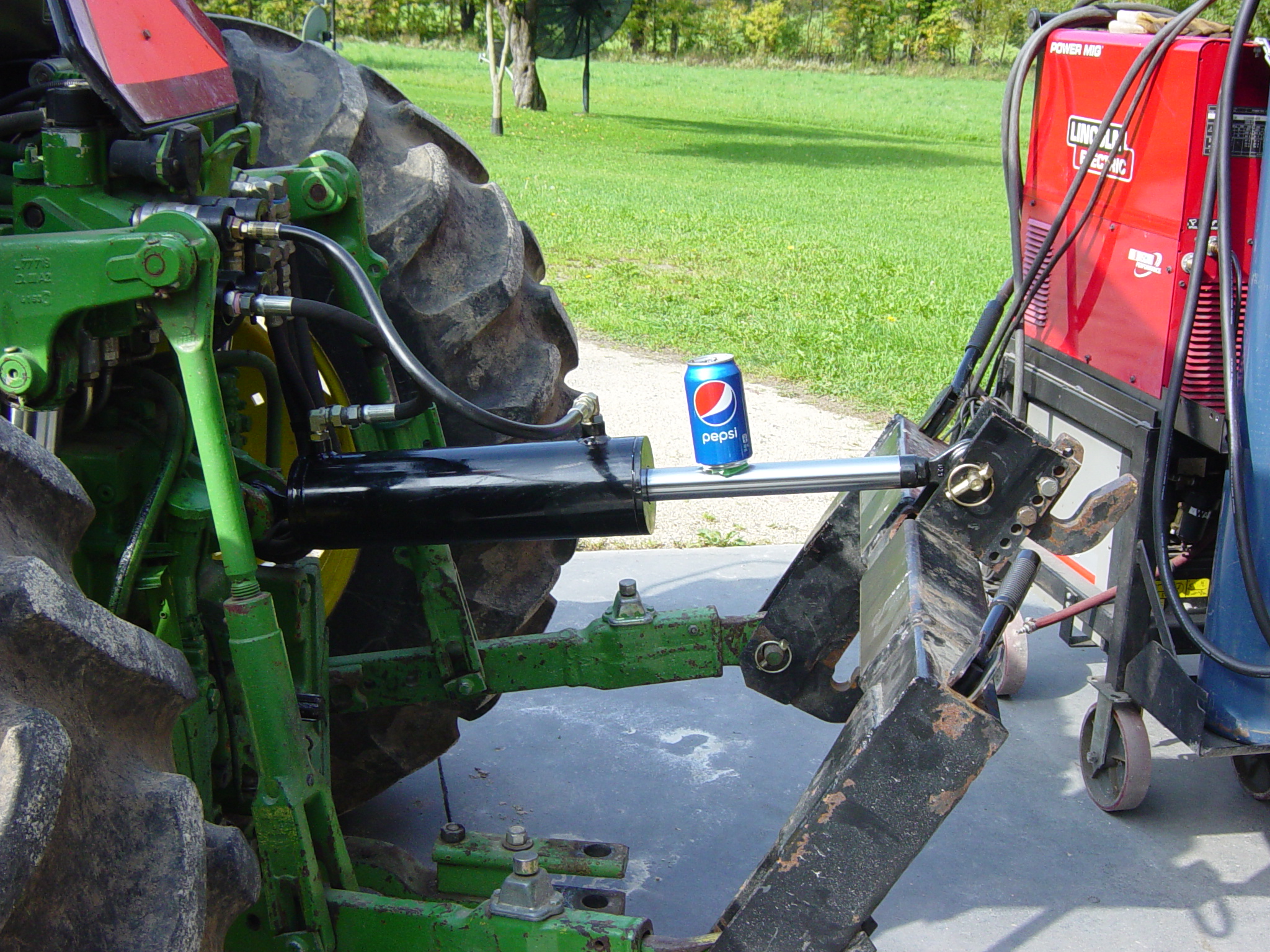

I also had Pat's system and really liked it. I agree with BufordBoone's pointers. The only reason I am not still using Pat's is that I got the hydraulic top link. Obviously, the hydraulic top link has to be adjusted differently for different attachments. I couldn't find a good way to preset the length of the top link and found myself having to stand between the tractor and the implement with the tractor running so I could operate the control lever for the top link. I didn't like that, and for sure didn't like family members doing it, so I went to the quick hitch.

Is your TnT system one that does not permit you to adjust the toplink from the driver's seat. A TnT is in my future, very probably a Fit Rite, but I should be able to control the link from the operator's seat. It sounds like this won't be a problem for me, but I want to make sure I'm not misunderstanding something. One of the reasons the whole project is bewildering to me is that I don't have all the attachments and/or mods done to the tractor. I'm trying to think ahead, but it's hard to anticipate all the different possible contexts for which I'll need to account.
   / Opinions sought on best all-around quick hitch #15
I can adjust the TnT system from the seat. On the MX the controls for the hydraulic outlets on the rear are to the right of the seat. The problem (for me) is that if I am in the seat, I couldn't hold the top link in line with (vertically and horizontally) the top of the 3PH on the attachment while I shortened or lengthened the top link to match with the top of the 3PH on the implement. A TbN poster described a rig he uses to suspend the implement end of the top link with a rope so he could raise and lower that end while sitting in the seat and operating the top link control lever. that poster used his rig to maneuver the position of the end of the top link on the attachment side. I couldn't get that approach to work well. I also tried maneuvering the controls with a length of PVC pipe with an elbow on the end, so I wouldn't have to stand directly in between the attachment and the tractor (another idea from a TbN poster). I also tried measuring the length of the top link for each attachment when it was hooked up. That thought was to adjust the top link to the proper length for the specific attachment before I tried to hook up. That usually worked or came close but I still had to make small adjustments. Part of my agenda is to make using the tractor as easy and safe as possible for family members. Hence the migration to the quick hitch.
I have the same "issue" with adjusting my hydraulic toplink. I use the one toplink on both tractors. On the L5740, I can easily reach the lever from the side of the tractor. On the M7060, I have to stand on the step if I want to watch the toplink move. It is pretty easy to watch the Toplink hole and get it lined up. May take a couple of tweaks on teh lever but no big deal.
A couple of my implements are not QH compatible so the Pat's have been my best answer.
Everything is a compromise. Either Pat's or a QH are WAY better than nothing. I used to postpone changing implements. Now I think nothing of it. Simply not a big deal anymore.
