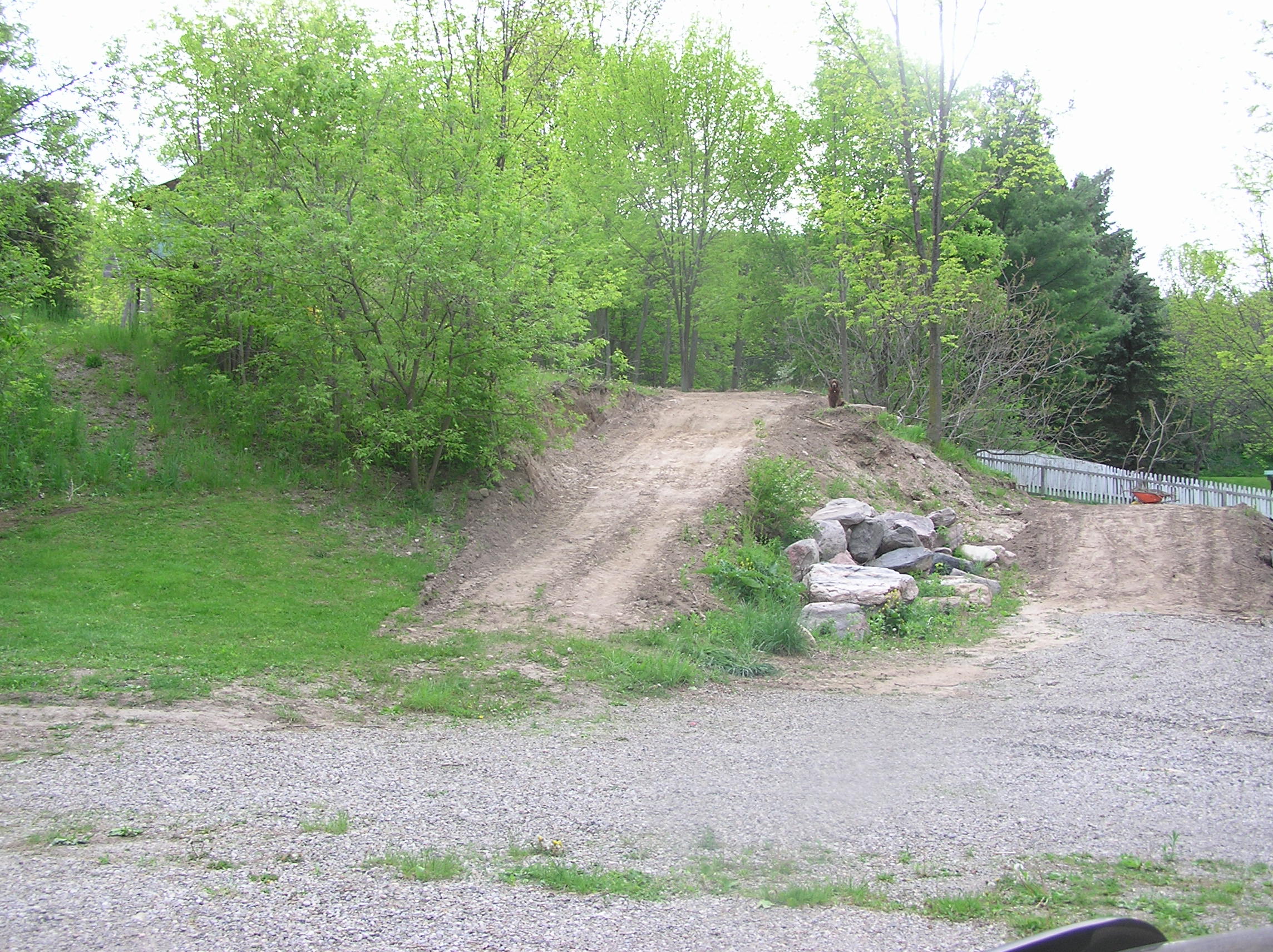

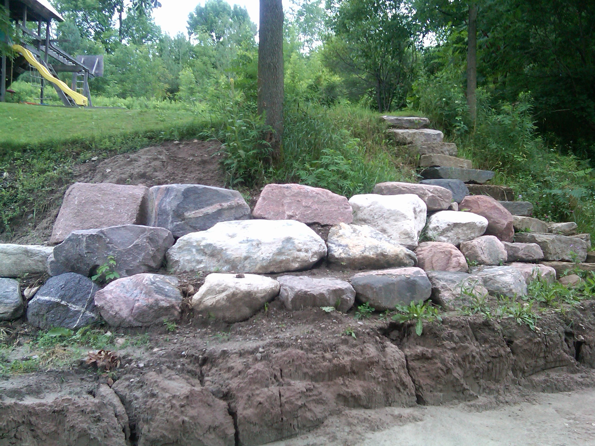

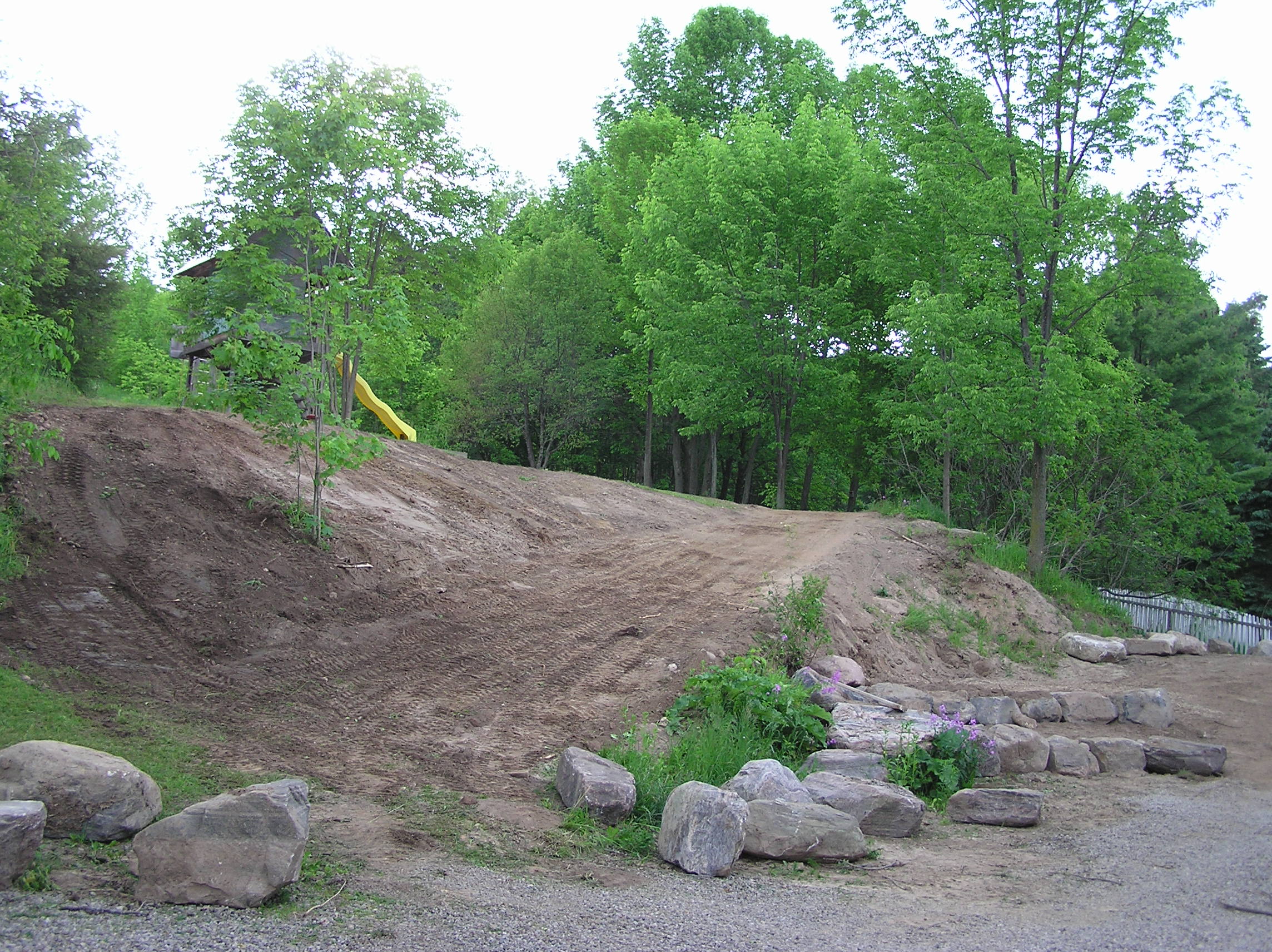

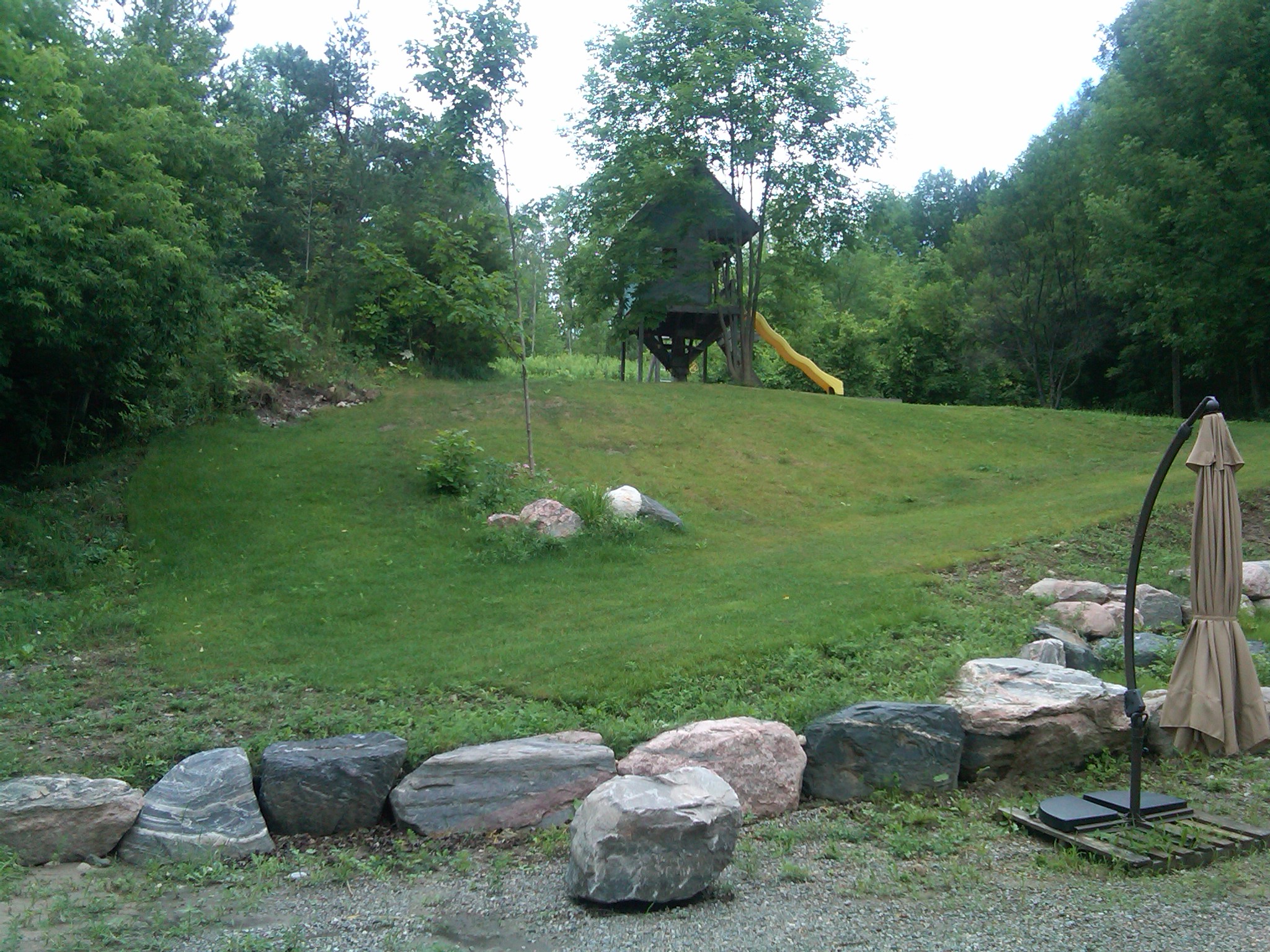

I have given away more limestone boulders than I can count over the last few years - to me it just looks like concrete when you landscape with it. I grew up in North Bay and my father in law still has property there with many granite ledges, outcroppings and boulders. If you are interested I have attached a few photos of the regrading and granite boulder retaining wall I have been constructing over the last couple of years in my spare time. I just love the variety of colour that you get with granite.
I have wished many times for the added power of an L39/L45 sized machine as many of these boulders are at or above the capacity of my old B21 and even the new B26. The upside is that the B26 gives me the manouverability I need on my small property.

lansman, nice job with the granite retaining wall...working with a backhoe sure beats doing it by hand! I like how you positioned the rocks so they "knit" together, natural looking but with "structural integrity"... I bet you had to flip them back and forth and constantly rotate them to get the right "feel", I remember that well.....
and never apologize for the size of your equipment, it's what you can do with it that matters:laughing: and I think you've shown us:thumbsup:

Thanks Doelake - I have been on vacation for a couple of weeks hence the delayed reply.
Moving the rocks with a backhoe is definitely a lot nicer than pulling and pushing with a tractor and or come-a-long. This is another type of job where I found having multiple buckets handy. I found picking up the rocks with the 24" bucket made them a little more stable when trying to position them (unfortunately I don't have the thumb yet!) but then sometimes you get it almost in place but need to remove some additional dirt around it to get it in it's final position. This is when I love the Quick Attach hoes as I can drop the 24" and throw the 12" on in less than 5 minutes and get rid of some additional material.
It sounds like you too have experience with positioning rocks. It can take half a day just to get five or six of them positioned so they fit together nicely. I had accumulated a total of about 70 tons of granite boulders over a four year period for this project and you could spend a lot of time just finding the correct rock to fit in next. I hope to finally complete it this summer with the balance of the rocks and then my wife will take charge and get the plants started.
