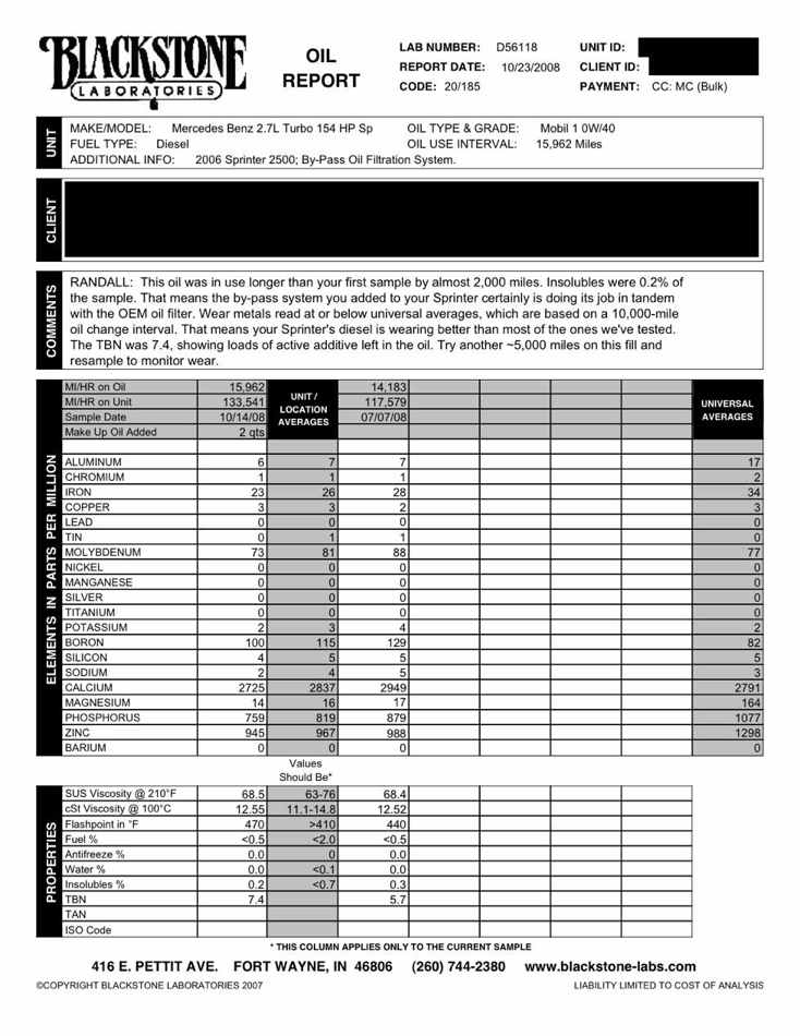

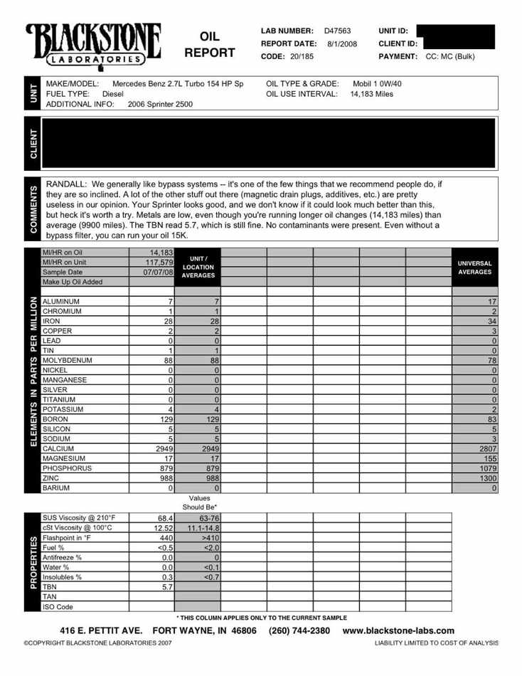

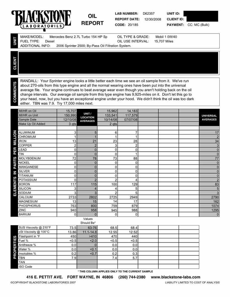

Here's the deal - there are a variety of attributes in an add package that play into how a motor oil will perform. Dispersants are one of them - but they ain't the only one.
I can tell ya this tho' - I've seen UOA's from a friend's (newer) Sprinter that must use the newer oil specs due to the presence of emissions equipment (EGR/DPF) .... at 10K miles his oil is toast .... done .... fini .... game over ...
..... while I'm at 14 to 18K miles using the older CF-rated M1 0w40 .... and Blackstone is telling me I'm good to go for at least a few thousand more.
As to whether the oil I'm using is doing it's job, consider this: I currently have 345K+ miles on the clock with this oil - figuring a 50 mph average speed, that equates to around 6900 hours of operation using this oil.
In reality, it's considerably higher than that - because I idle the truck quite a bit, particularly in the summer (recharging a house battery bank and trying to stay cool while living inside a tin can, in triple digit temps) - and that never shows up on the clock.
Have a look at the comments section on the attached UOA's with regards to apparent condition of the engine - the oil is clearly doing it's job - and doing it well.

Running a bypass filter set up makes all the difference,happen to have one with out it listing soot levels and wear metals? for the same type intervals?
and it's still going to be application dependent a little 2.7 MB engine is allot easer on any oil then say a highway truck or off road heavy equipment engine, sure as heck wouldn't put that oil in our 600hp C18's or our 550 hp N14,ISX Cummings.
