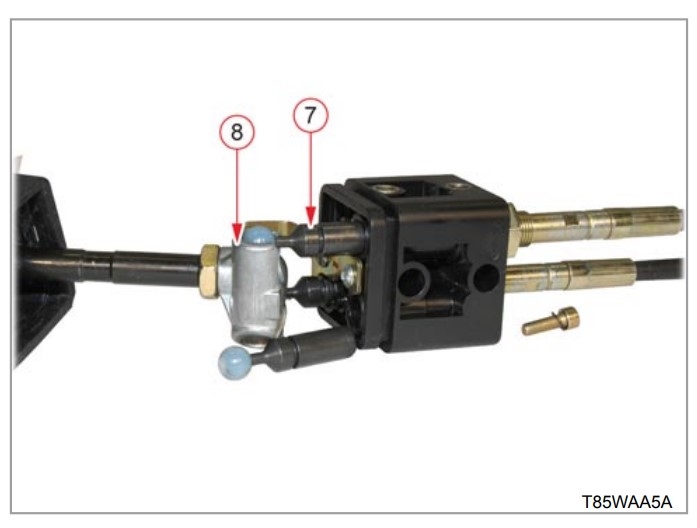

The Joy stick shaft needs to be replace with a new hollow one that accommodates the wire for the new joystick knob. One word of caution .. The original joy stick shaft was threaded on (by the factory) using "Red" Loctite thread lock. It took two guys with big wrenches to finally break free the threads. Use caution as it would be very easy to damage the pin socket made out of cast material (see #8 item in image).

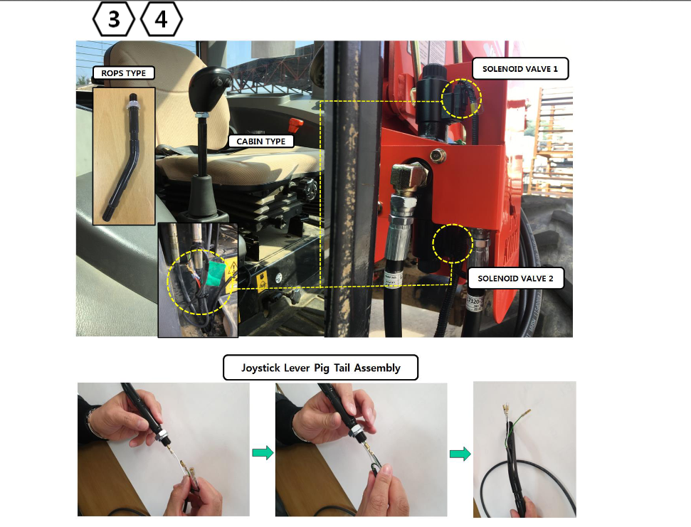

Also the installation instructions provided in the Kioti OEM kit (RXA-111) are not very verbose .. using images to tell the story. The images were printed as a black and white images and hard to interpret. I called up the supplier and asked to send be color photos so they could be viewed with better detail (he pulled them from the Kioti Dealer-only access website). I've attached them here as well (if you decide to install yourself). Hope this helps other owners.

Yes it would be good to see multiple pictures or even video of where the lines connect to and how it functions with the joystick etc. The WR Long pics in zip file only go so far.

I got mine installed and it was mostly painless. The hardest part was taking off the old joystick from the lever assembly. That nut and stick both had red Loctite. I feared breaking the cast metal lever assembly but it worked out.
Yup ... same issue I had with the red Loctite ... it was a PITA!

How did you end up pathing the wires going to the 3rd Function solenoid/valves?
As you know, the install instructions are poor in that regard.
I am also ordering hard lines (in lieu of the rubber soft lines that the kit offers) that go from the 3rd Function valve to the front end of the loader where the hydraulics' terminate as I am looking for a "cleaner" install (wasn't bad only ~ $130.00 xtra for the hard lines and clamps)
