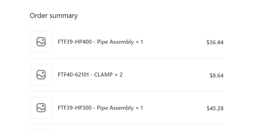

I will have to take some pictures of the wiring. Right now its still a bit loose. I had some difficulty threading the wires through the stick. I had to remove the rubber covering on the black wire to get it through. So I put some heat shrink tubing on the connections but haven't sealed it yet. Waiting to figure out the best routing of the wires behind the seat and near the stick.
Where did you get the hard lines and is there a set part number/kit?
   / Options for 3rd Function on RX7320 #32
I went to Tractor Brothers (Tractor Brothers) aka (Mahindra Tractor Parts) .
They have always been super helpful and are a very large Kioti parts supplier despite what the name implies :). Of course you can also go to your local Kioti dealer. Additionally you can have your local hydraulic shop fab some up. I wanted to stay consistent with the bend angles so I opted to go with the OEM parts. I just cut them a bit shorter to avoid the other connectors for the loader bucket. Probably paid a bit more but it really wasn't that much more. Shipping for me was reasonable.
Also I was able to get the wires threaded thru OK as I just staggered the 3 bullet connectors as I threaded thru them thru the tube. (but I know what your mean)
