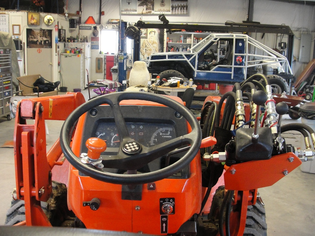

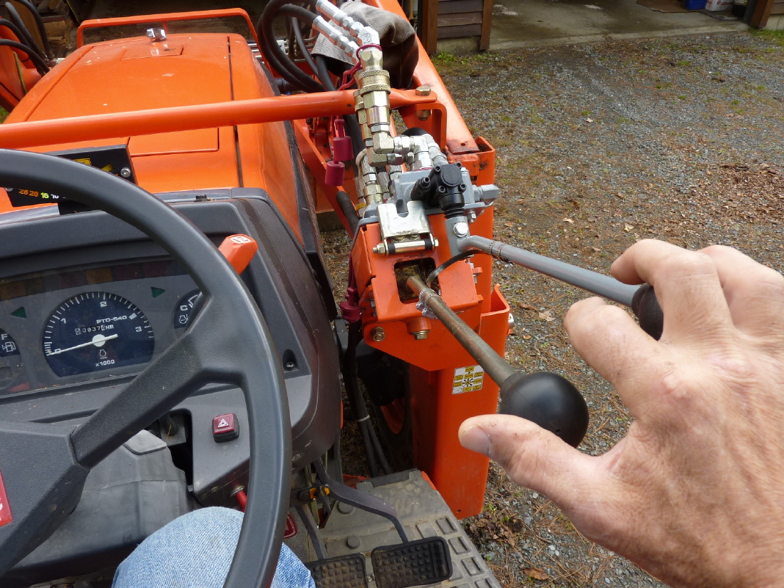

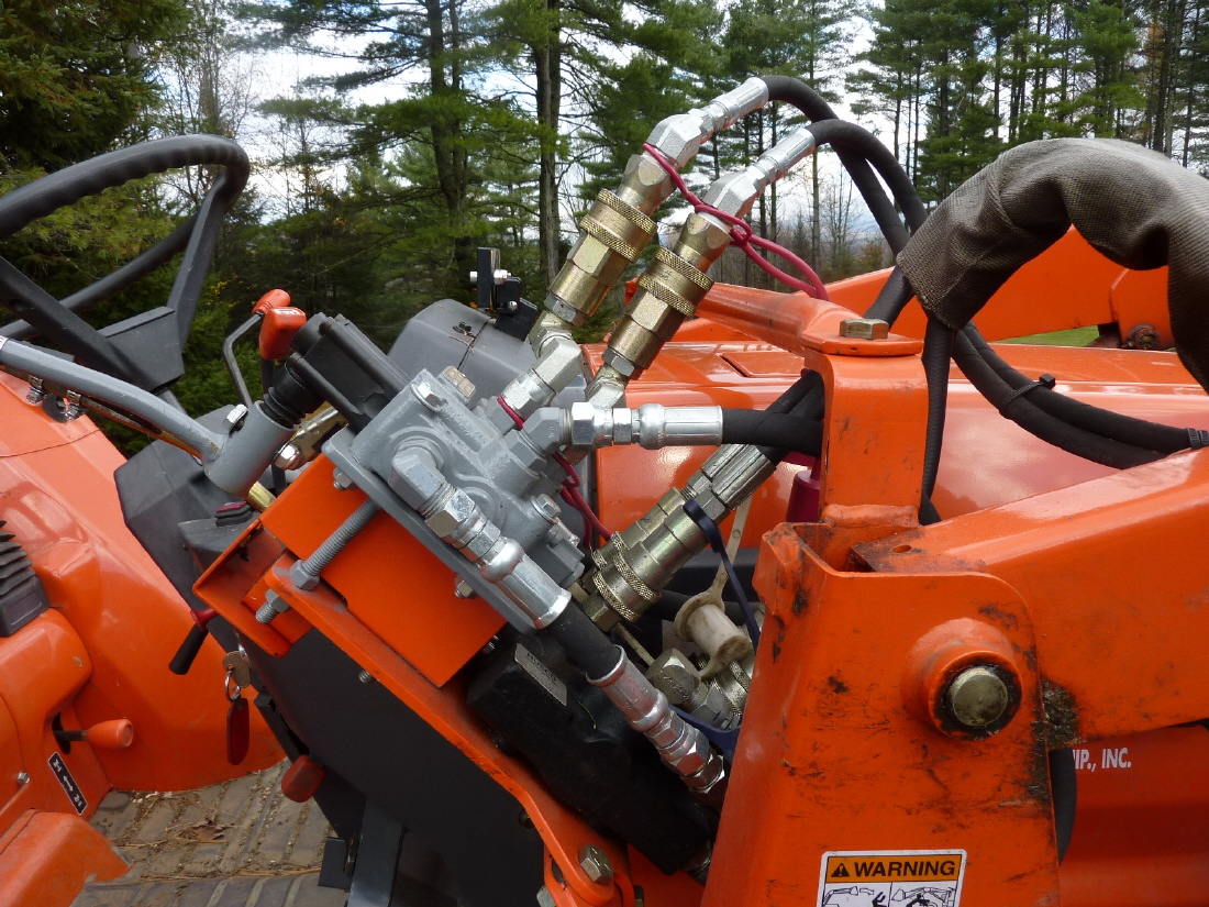

I added a manual control valve mounted above my FEL valve. Cost me $300. Not as convenient as a button on the FEL knob but close. Before that I used a rear remote but then wanted that for a Top-n-Tilt.
gg
   / Options for Hydraulic Grapple Operation (Yes Again) #6
I have the OEM 3rd fxn (made by LandPride) on mine. It is great. Dealer installed mine for, I think, $1250 at the time of tractor purchase.
If I knew then what I know now, I would buy the OEM kit and install it myself. If you do that, I can take pictures to help you do it.
IMO Gordon has done the next best thing.

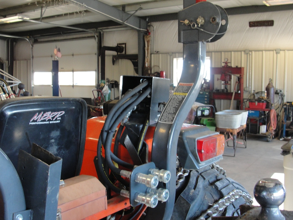

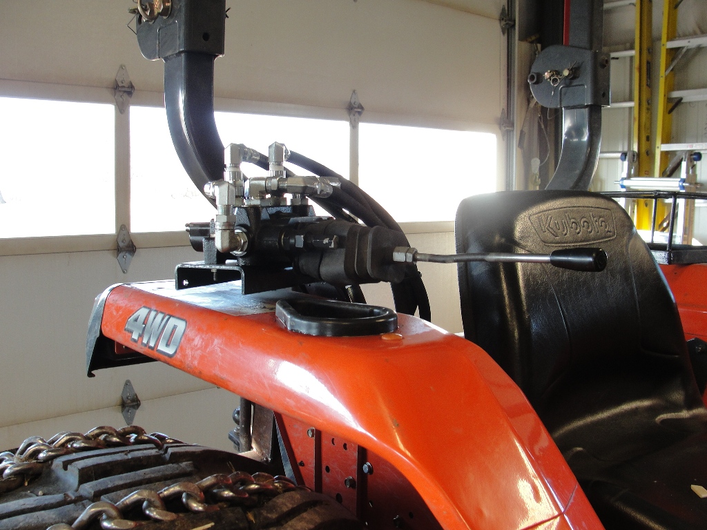

While I really like Gordon's solution, and have done that myself on my previous L4400, with a slight twist, it still falls short of a 3rd function switch on the joystick.
I purchased a valve that had a joystick function and an auxiliary valve in the same block. Then I moved my previous FEL joystick to the fender and turned it into a dual rear remote valve. Not nearly as hard as it is to describe.... :)
   / Options for Hydraulic Grapple Operation (Yes Again) #8
I like the way you did that Richard. Makes the plumbing much simpler (actually eliminates most of it) with the two block valve and then recycle the old FEL valve for a pair of rear remotes - clever !!
