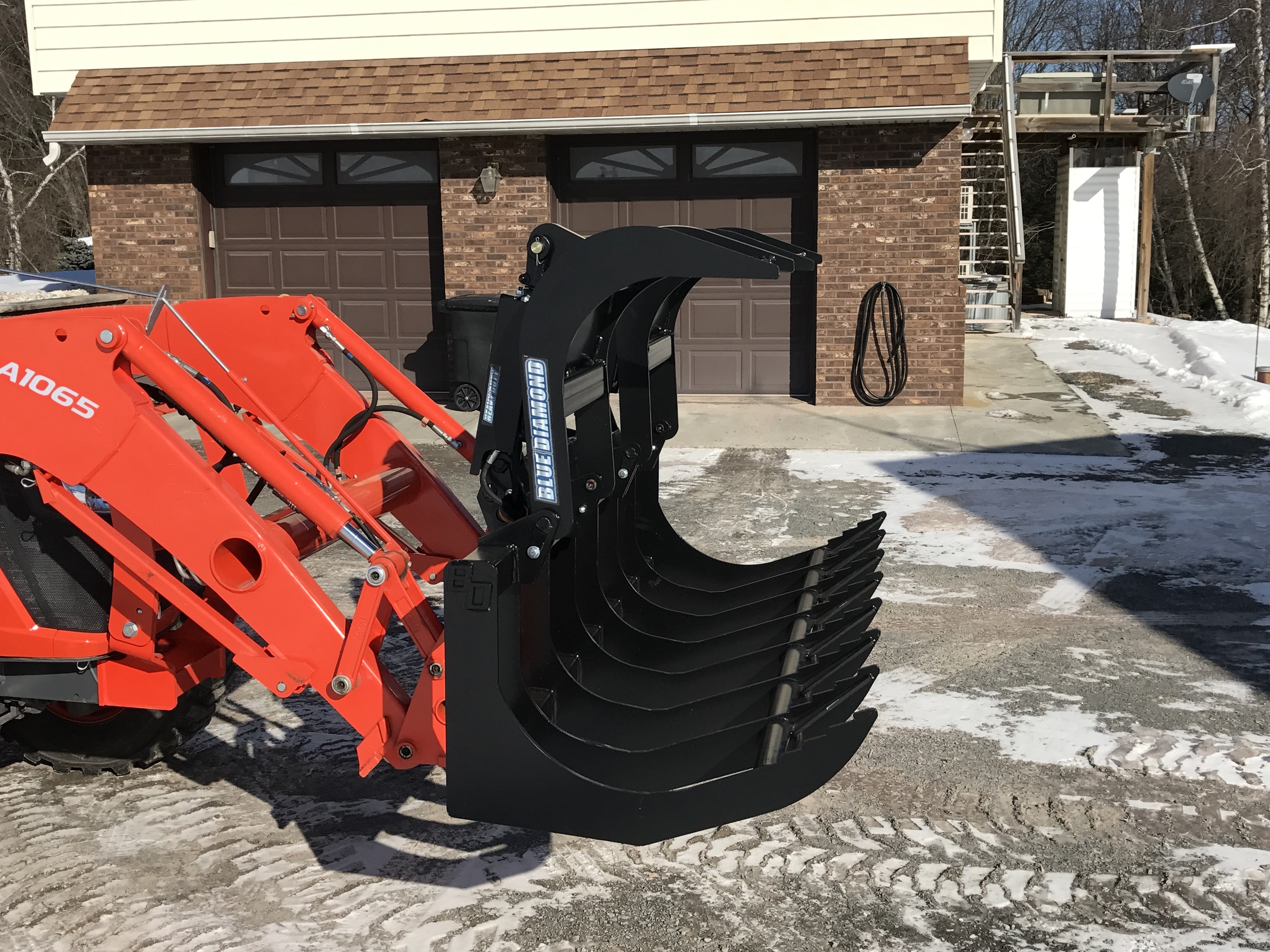

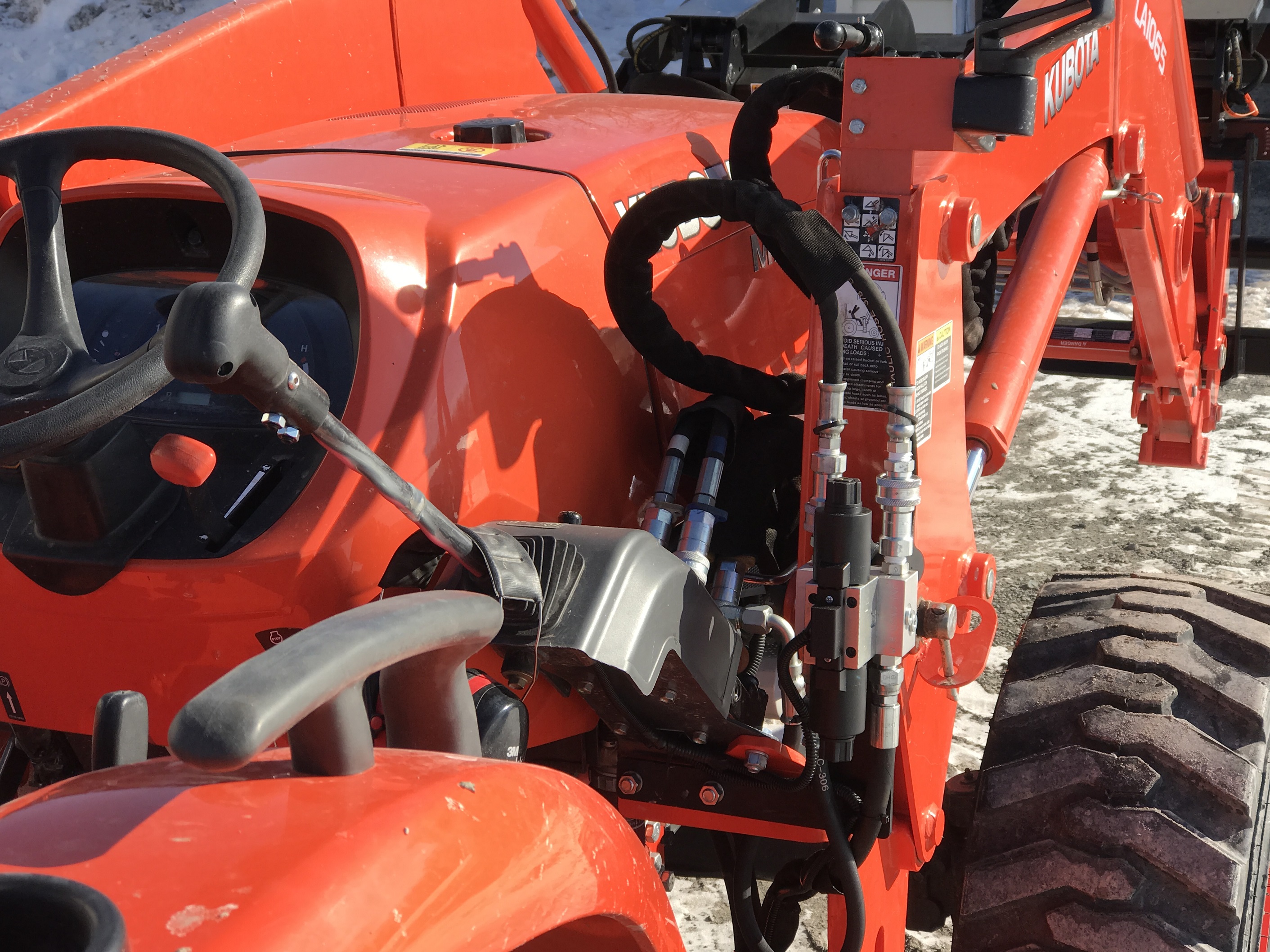

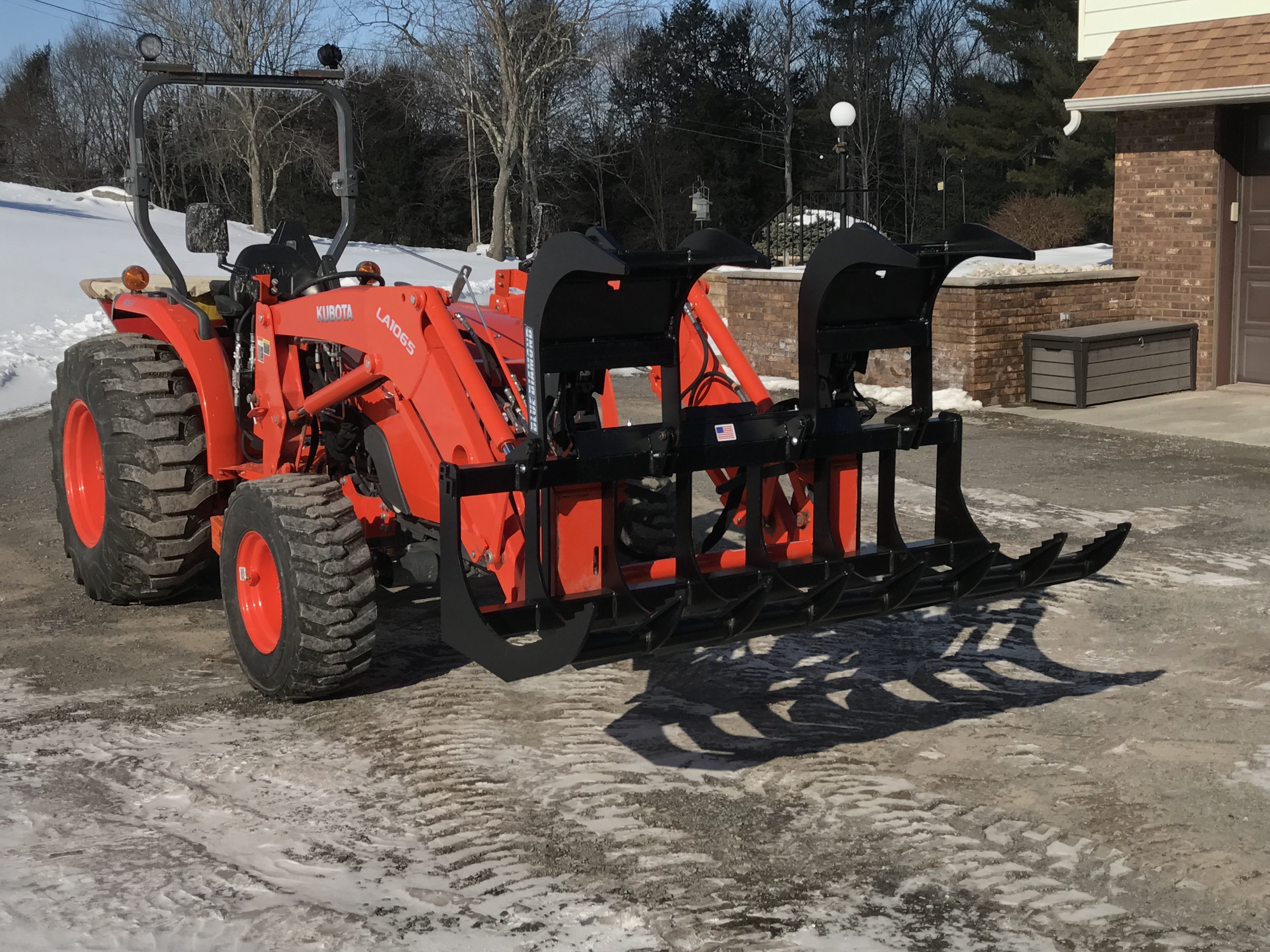

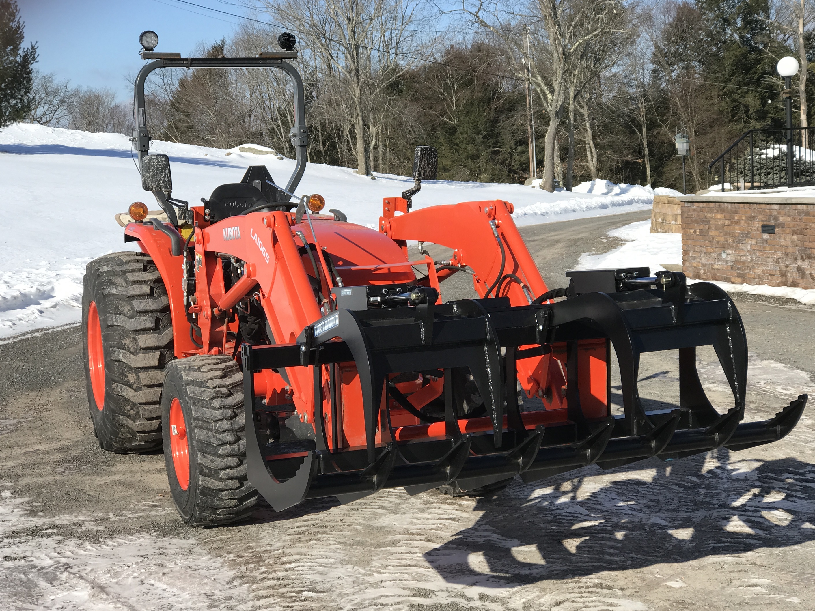

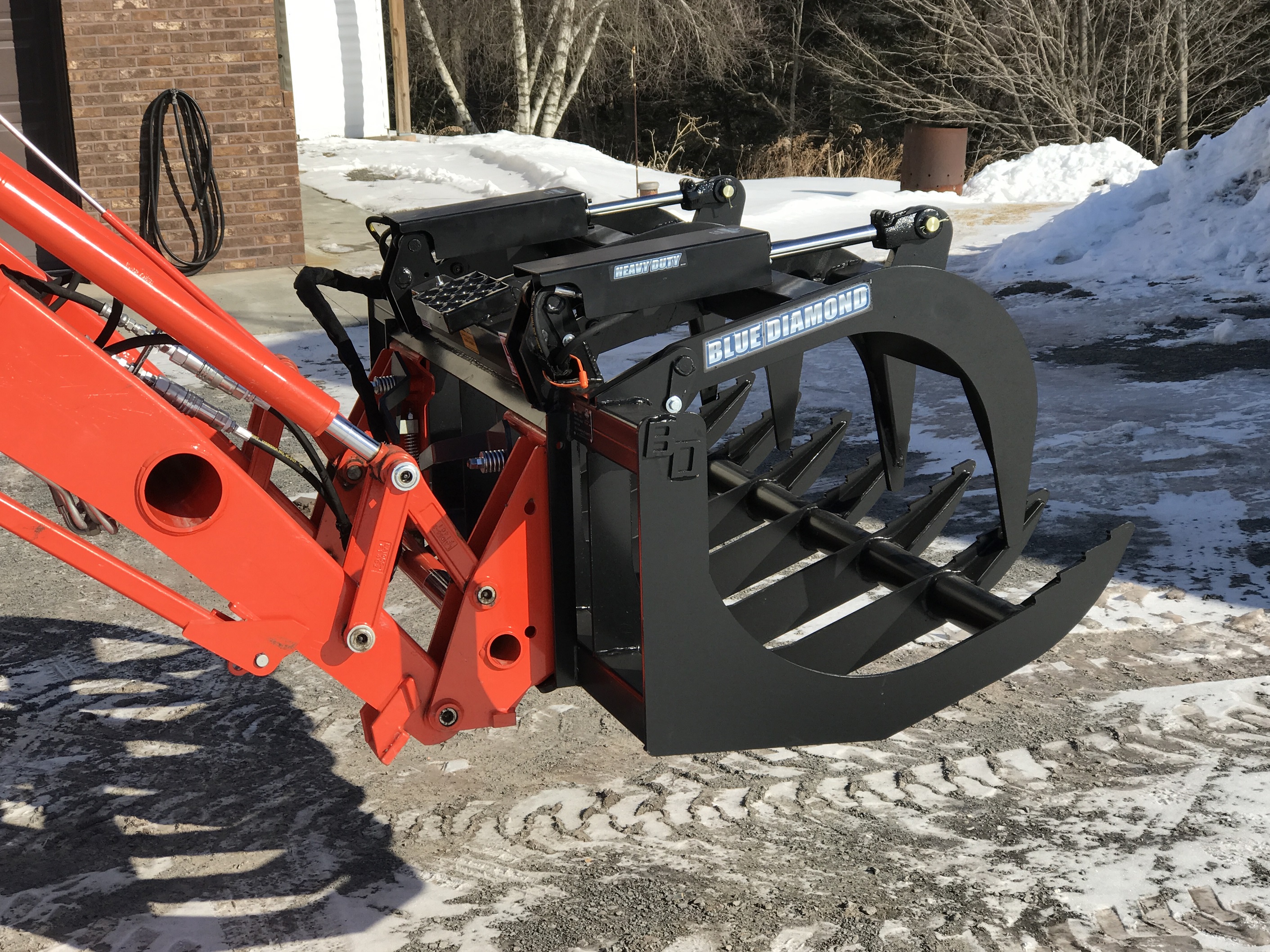

This is how the MX5800 and LA1065 FEL looks with W&R Long 3rd function valve and 72" Blue Diamond HD double lid Grapple. The damage was $850 for the valve installed and $2400 for the grapple. The valve kit for a BH equipped tractor required a hose and fitting substitution which the dealer provided at no extra charge. Would have meant a trip to the hardware store, more time and a few extra $ if I had done the install myself. They also cleaned up the minor rust and touched up the faded paint on the grapple which had been sitting outside for a while. Just one of the reasons I've been doing business with these guys for many years.
Yeah, $2400 is pricey for a grapple but it sure beat $3500 for the same size LandPride.
Considering it's only been a week since I pulled the trigger on the project, I'm happy enough.
