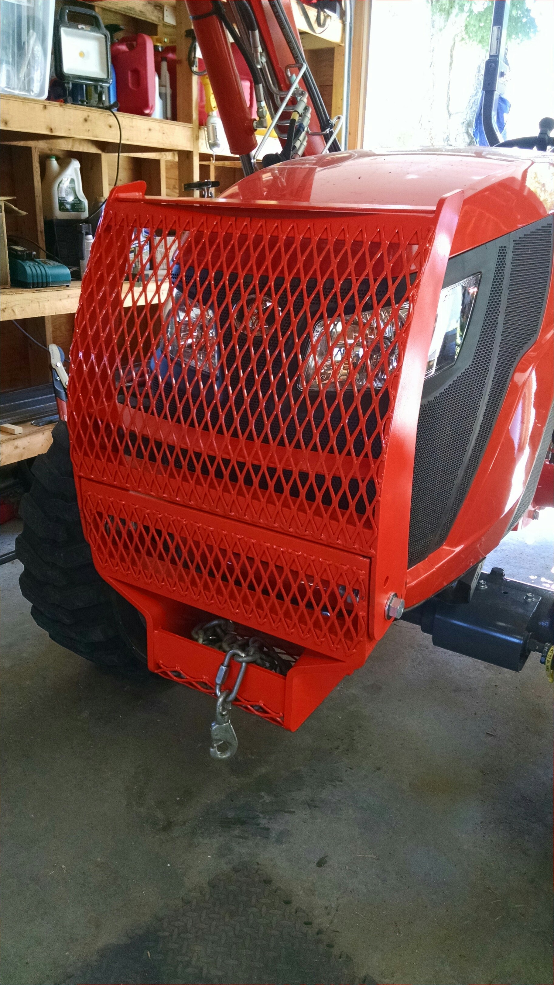

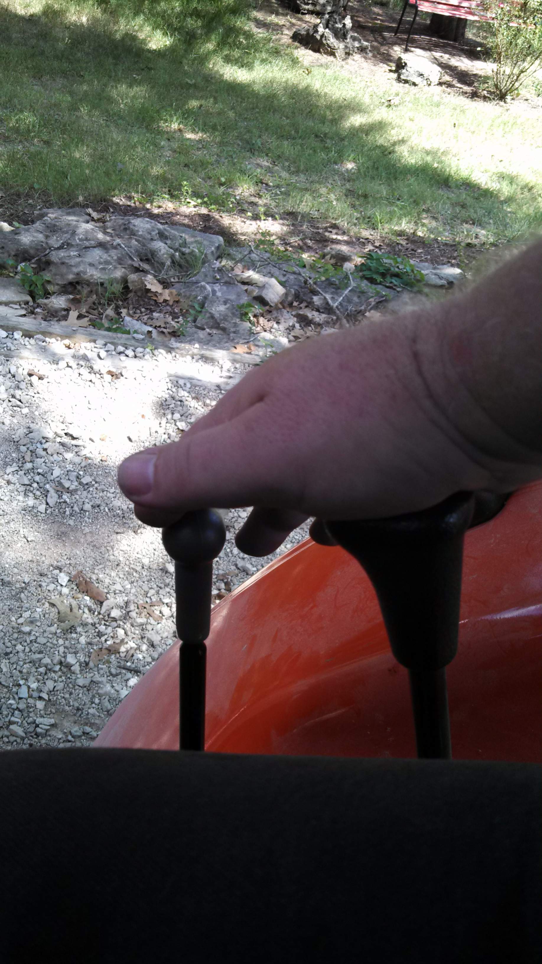

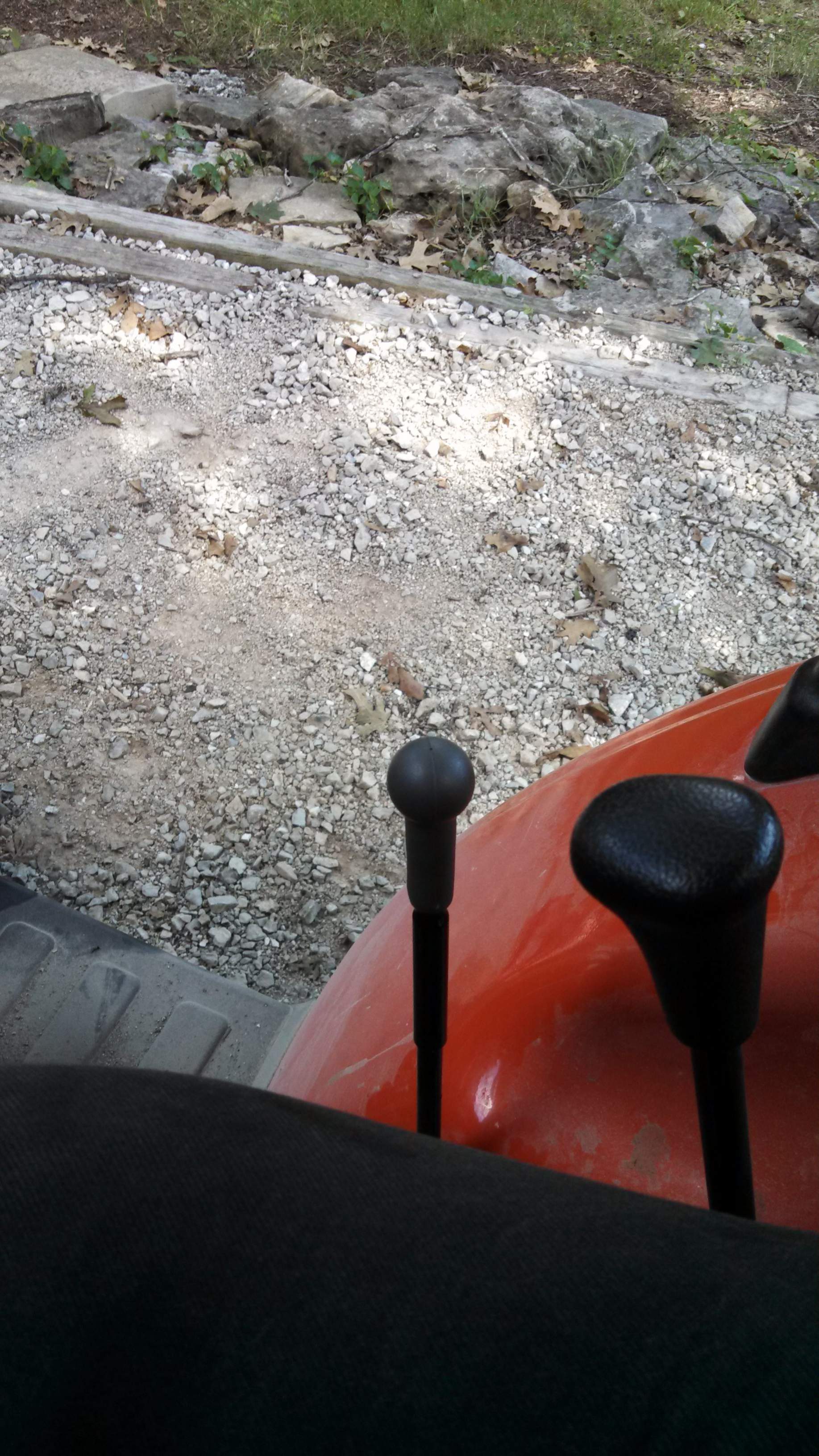

If you want an opinion, and that is all it is, it wasn't worth it to me. I really enjoy using my grapple with the rear remote. I don't find any loss of speed or function slowing me down at all. BUT on my particular tractor the Kioti DK35se the lever to operate the remote was in a good and handy place, and I made the operation better by extending that lever so I could keep my hand on the main joystick and still operate the grapple lid. If your lever was not near so easy to operate, you would have to decide if it was worth saving all that money or not.

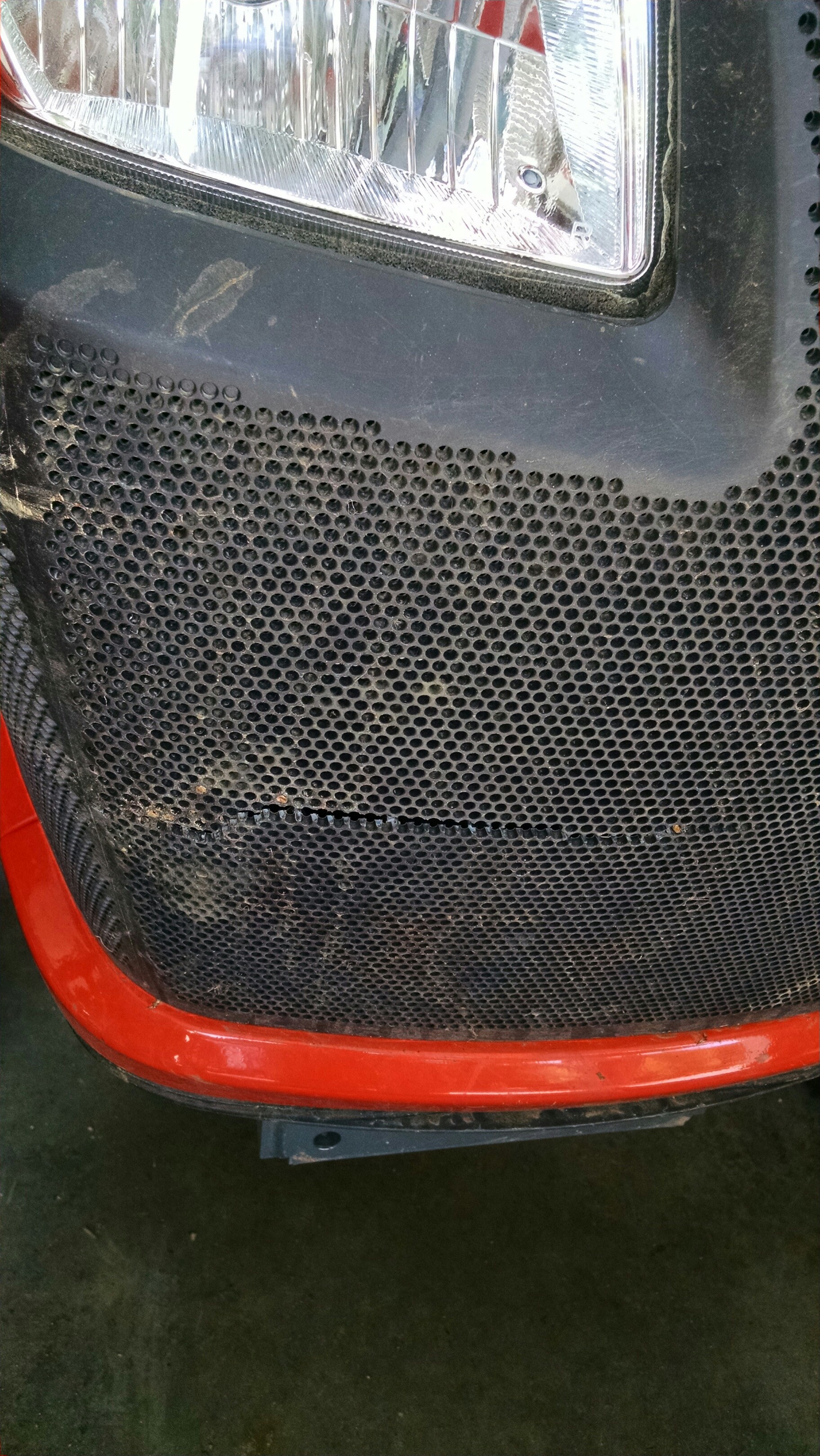

Also, not sure anyone has mentioned this but- YOU MUST PROTECT YOUR GRILL SCREEN from sticks poking through your grapple as you push into a pile and curl your bucket! Do it now or you WILL REGRET IT.
Even if you temporarily zip tie some plywood up, do it. Cheers. :thumbsup:
