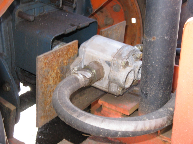

Here was my set up.
The pump was 5-6 GPM, at around 1000 rpm.
Don't forget rpm, you'll be spinning at 540 or 1000 not sure your pto speed on your tractor, my kubota had three, 540, 1000 and 1500.
The last time I looked at surplus something like this was under $100.
Your problem is definately going to be the speed at which you can spin the pump, I'm sure that is probably one of the keys to a PTO pump, the much have gearing inside that spins the pump up to somewhere around 2000 rpm.
I only needed 3-5 GPM so I ran a 10 GPM pump at half it's rated speed.
As far as pressure that is regulated by the bypass valve in your valve body.
As long as you've got the HP to generate the pressure.
You'd need to go up from there.
Joel

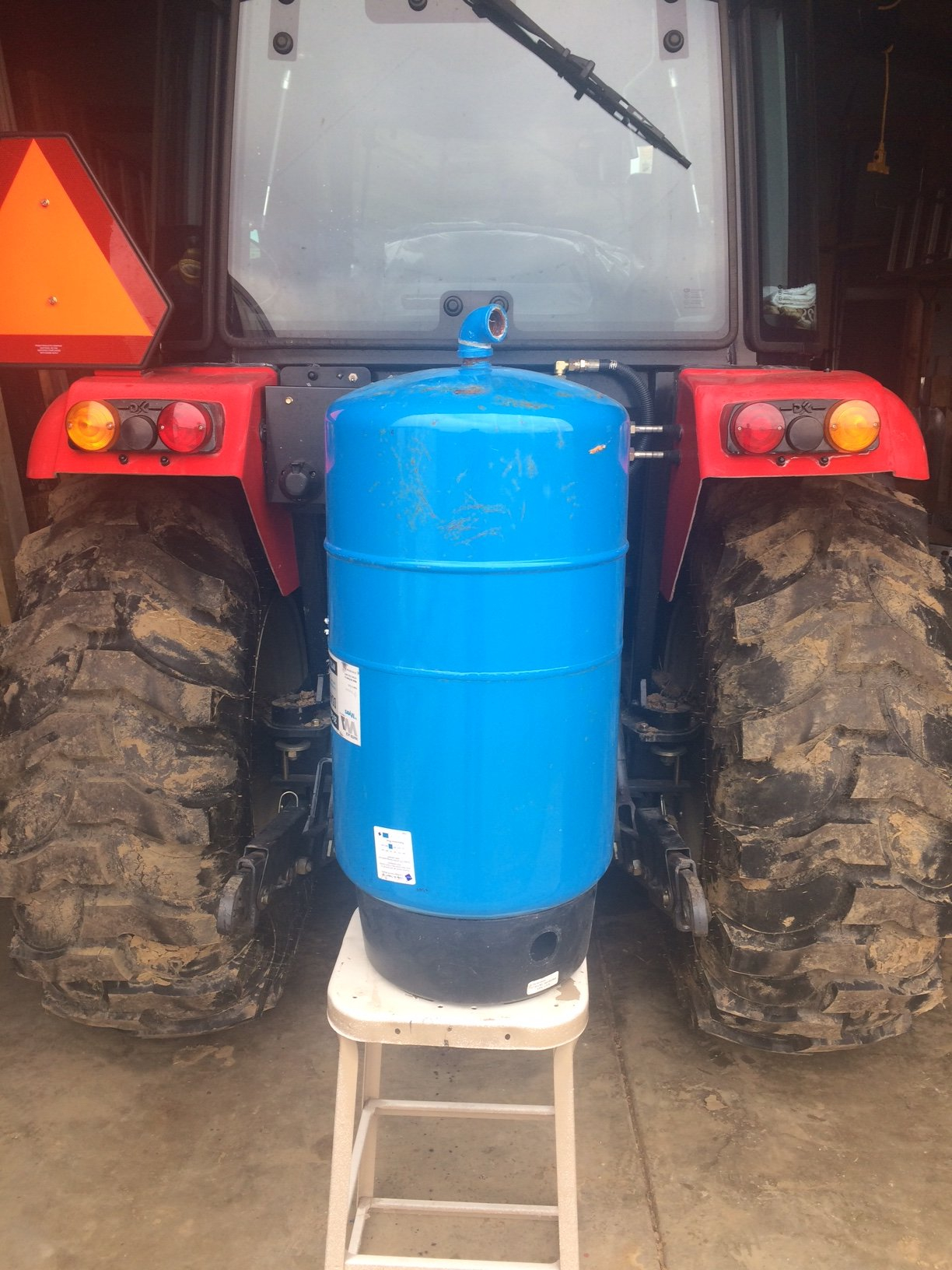

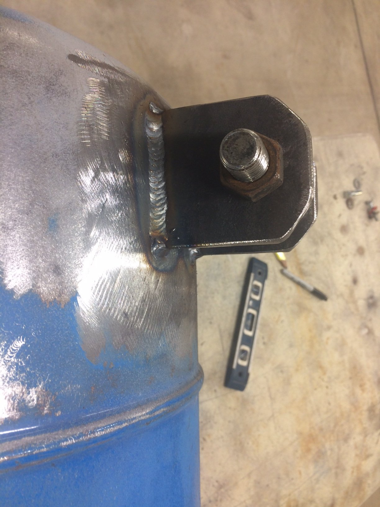

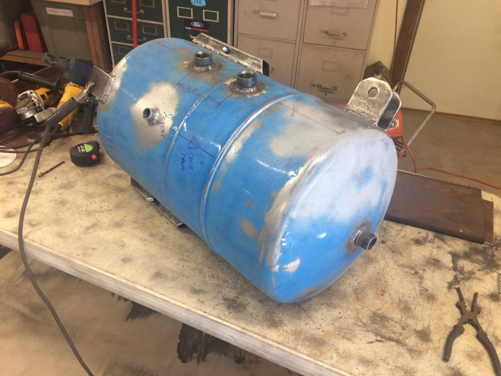

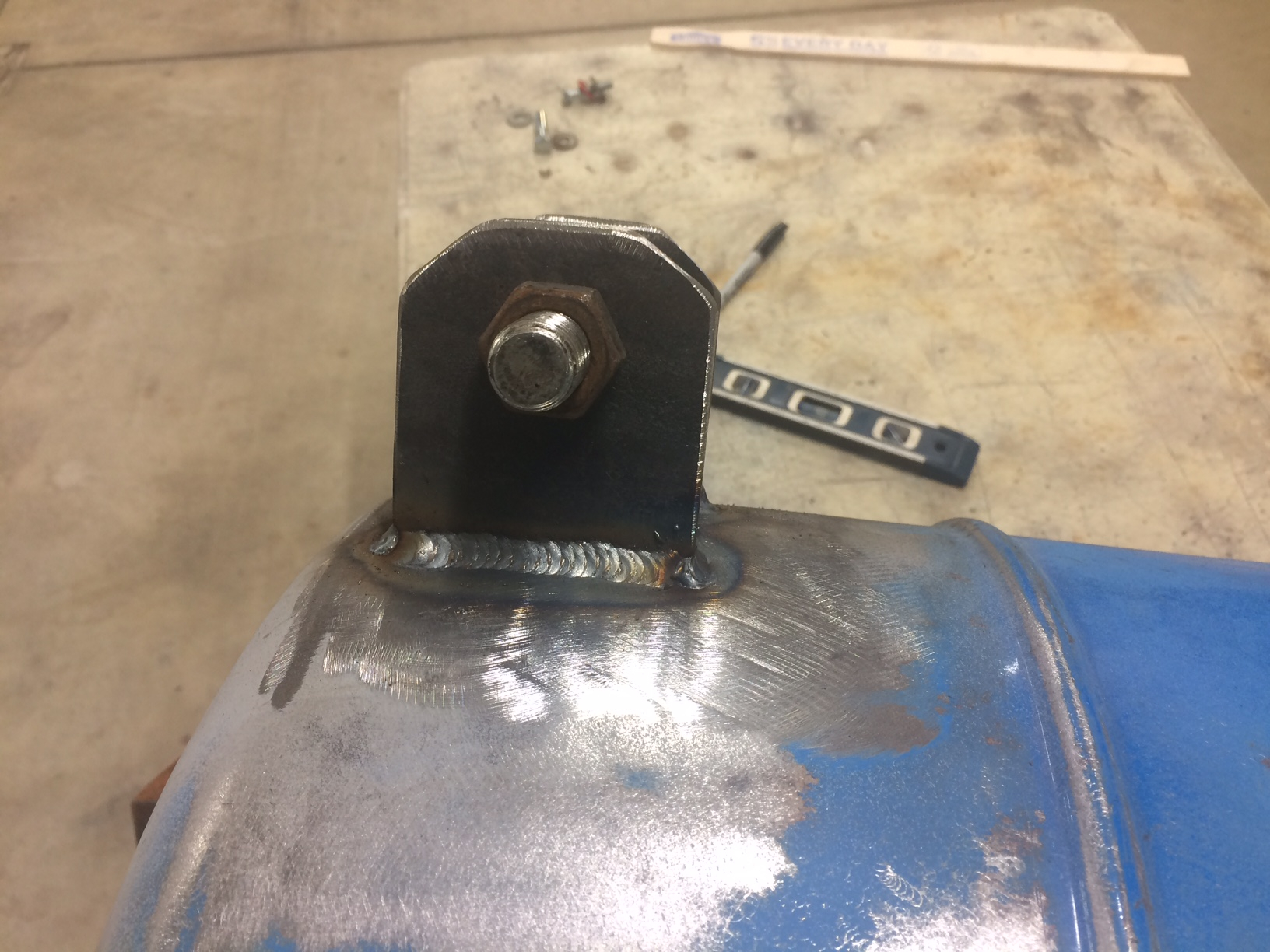

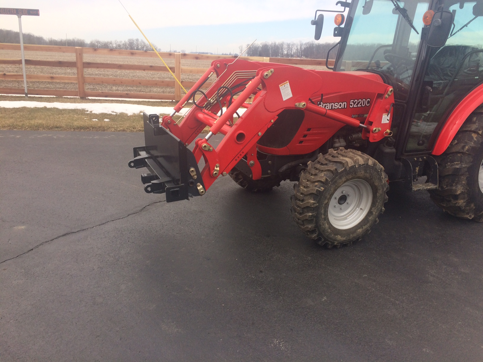

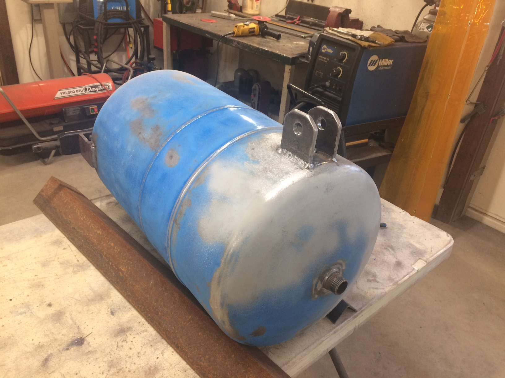

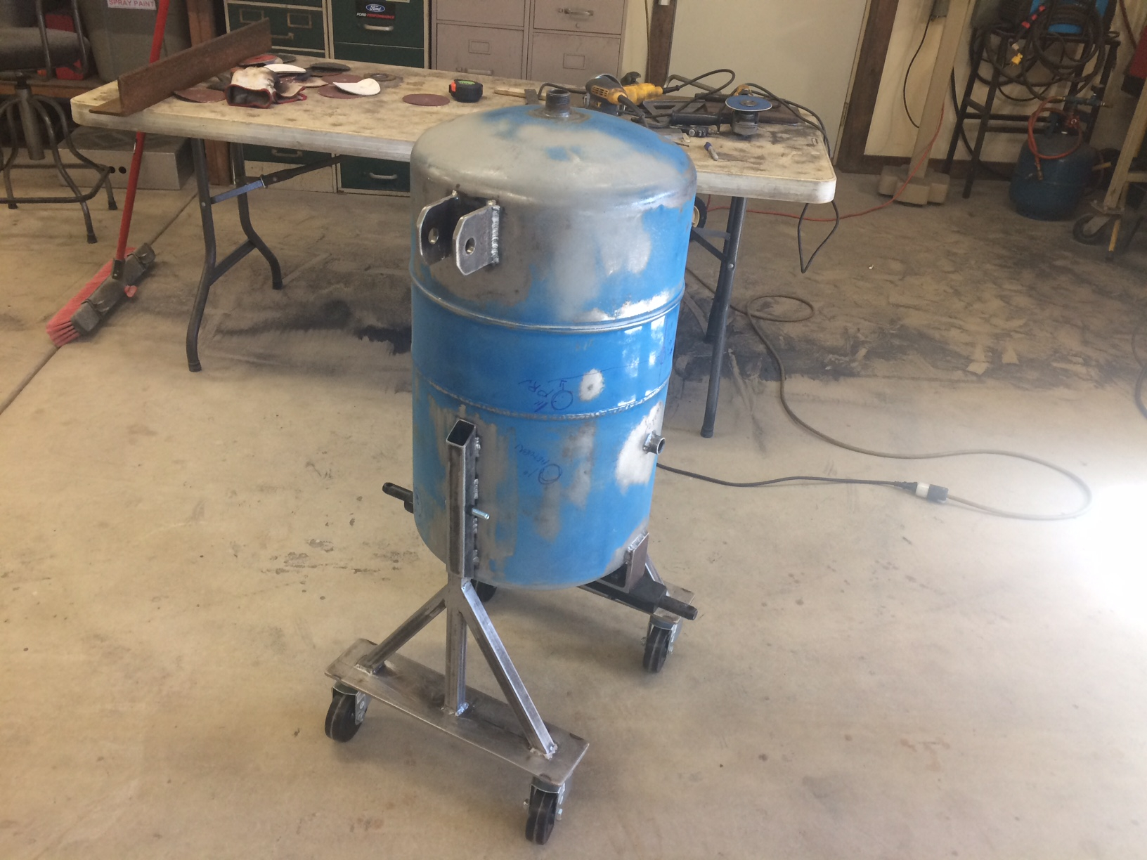

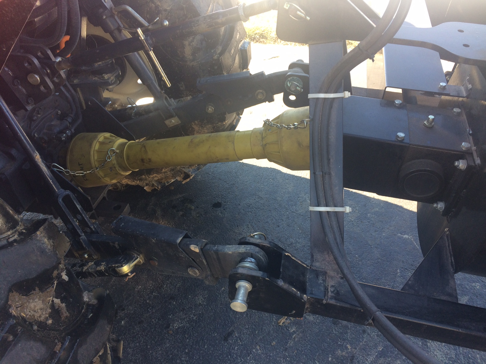

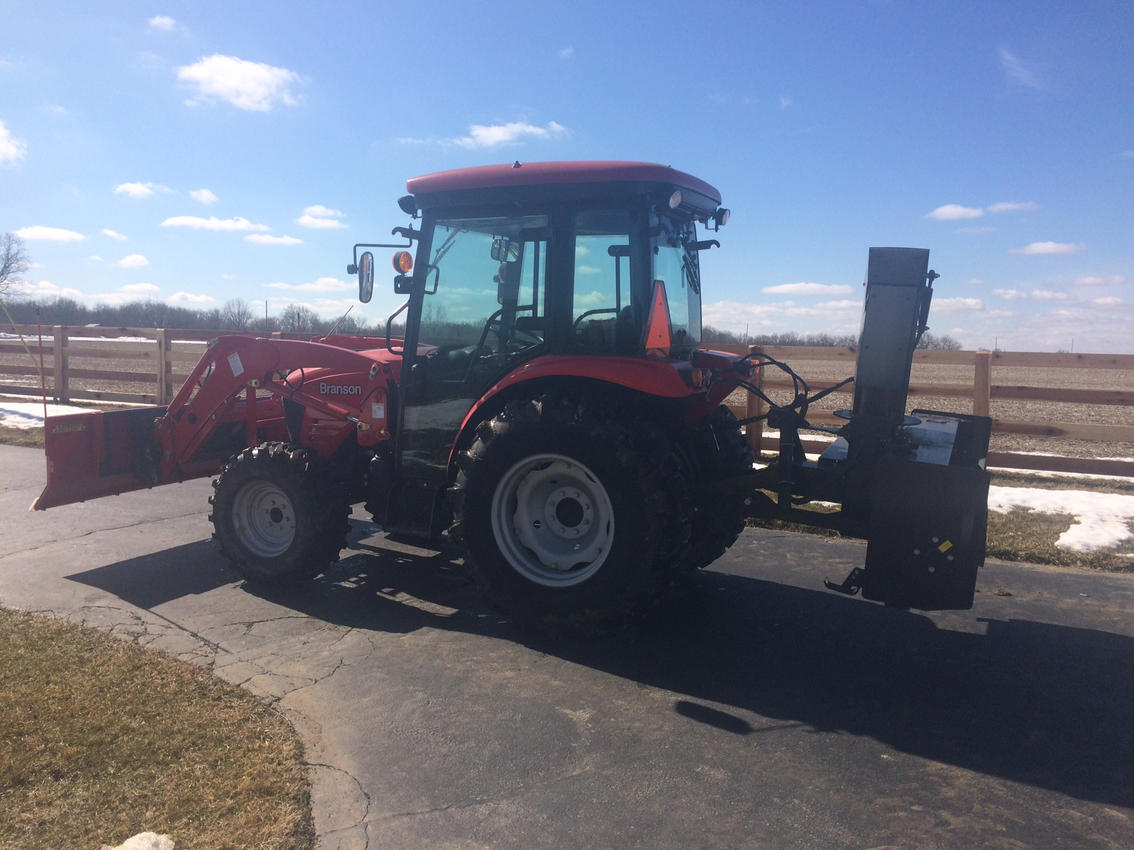

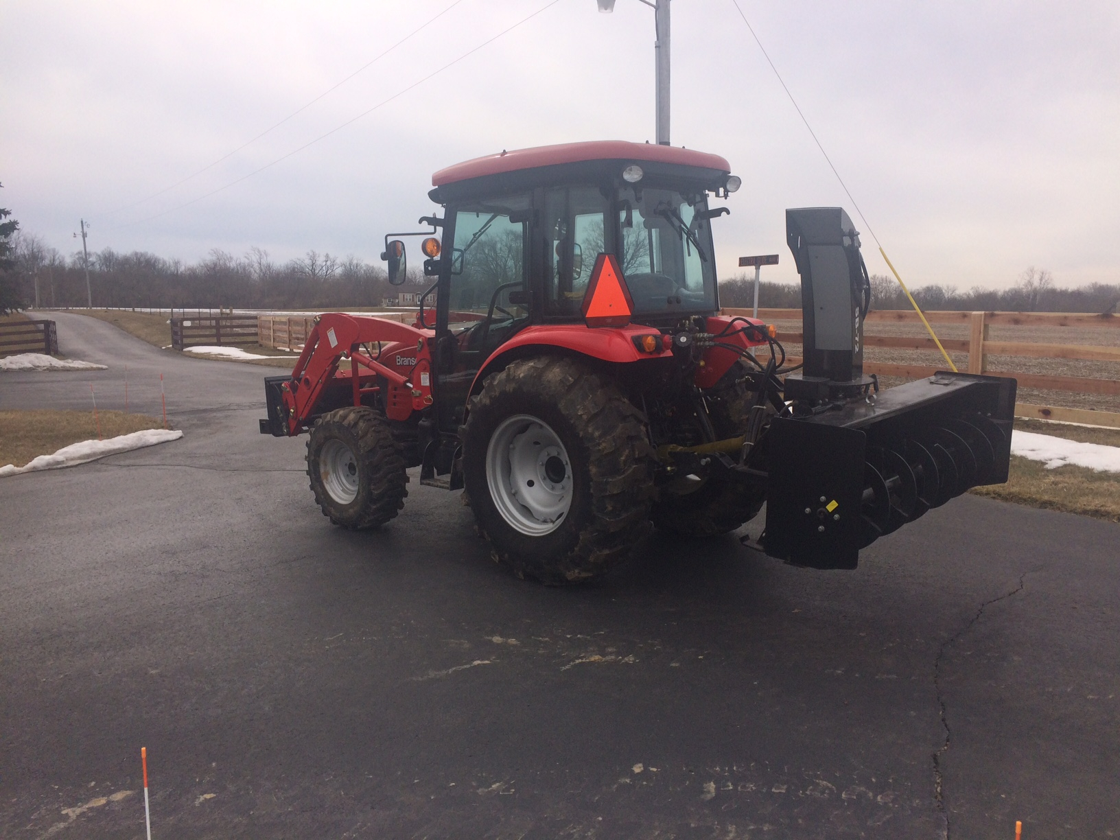

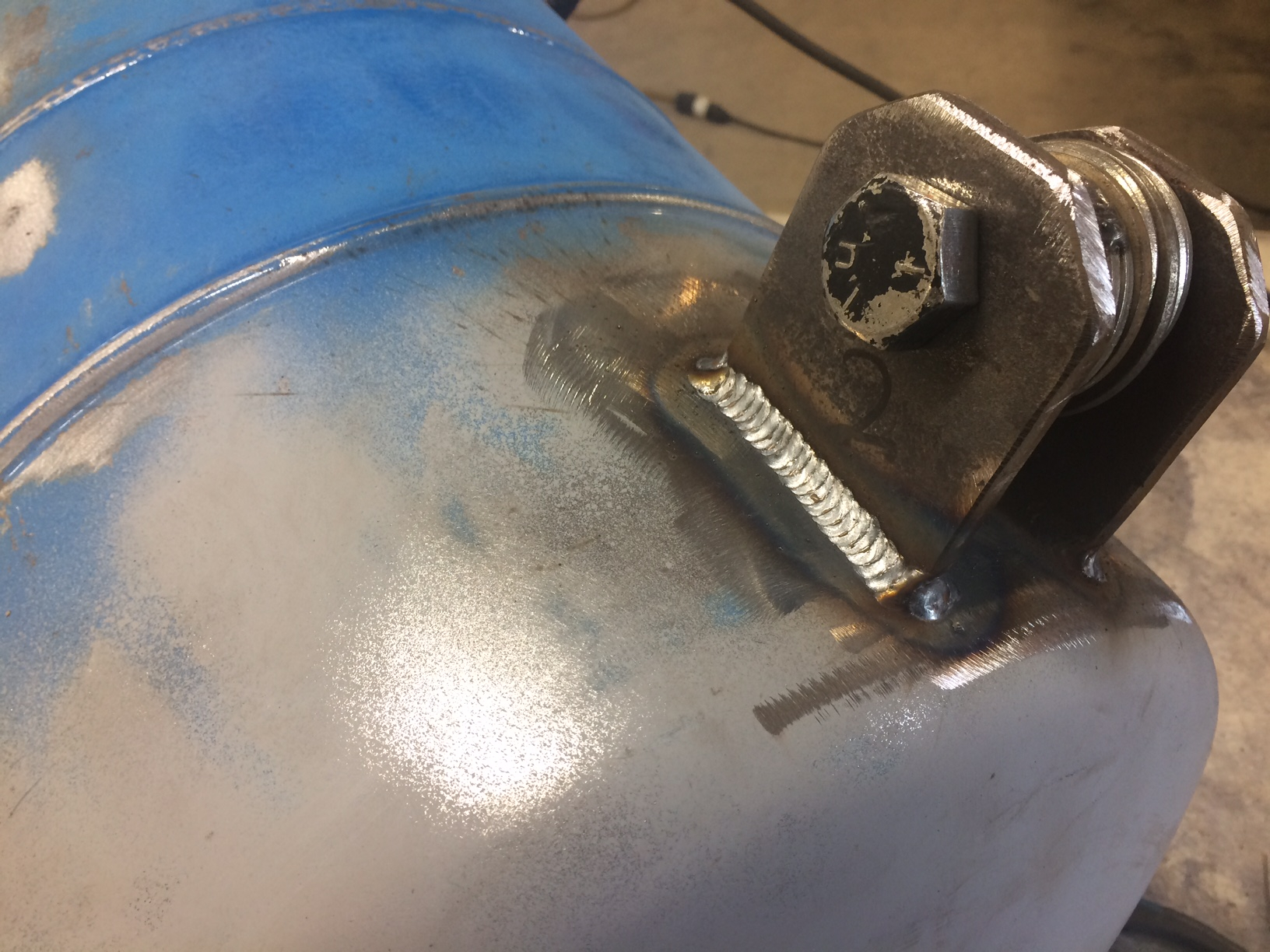

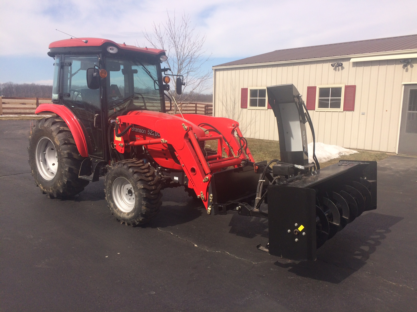

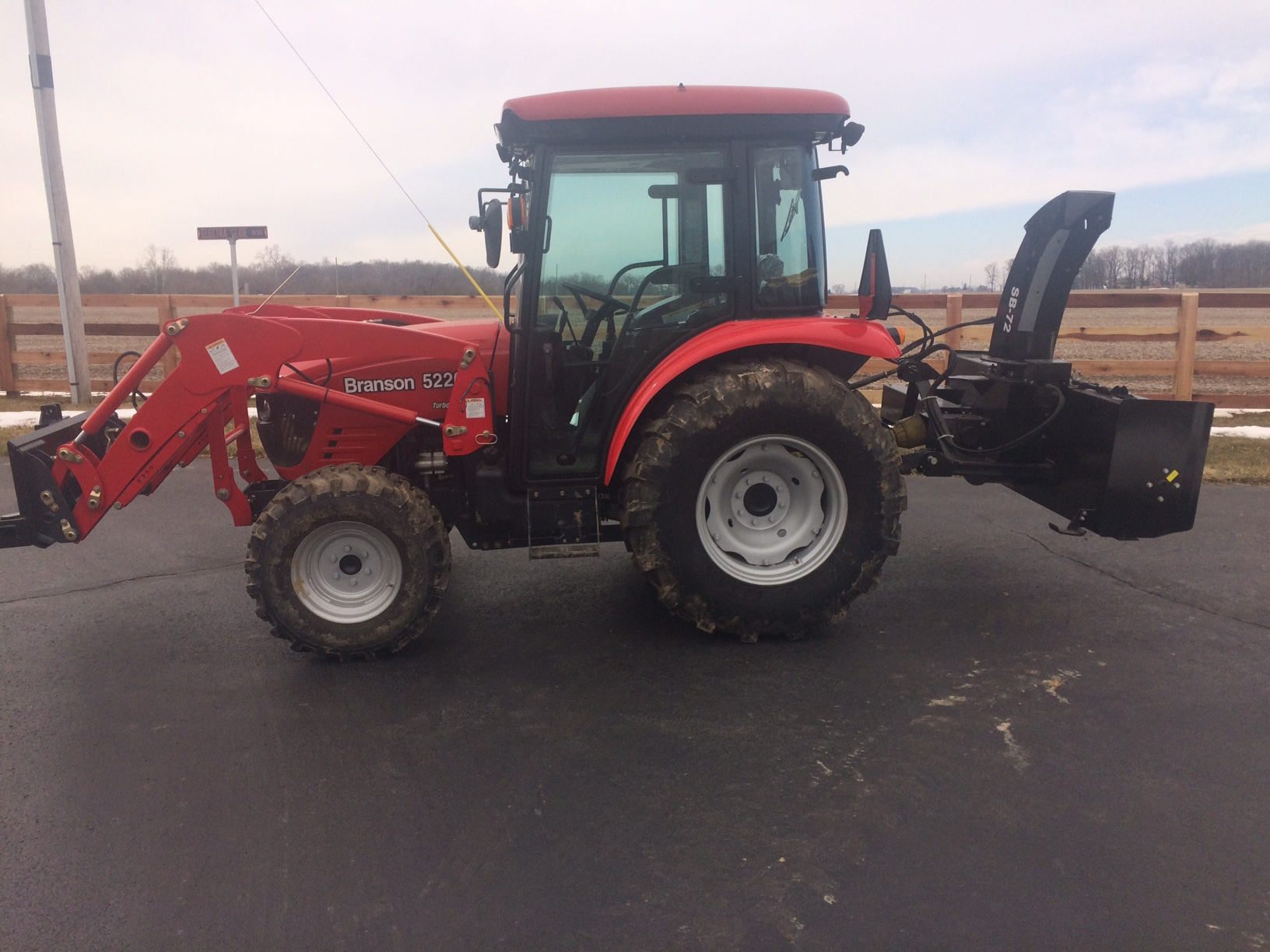

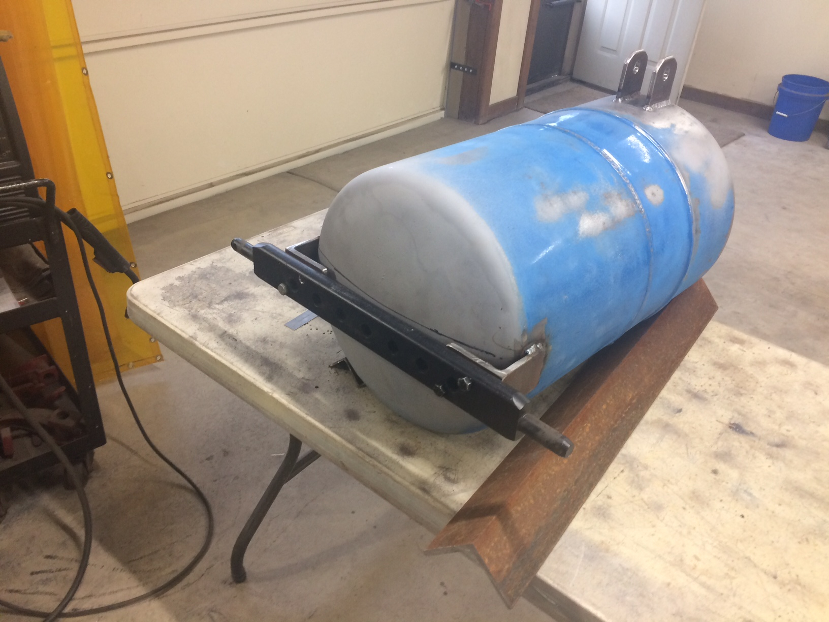

Hello... I just completed converting my rear mounted, PTO driven snow blower to a FEL mounted, with skid steer, quick attach plate, Hydraulic Driven unit....and it works great...so far as my testing indicates .
i tached everything at different RPMS to make sure that the snowblower is performing just as it did when mounted on the rear, using the PTO shaft.
I wanted to make my own tank because I don’t like the look of the big square tanks hanging off the Back....and just because I needed a fabrication project!... lol
I used the tractor existing hydraulics to operate the chute rotation and angle deflector .....just had to add longer hoses.

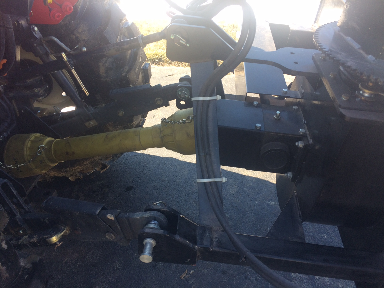

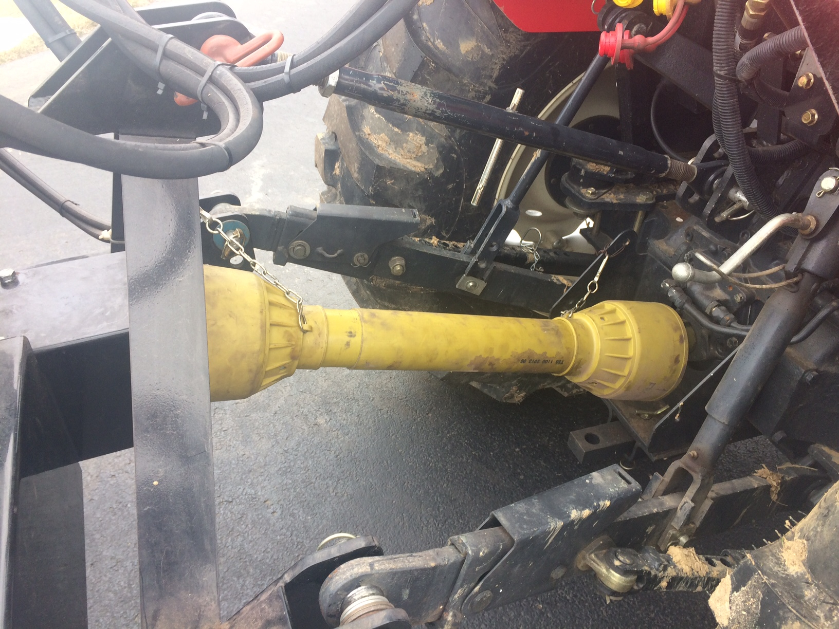

....and some more pictures
