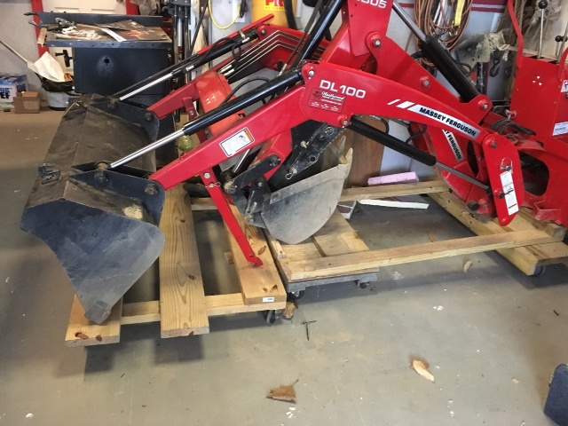

Hi Tim, It would help to know what state you reside. Also, my driveway sounds very similar to yours.
Here's what I do with the dolly's I built and how they "copulate" in the winter to save space.
