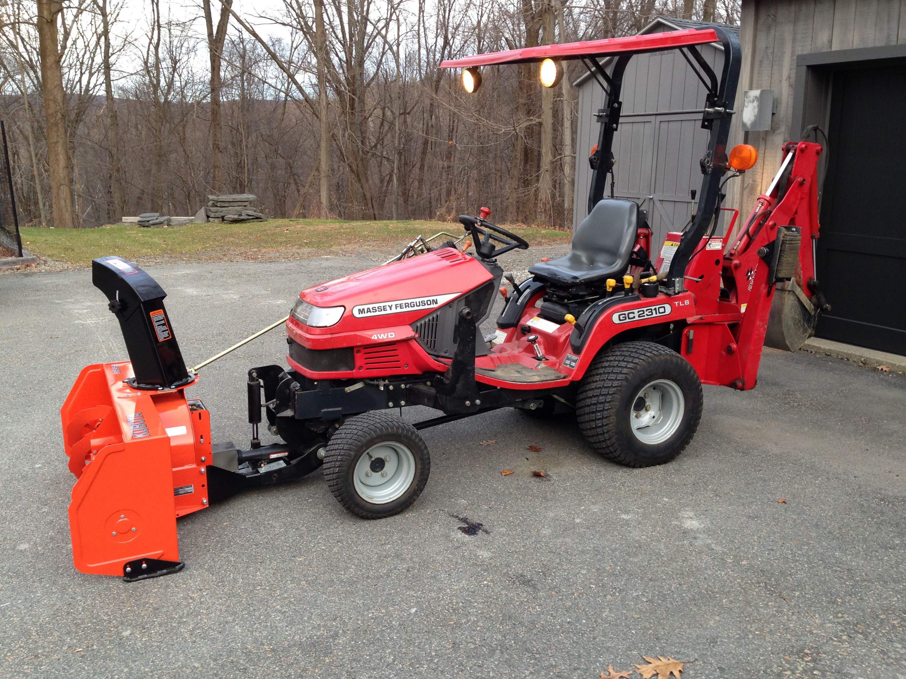

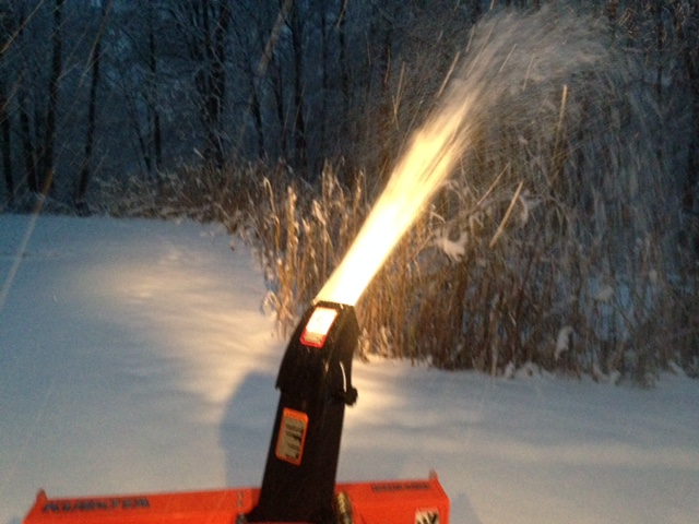

Seems to handle it just fine. We’re at 6,000 feet here so there’s also some HP loss due to the lower air density. If I go too fast into a heavy windpacked drift, I can hear the motor change pitch and lose 2 or 3 hundred RPM but it hangs in there and doesn’t bog completely down. Of course when that happens I back off the go pedal and let the blower catch up.
Adequately is probably the best word to describe how the 1720 handles the wider blower.
I didn’t intentionally look for a wider blower, one came up for sale nearby and it was in very good shape so I bought it. No regrets so far.

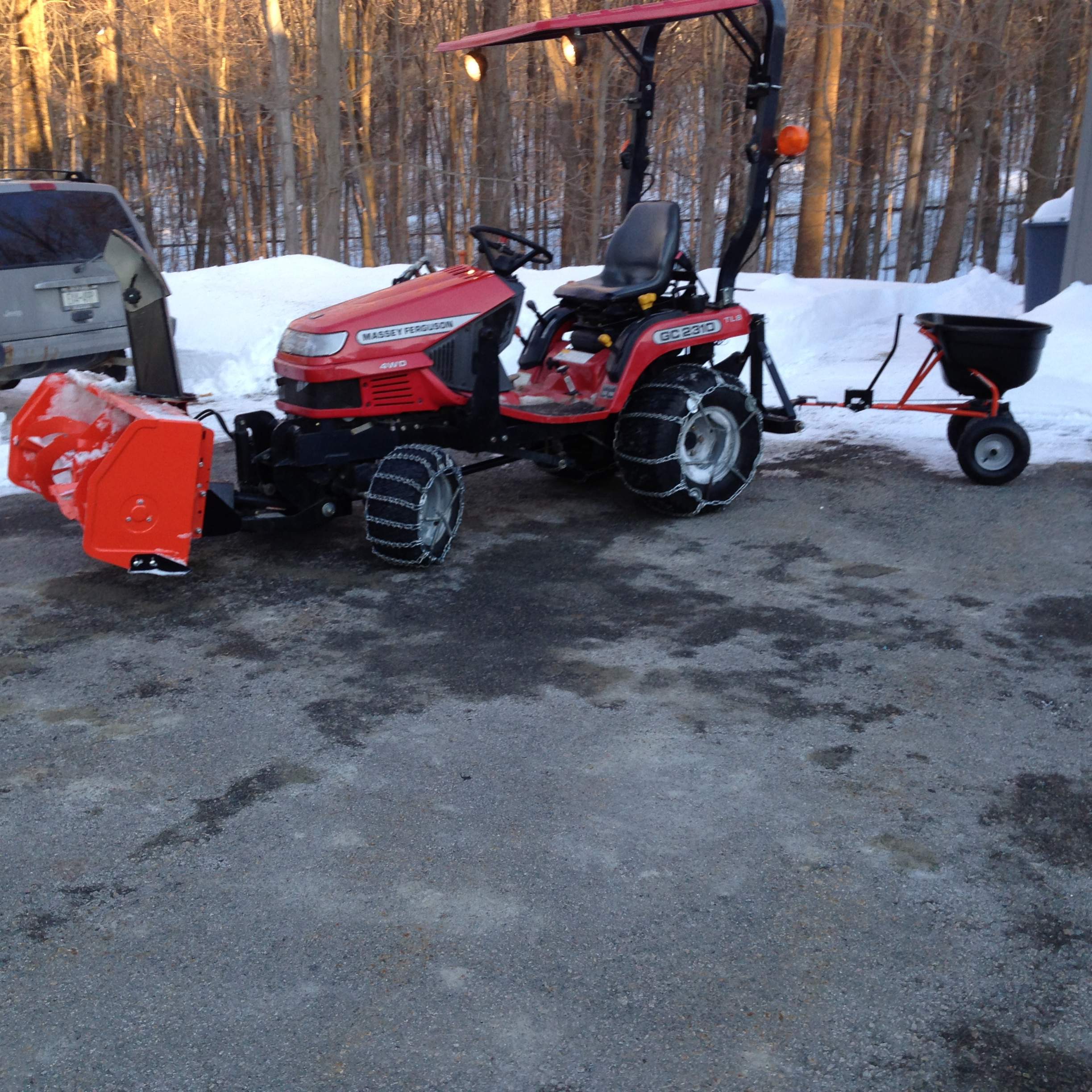

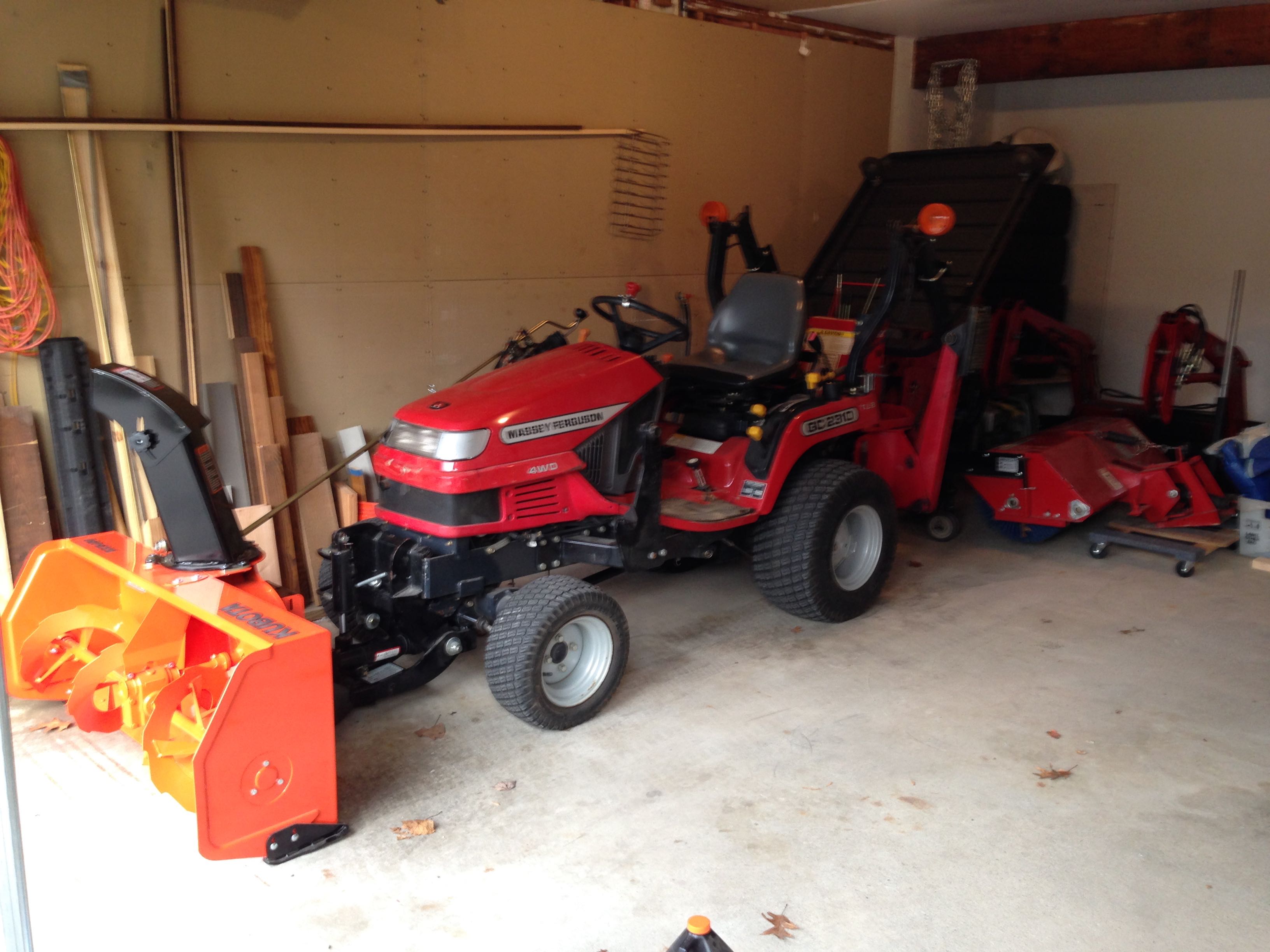

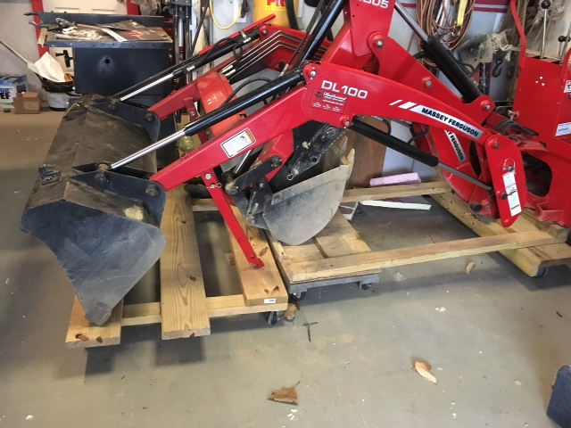

Here's what I do with the dolly's I built and how they "copulate" in the winter to save space.
Hey Pixguy - yep, that's how I have 'em stored up against the back wall. Now if you had a broom attachment (on a furniture dolly) tucked in lengthwise between your "copulater's" and the side wall....
Makes it a bit tight backing in so as to get the blower in far enuff to close the door.
What with the ROPS & it's canopy folded down (not enuff headroom) and a 3pt receiver hitch poking out the back...
Like threading a needle wearing mittens.
Oh & P.S. - I'm across the Hudson from West Point Military Academy. AND COME ON ALREADY, IT'S APRIL 2ND !!!!!!!!

Bob,

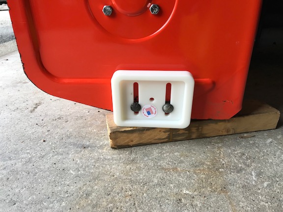

There are times when I need to turn tighter and have to raise the blower out of float. My skids are about 11" X 2.5" X 3/4" thick UHMW with front and back beveled at a 45. Besides skid design, it also looks like your mount puts the blower further forward in relation to the front of the tractor. This would also decrease steering control when it float.

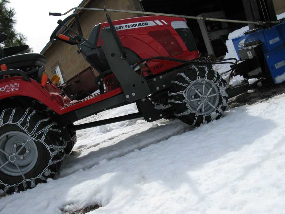

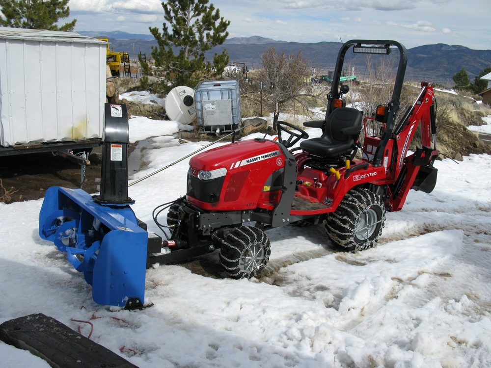

Here are a couple of Blue on Red pictures. The blower is a New Holland CS63.
Hey Langanobob - Looks like I may have to change the name of this thread to 'Orange AND Blue on Red'
I have 2 thoughts/suggestions
First one I credit to Irvinj - Take off the back hoe! I had big traction problems trying to snowblow up hill- even w/ 4 wheel chains. The b-hoe is just too heavy.
I was doing wheelies - couldn't steer or keep the blower on the ground!
Second - Was in a post (pg6) by Jaylegger about a slight difference in the mid pto rpm's of an Orange tractor to a Red. Accordingly, you may want to compare the 1720's listed PTO rpm to the CS63 blower's optimum impeller speed. While I haven't (yet) changed out the impeller gears, it may well be worth you looking into given the extra challenge @your altitude. Maybe Jaylegger would have the Blue part numbers for the gear swap.
Here's his post:
It's common knowledge all these blowers are manufactured by Rad Technologies and except for the impeller gearing these blowers are essentially identical. Since Kobotas spec'd pto speed is 2500 rpm vs Masseys of 2000 rpm, different gearing is used by rad tech to achieve the proper impeller rpm for both manufacturers. The gear ratio used Massey blowers 2:1 reduction while Kubotas is approx 2.9:1 therefore taking an optimum impeller speed into account these units are not really interchangeable.
Optimum impeller speed for these blowers is between 900-1000 rpm and while going higher is ok, going lower than this can compromises efficiency. Taking your gc tractor as an example where the impeller speed for a "massey" blower would be exactly 1000 rpm, swapping out for the same Kubota blower drops your impeller rpm to 687. For the sprocket chain blowers this is an easy fix to increase impeller RPM by just replacing the sprockets, Rad uses sprockets H40B26 H40C13 for the Massey MF2360.:

Blue on Red looks nice!
But it doesn't sit any further forward than my Orange
And while your 63" NH blower is slightly heavier than my Orange BX5450 (by about 150lbs)
the backhoe weighs in at over 700lbs AND the tractor weight is concentrated towards the rear
When I remove the loader w/ the backhoe on, I cant keep the front wheels on the ground
So you have 700lbs Cantilevered in back w/ 400lbs of blower up front - waaaay unbalanced (like the wife says of me sometimes!)
And why carry the extra weight?
Get rid of the backhoe when you mount the snowblower - you'll never have a turning or traction issue again when snow blowing - in float or down pressure- period-
Thank me later (next season)

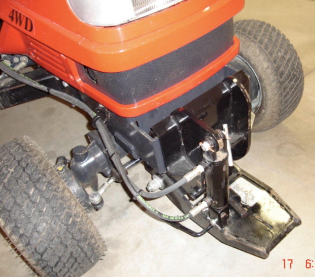

GStevens, are you talking about a GC2410? If so notice my pic of the MF/Kubota front mount Quick Attachment https://mckeownmotorsales.net/wp-content/uploads/2017/11/P1010897.jpg It is not the same as your quick hitch which AFAIK is used on the 3pt hitch. The Quick Attach is made up of two parts, the on tractor mount - see it hanging off the front of the tractor in the pic? It consists of a triangular foot with the hydraulic cylinder attached and the triangular shoe which is mounted on the front device, snow blower, broom, plow.
IIRC I bought a separate shoe from Messicks, and mounted it on my snow plow's mounting bracket. The tractor foot fits into the shoe and there is a locking/tightening lever. Without that mount you need a different kind of blower.
If you are talking about a Kubota B2410 and the rear mounted broom Compact Tractor 3 Point Hitch PTO driven Manual Angle Sweepster Broom, 4', Reversible Rotation then I have misread your intent. My research shows that the Kubota 2780 front mounted snow blower fits the B2410 and appears to be the same as the MF2360 blower. If so what I previously said should apply. Get the Kubota Quick Attach and use the MF 2360.

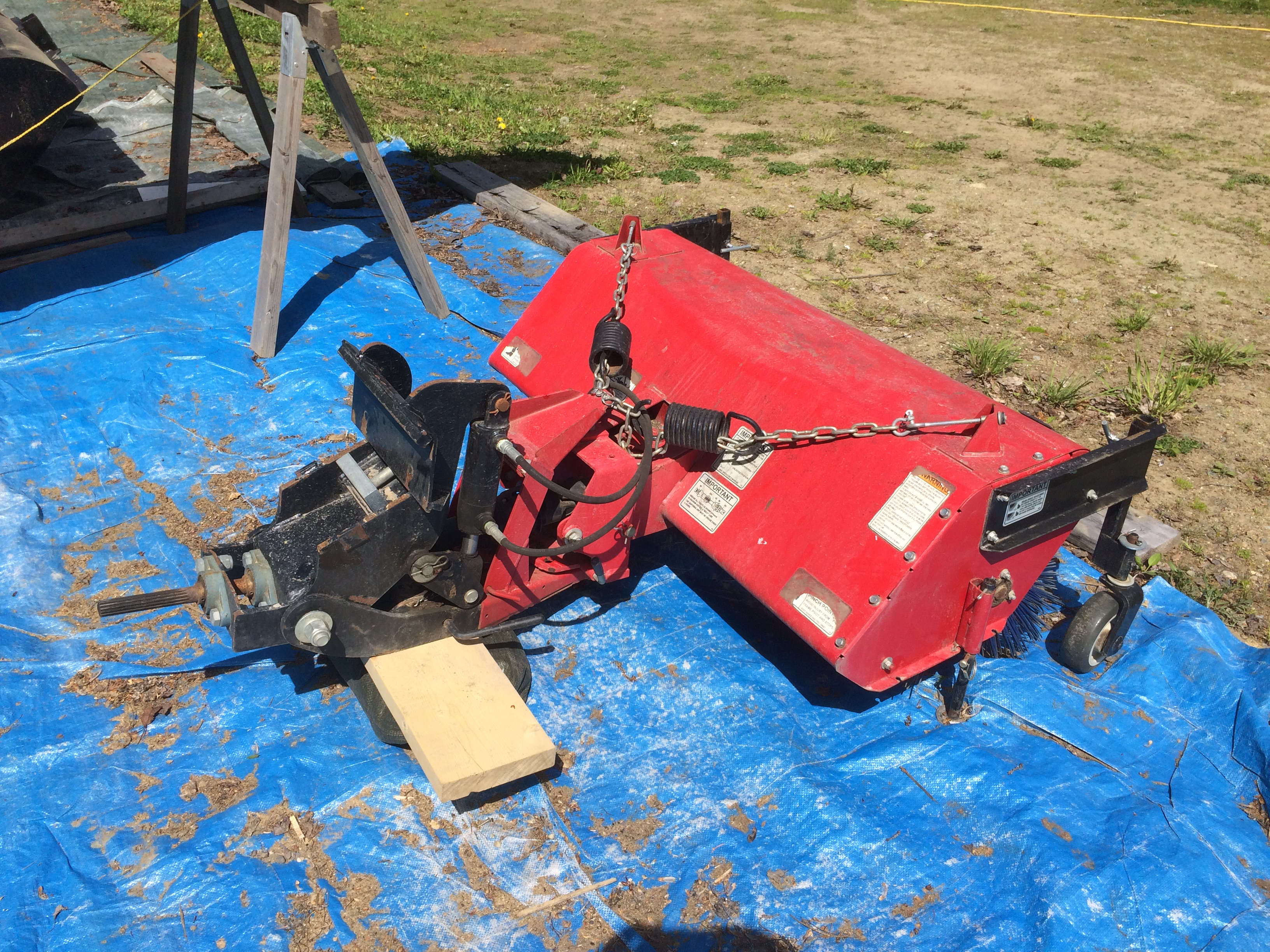

Just to be crystal clear - and loving how a picture is 1000 words - here is what I have with the front-mounted rotary broom. And yes, the machine is a GC2410.
So I'm simply looking for my options on the blower unit that would go on to the existing sub-frame. I know what the MF unit costs, and wonder if the Kubota unit would match up exactly with the MF sub-frame/quick hitch?
