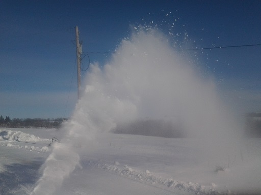

No tracks yet. Wanted to try the blower. It's a freaking beast!
   / Ordered a Berta two stage blower and a set of tracks #16
Wow, Looks like it will do the job and then some. How do you like the tracks? Are you glad you got them? Thanks for the pick's and video. Saw the video on the pto driven trailer too. WOW again. There are times I wish I had a two wheeled tractor instead of the massey. Ed
   / Ordered a Berta two stage blower and a set of tracks #17
I find here in Maine throwing the snow 30 feet away keeps it from drifting back. I also like that you don't end up with snow mountains that last until July.
