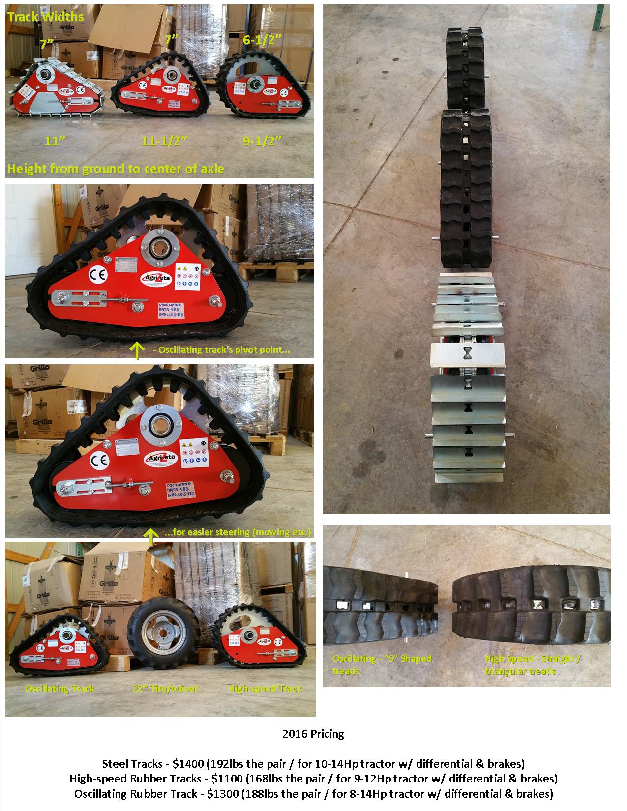

According to a page Chris at Earth Tools sent me, the axle height on the steel tracks is 11", rubber gear reduction tracks is 11.5", hi speed tracks is 9.5". The rubber gear reduction gives you 2" more clearance versus the hi-speed track I have. BUT, your speeds are reduced by half. 1st gear would end up about worthless at .3 mph, 2nd gear would become first gear at .9 mph, and third gear is 1.6 mph. 4th gear might end up more useful for higher speed mowing at 4.3 mph. Human walking pace is roughly 3 mph, so 4th will be a very brisk walk/jog.
I wouldn't recommend the steel tracks for mowing or driving across pavement. They're gonna be very aggressive and tear sod and pavement up. The rubber tracks will have almost the same traction and will be much gentler.

I would guess maybe the one oscillating track would be okay for climbing out of a hole - it has a little bit of an up ramp there, especially if I push down on the handlebars.
Not worried about speed - in the woods slower is better - easier to maneuver.

My current wheels/tires on the Grillo 110 are ~20" diameter which makes the axle sit about 9 to 9.5"
So that would mean I wouldn't lose anything with the hi-speed tracks and I would gain 2 to 2.5" with the low speed tracks.
