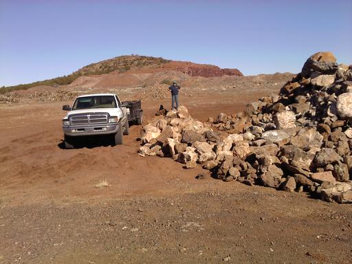

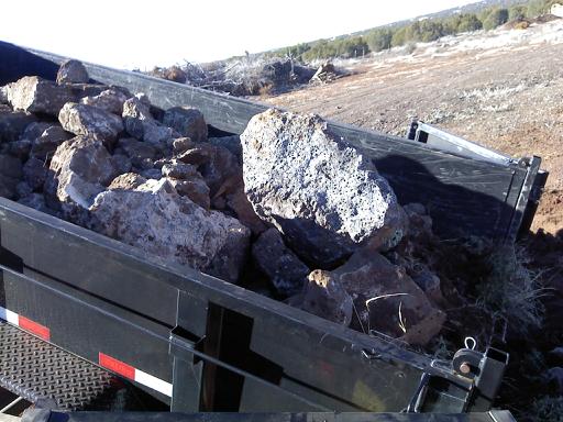

My loads with heavy material are 6.5 ton at the most. I split the seam in the bed loading boulders. Lesson learned. Now I throw down a layer of wood chips, and scrap plywood before landing heavy rocks. Enjoy the DE, and keep us posted when you get it.
I try to stay at the 6-7 ton also, that puts me at my 26k max. Sometimes when I haul demolition concrete or black top or boulders, I get over that:) If I have maneuver room I load at floor level with the gate open.

Hauling rocks on my Big Tex 14LX.

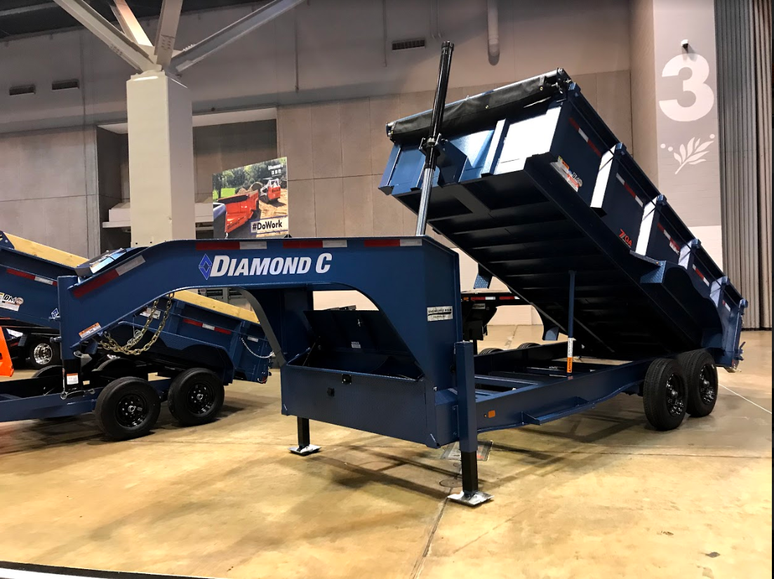

What I found comparing their LPT model, 20k gvw v/s PJ's new DE model, 20k gvw, was significant.
The Diamond C used 8"x15# I-beam main frame, Lippert 10k torsion axles with 215/75x17.5 tires (4800 lbs) and a light weight tail gate. Two hinges, even on the high side dumps, 1 cam lock and the spreader gate chain is too far up the gate. It is about $3k more than the PJ.
The PJ uses 10"x19# I-beam main frame and even box the inside from the front axle to the gooseneck riser. Dexter torsion 10k axles with the 235/75x17.5 super singles (6000 lbs). Three hinges on the tall tail gate, 2 cam locks and the chain at the bottom.
Diamond C does have a new model with the Fleetneck and engineered beam main frame coming that appears to be a fine trailer. I have no idea on pricing or the fine print yet. Here is a picture of it:

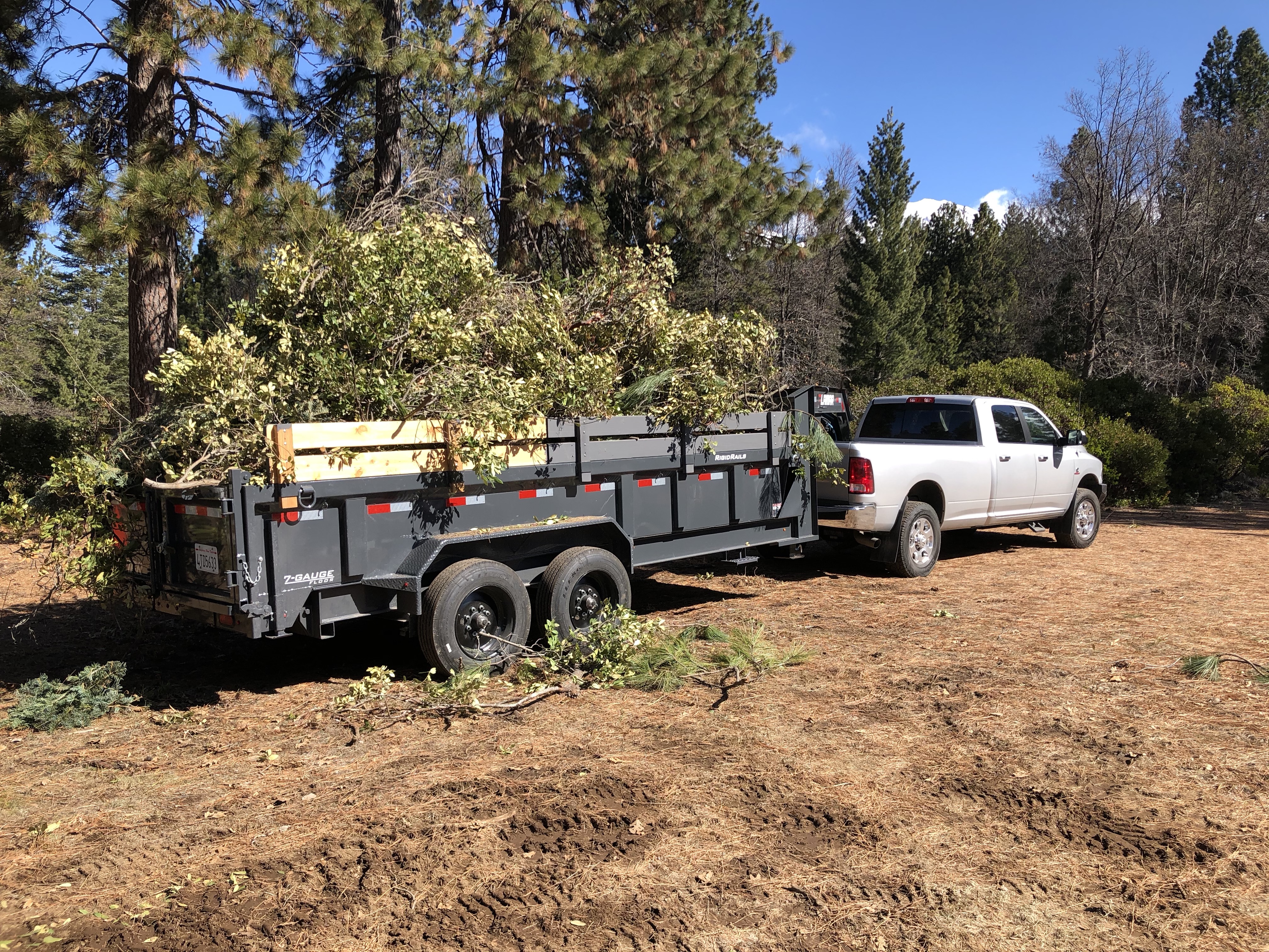

I wonder if it would be prudent to remove the wood extensions before sending them?
I have a suspicion they might blame you for overloading? Even though I’m certain you are not and you built the extensions for light materials (leaves, mulch, etc.)
