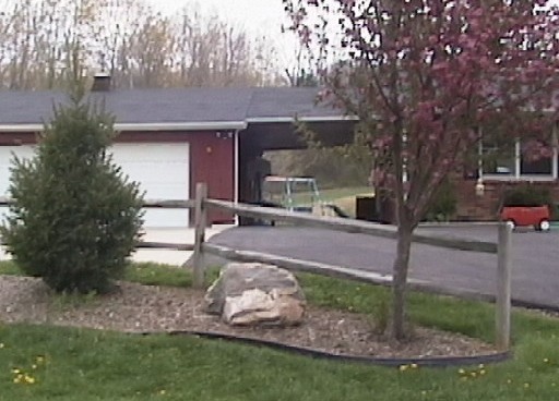

Michigan rock in Indiana. The white spruce tree also came from Michigan.
   / Ordered my Bush Hog M246 FEL
#52
I went back to the scales and weighed the pickup empty. The rock weighs 870 lbs! Much more than I thought. I got my manual and bucket level indicator. They just forgot to bring them. I detached the loader and it's as easy as advertised. I didn't have time for pictures because I needed to get the grass mowed, it was starting to look like a hayfield. I'll get some pictures of the FEL detached when I get a chance.

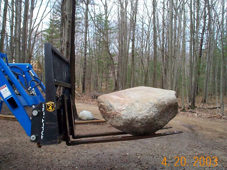

Mosey, I was just surprised that it weighed that much. It's hard to tell these things from photos. Your rock looked similar in size to a rock I have here. I transpanted it today for the wife into a new flower garden I made for here. I picked it up at the end of my 48" forks. I estimate the center of the rock being over 36" away from the pivot point where my 7308 is rated at 880 pounds. So with my rock being at least 36" further out from the pivot point, my 415 pound forks mounted on the loader, and my Kasco Uni-Hitch also on the loader I just figured that my rock couldn't weigh over 400 to 500 pounds. Take a look at my rock in the attachment and tell me what you think.

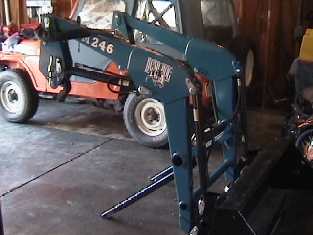

Here are some more pictures. First, FEL detached.
#60
Tractor with FEL detached. The part that stays on the tractor weighs over 400 lbs.
