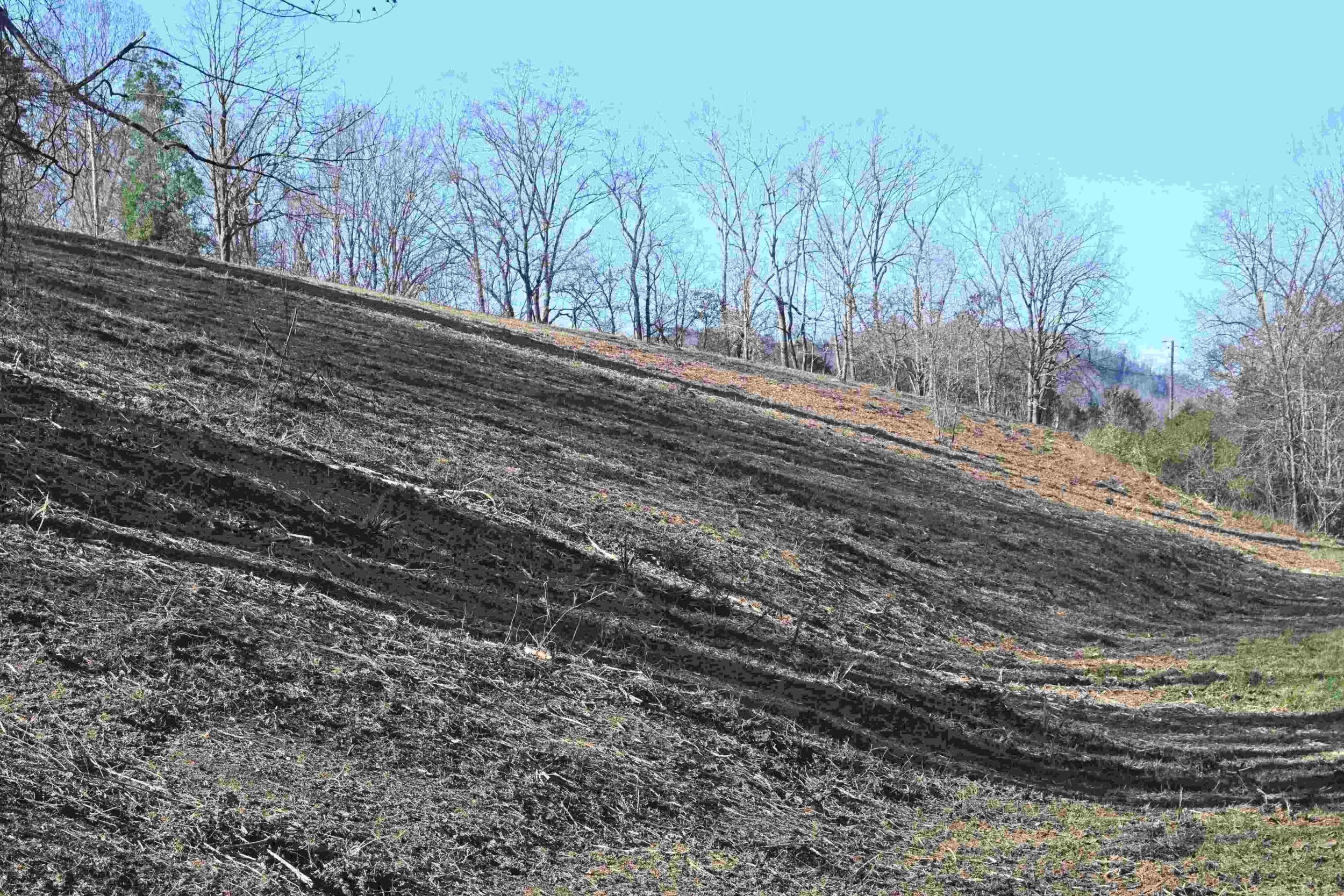

Update: I hired a company who used a Cat299d equipped with a Cat mulching head to clear this slope.
It was money well spent because they were able to grind up even some small trees on the slope in only a few hours that would have otherwise turned into a chainsaw job plus having to drag the debris off the hillside. It also made a difference that the operator was experienced operating this equipment on slopes.
The mulch residue left behind is pretty deep in places, and there are still some shattered tree stumps here and there.
Now that I am able to walk on it again, I feel like I need a ride-on solution of some kind or a remote control cutter because I doubt I can personally handle using a walk behind to maintain this slope.
Before as seen from top of hillside:
After as seen from bottom of hillside:
