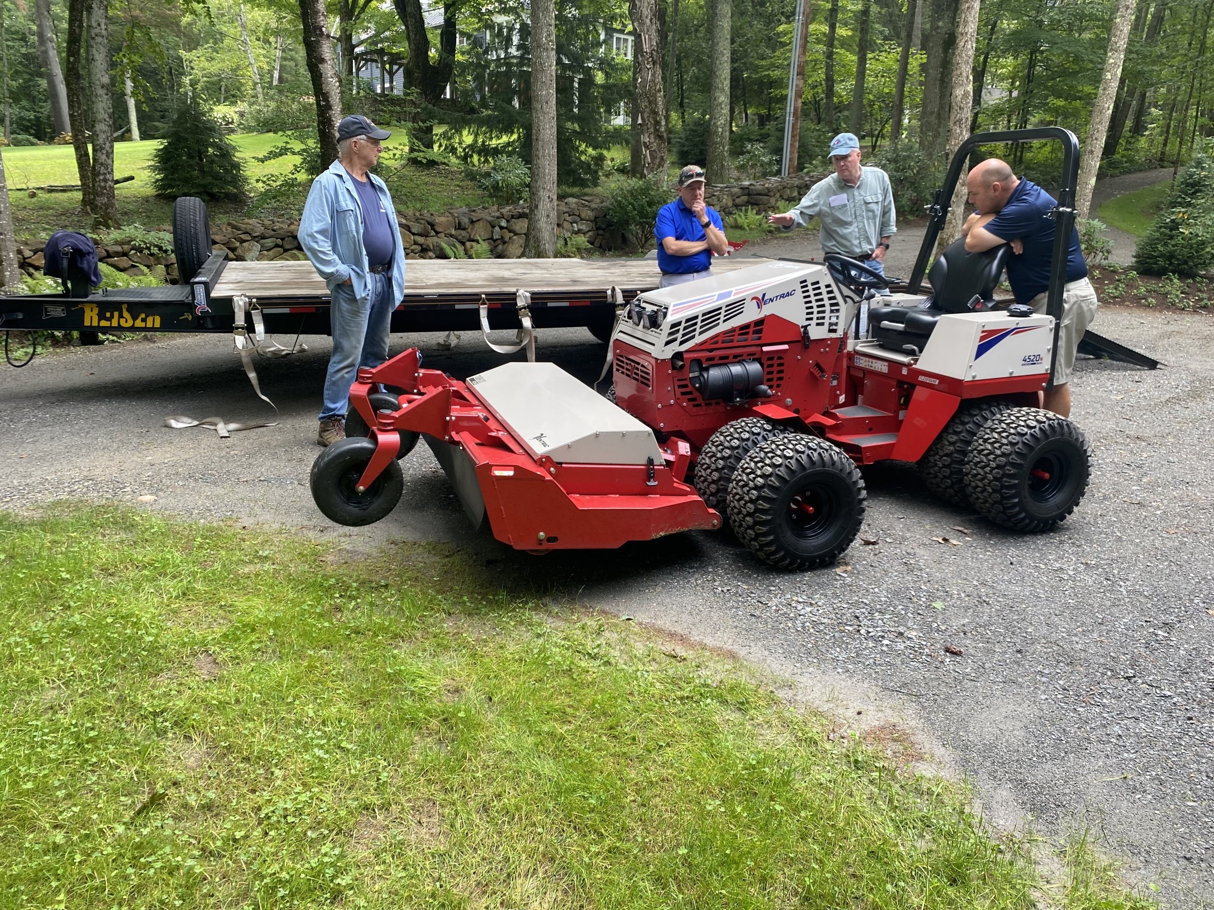

Friend had Ventrac bring over a demo machine. Kubota gas engine. Quite a rig ! Floated over a pretty swampy field. He ordered one Saturday, mower ,snowblower 3pt hitch. Not sure about the cab.
