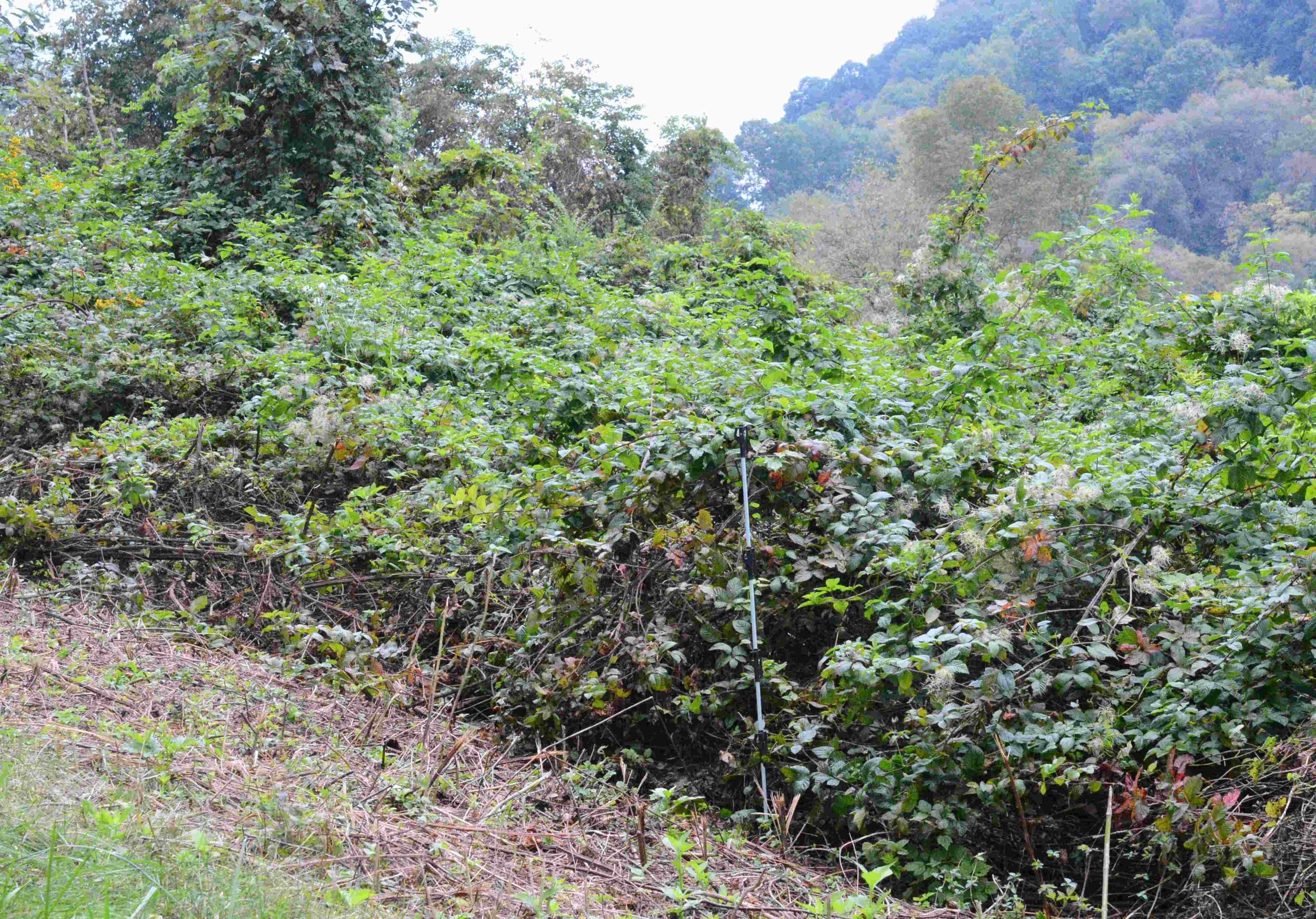

So what's your estimate of whether a flail will be able to cut this overgrown briar patch in a single pass?
A 2-wheel tractor with a flail mower will absolutely annihilate that briar patch. It's the correct tool for the job, no need to keep deliberating about it. If you don't want to buy one, I agree that renting or hiring someone for a day make a lot of sense, especially if you just want a once-and-done approach. Buying a 2-wheel tractor on the other hand is an investment - yes it's expensive, but it's a versatile machine that will last you many years. If your only goal is to clear this patch, buying brand new probably doesn't make sense. Used packages do come up often enough and Earth Tools has a bulletin board and lots of good deals.
I have all the implements that are being discussed here: flail mower, double action cutter bar, brush hog, small lawn mower, big lawn mower, flamethrower. The flail mower is exactly what you need for this job and would be the only tool I'd reach for in the case. You already have a nice clearing up to the patch so you can offset the handle bars so that you are working in the cleared space, and cut right across it. It'll mulch it so nicely that you can wear flip flops while you cut.
I think a misconception is that because they only have two wheels, they are thought of as "big lawnmowers" and put in that pricing/utility category. They are not - they are tractors in every sense of the word, and the implements they drive and just as rugged as anything you can get for larger 4-wheel tractors.
Other random thoughts based on things you've brought up:
* When clearing land, things happen fast. Speed is not your friend. Even 0.8 mph will be too fast some times and you'll be wishing for a half gear slower (or a hydro)
* You shouldn't consider anything other than the largest foam filled tires you can get.
* I've never spun the wheels unless I drive it right into a big tree or solid object. You'll bog the engine down first if you've got too much material under the deck.
* You won't need to be working hard behind the levers, because you won't need to apply pressure to lift the deck. You want it flat on the ground.
* I'd only be taking "nibbles" if I thought there was an obstacle somewhere that I couldn't see, like a partially buried concrete footing or a rusting pile of iron that someone piled up.
* Doing a 180* turn while mowing in 3rd gear will have you running to keep up, but in all other conditions it's a walk in the park
