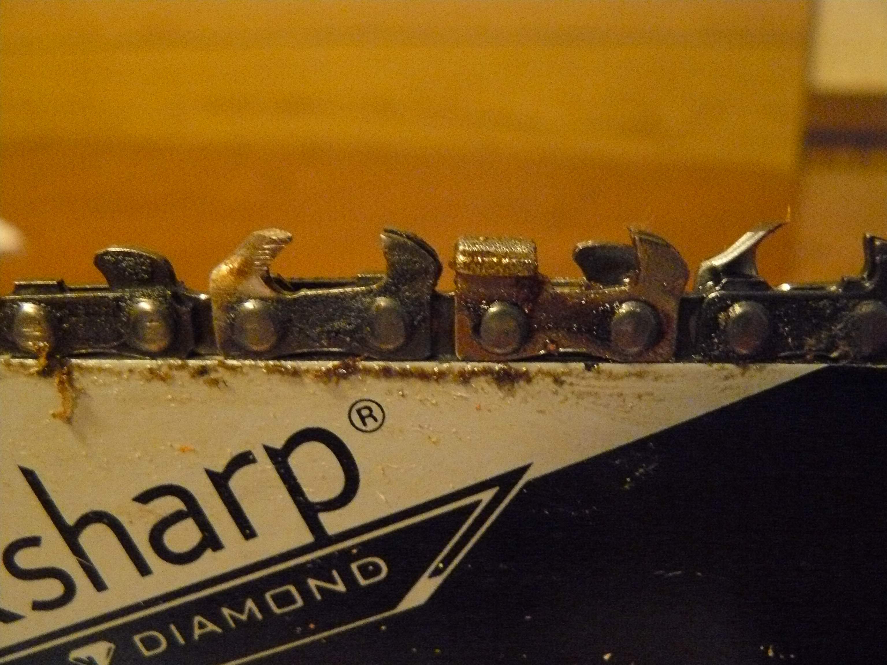

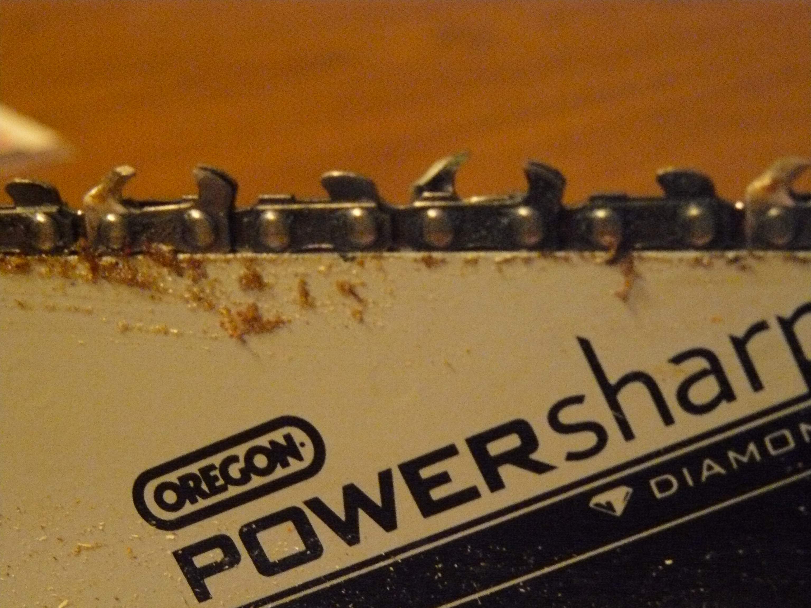

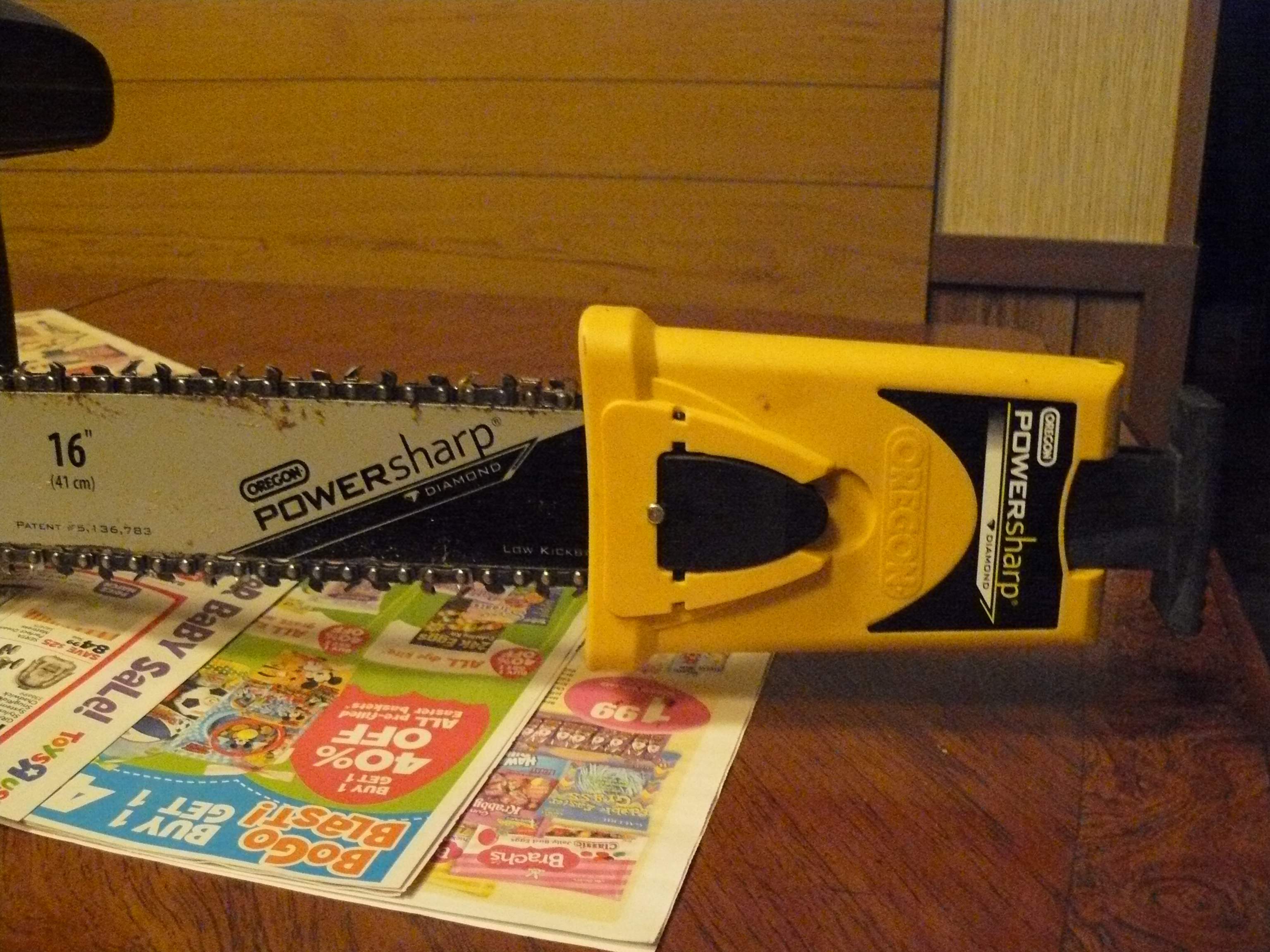

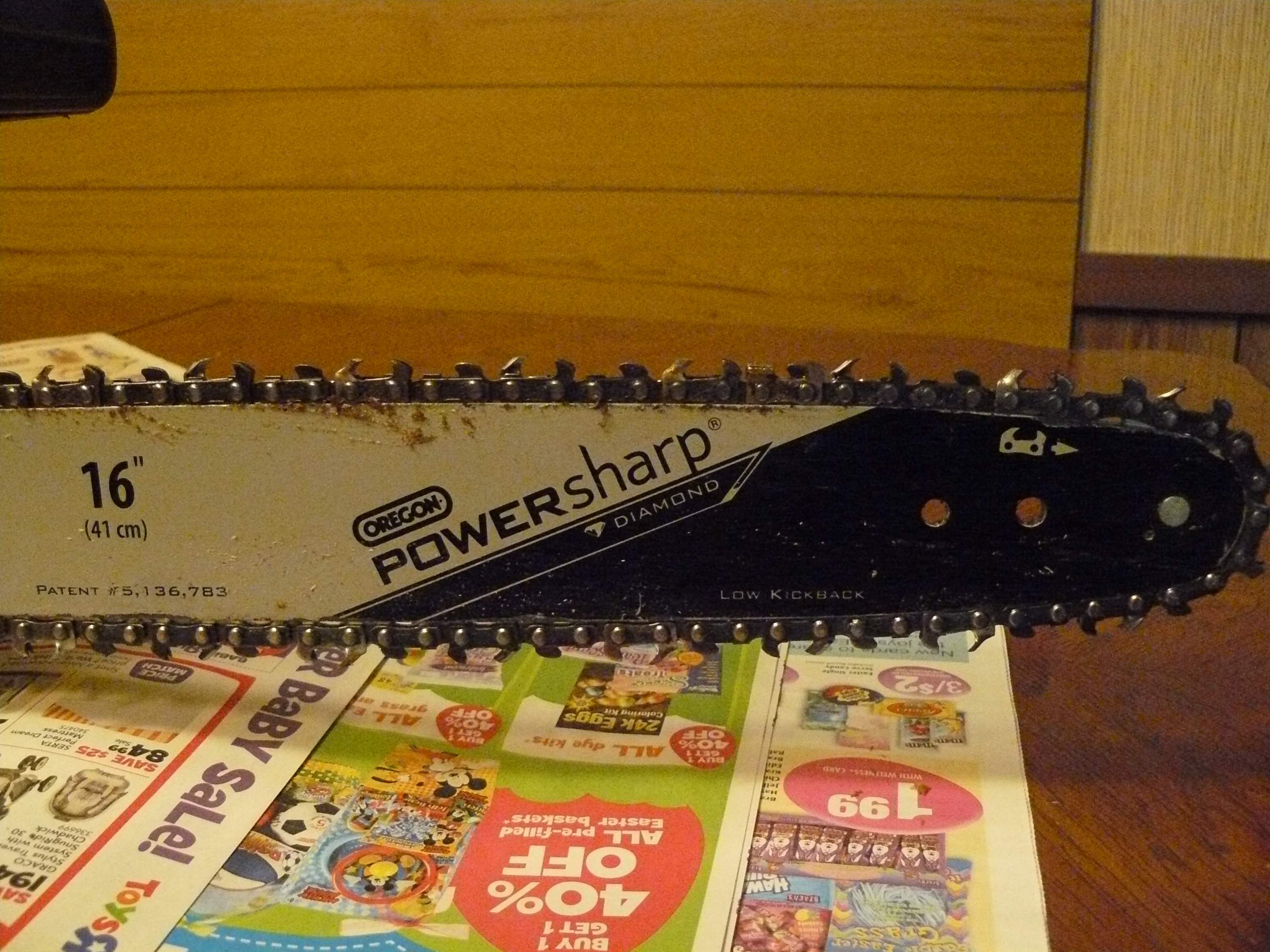

Alright my 2 cents worth. I do a lot of cutting and was bad mouthing the self sharpening saws a while back. A Oregon Rep contacted me to see if I was willing to try out the Power sharp system? He sent me a bar and chain for my Husky 338XPT top handle. I use this saw up in the tree and for ground work. He asked me for the serial number because it made a difference as to which set up they send. I gave him what I thought was the S/N. The bar they sent didn't have an oil hole in the side of the bar.(my fault for wrong serial number) Rather than send it back for the right one I drilled the oil hole myself. It is an odd looking chain profile. I noticed that it does tend to grab a bit. The chain cuts really fast. My two ground guys kept grabbing my saw to use it because they liked the way it cut. They aren't real experienced and kept pinching the chain off. What I noticed was the driver links would deform easier than my standard chain. A touch of the file to clean them up and back on the bar. No big deal again for me. What I do is run the chain fairly tight. After about 2 months I finally decided to put a sharpen on the chain. Snapping on the sharpener was quick and easy. Just snap it on the two guide holes in the tip of the bar and snap a flip latch. Start up the saw. Rev it up to 3/4 throttle and bump the end of the sharpener against a solid object for a few seconds. After that I checked how it cut several different types of wood. It seemed to be cutting just as good as new.
On the positive side it keeps a sharp edge longer than my standard chains. I don't have to pull the chain off to put it on the sharpener. That saves time especially if you bugger up the chain in dirt.
The negative side is what appears to be soft driver links so run the chain fairly tight. If you toss this chain on a standard bar without the guide holes you won't be able to use the self sharpener. And you might have a hard time hand or machine sharpening this chain. The fact that the cutting teeth are harder should decrease how often you have to sharpen the chain. Also make sure you order the right bar for your saw.
Would I buy one of these systems as a replacement for bar and chain more than likely if the price was right.
