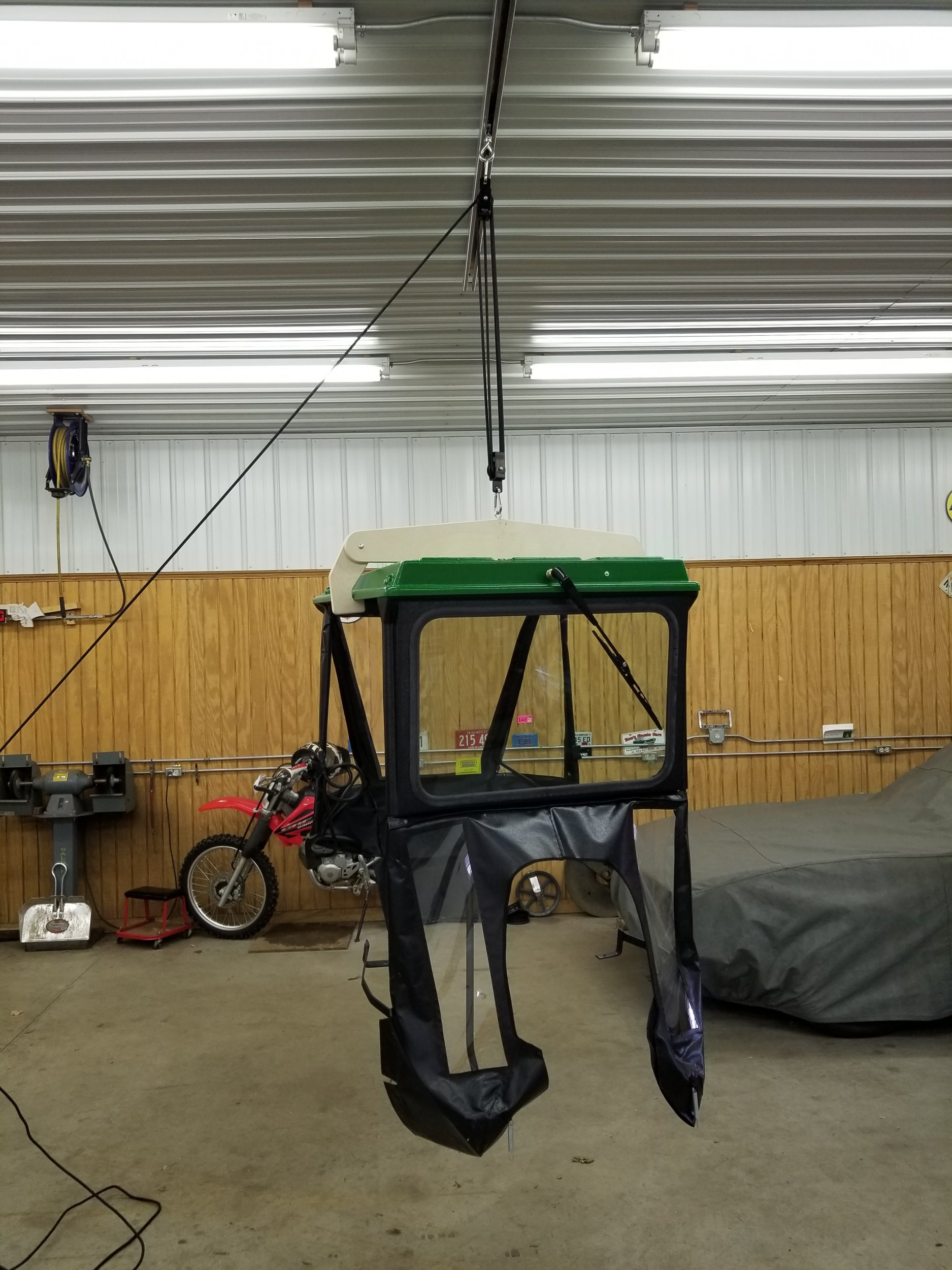

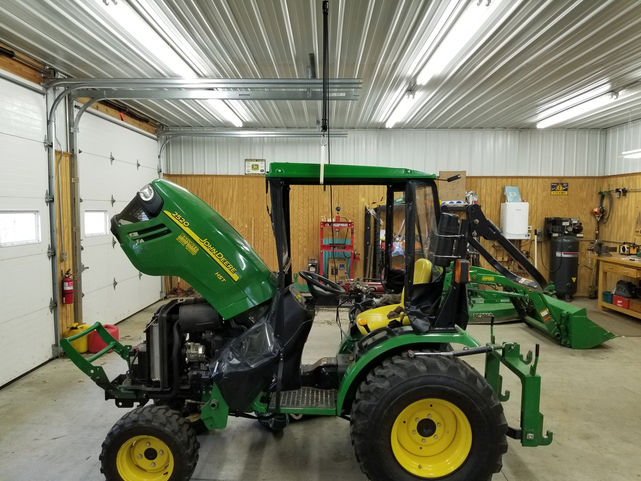

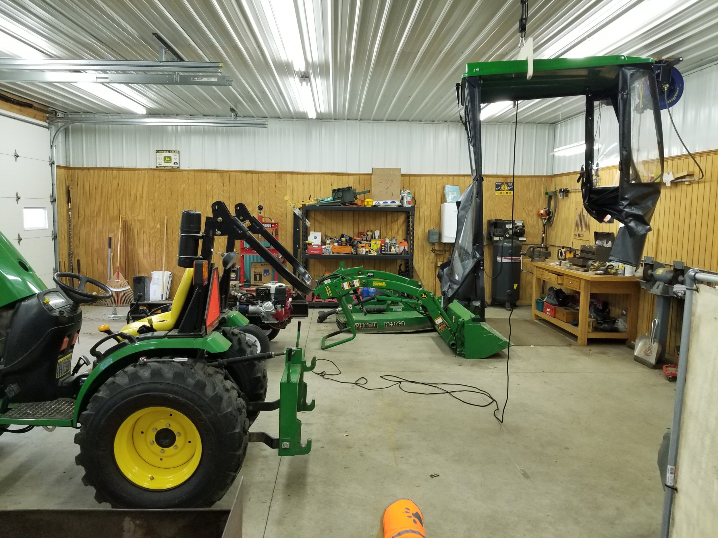

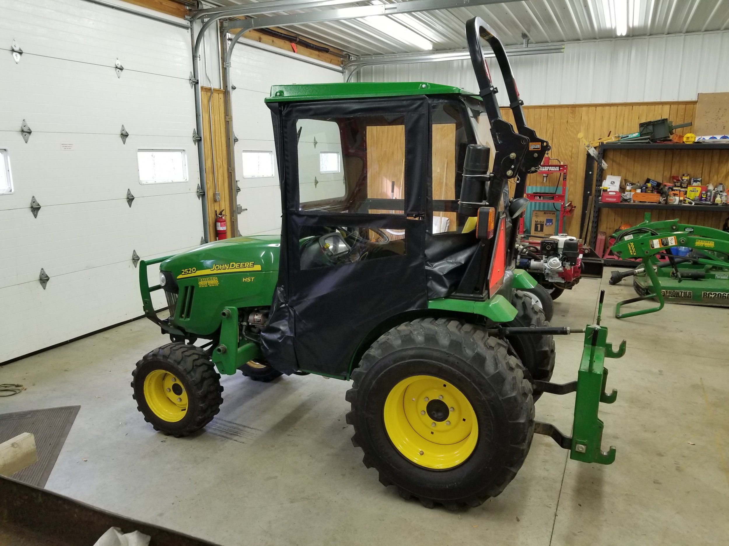

Thanks for the responses everyone! It really helped. I like the idea of keeping the cab together and since a few of you have had success lifting and lowering the cab... here's where I landed.
I added a box rail (for barn doors) to the ceiling of my shop this week. A single truck supports a deer lift; it has a lock so it can lift, lock, and slide without hands on the rope. Next, I fashioned a beam lift that secures onto the top of the cab.
Backing the tractor under the rail center, my wife and I just slid the cab over the ROPS and lowered onto the tractor.
It took about 3 minutes total to set the cab; an absolute non-issue. The next 45 minutes, however, was bolting it in, adjusting, and hanging the doors. Wasn't too bad. Hopefully, I'll get faster at it with practice! Thanks again for your help everyone!
