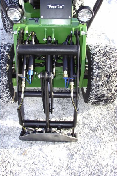

Carrying a heavy load in the bucket going around the side of any slope is somewhat dangerous, IMO. You absolutely want to keep the load as low to the ground as possible. However, I would point out two things that are different between the PTs and the Carraro tractors:
1. The PT is rear engined -- most of the weight is in the rear of the tractor, not the front. Also the loader lift arms attach almost directly over the front "axle" of the PT.
2. The center of gravity on a PT appears very low in comparison to the Carraro -- somewhere at/below the top of the 23" (or 26") tall tires.
This picture shows where the lift arms attach to the body of the PT, only slightly in front of the front "axle" and slightly higher than the front tires. The lift pistons attach below the centerline of those wheels.
Lift Arms on Mossroad's PT-425
The only time that I've noticed my PT get "tippy" is when you articulate sharply on a sideslope, shortening the wheelbase dramatically on the downhill side...
