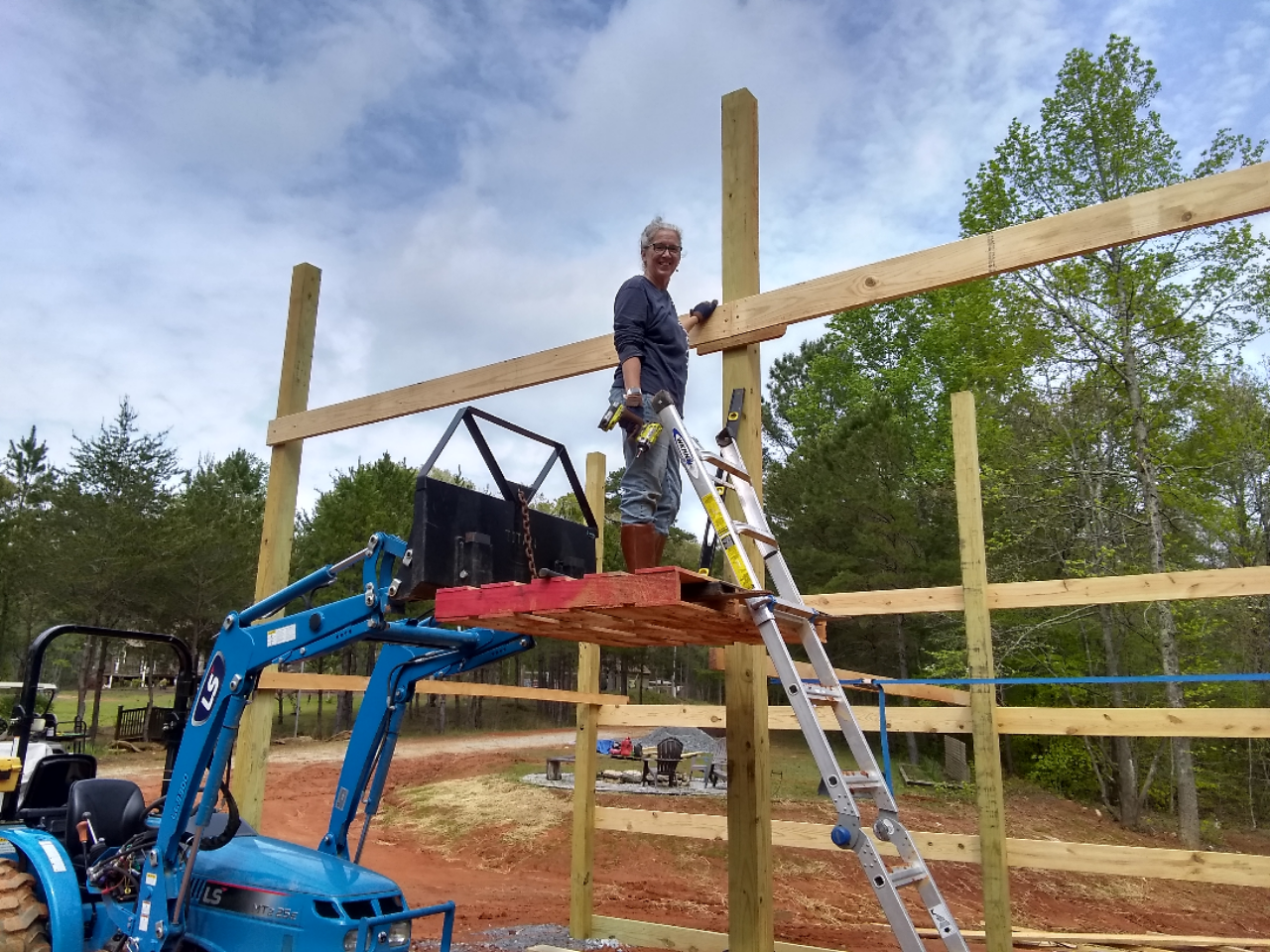

What length post did you use, and what was your method for setting them? I am getting ready to do a barn build and am putting 20' post in the ground and am wondering if I should make a boom pole for the front end loader to set the post. My tractor bucket will go 13' off the ground on it's own.
Whenever I set vertical tube steel we rig it to be just bit heavy on the ground end. One person can normally one hand guide it into position.

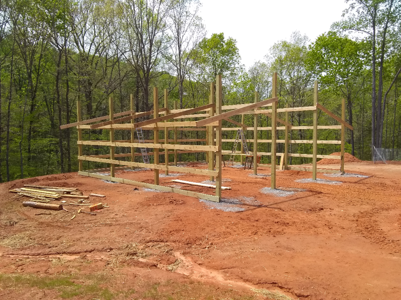

Meantime, continuing the framing that won't obstruct a concrete truck. Beautiful weekend for hammering nails. And I wasn't alone...carpenter bees out in droves, saying thanks for the buffet.

Side shed rafters done and starting on the purlins. Once the concrete gets poured and cured enough (at least a couple of weeks out), we'll start on the center loft joists, and from there, the rafters for the center aisle.

Side shed purlins finally done.
Starting to work on the loft joists and framing the opening for a stairwell.

Loft joists and blocking complete. Joist blocking is one of those slow, repetitive, nearly invisible tasks. But it sure stiffens a floor.
