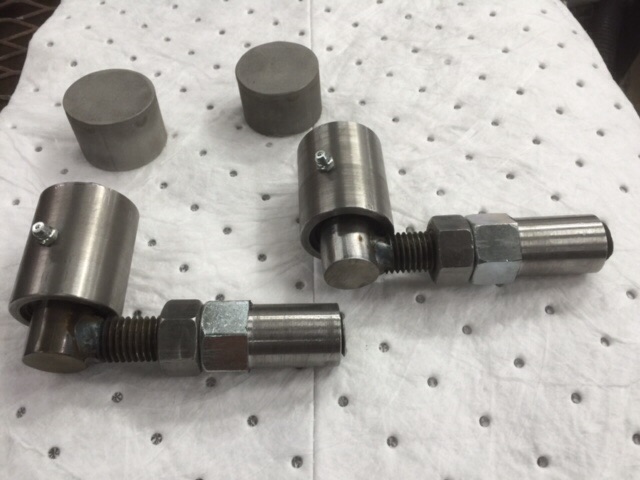

Coincidently I just install one of these. Some of the reviews on the Mighty Mules weren't good but I took a chance. I planted the pipe four feet in the ground, machined my own hinges that has two bearings in each hinge that are greasable. I also put the Mighty Mule electric lock on the end of the gate I built. I did the low voltage wire install instead of the solar system. I think I'll make a water proof jacket to go over the actuator next to help keep it dry.
Did a video on it as well. I hope it lasts.
