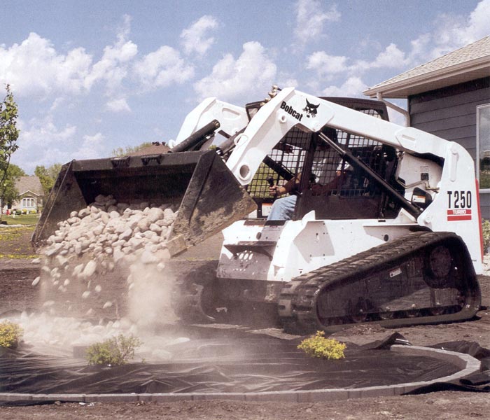

This Machine did not have wheels it had rubber tracks and at 9,600lbs with a 81 hp Kubota turbo diesel it will out dig any compact or mid size tractor I have ever seen. Again I am not trying to cause a riff it’s just you already have one tractor and I thought this may be another option for you.
