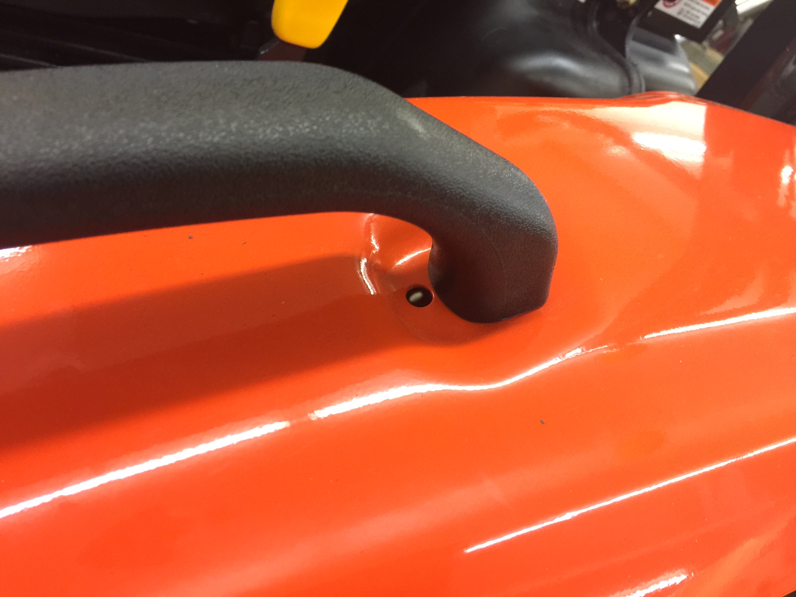

I notice in your photo that they appear to have a little drain hole there now, perhaps to help overcome this problem?
Very good point! The upper grab rail indentation has the hole, the lower doesn't need it given the angle. I'll probably do the corrosion proofing anyway, since I've gotten carried away from the start, but good to see that they've attempted to address the issue. Good eye!!! Thanks, Toukow

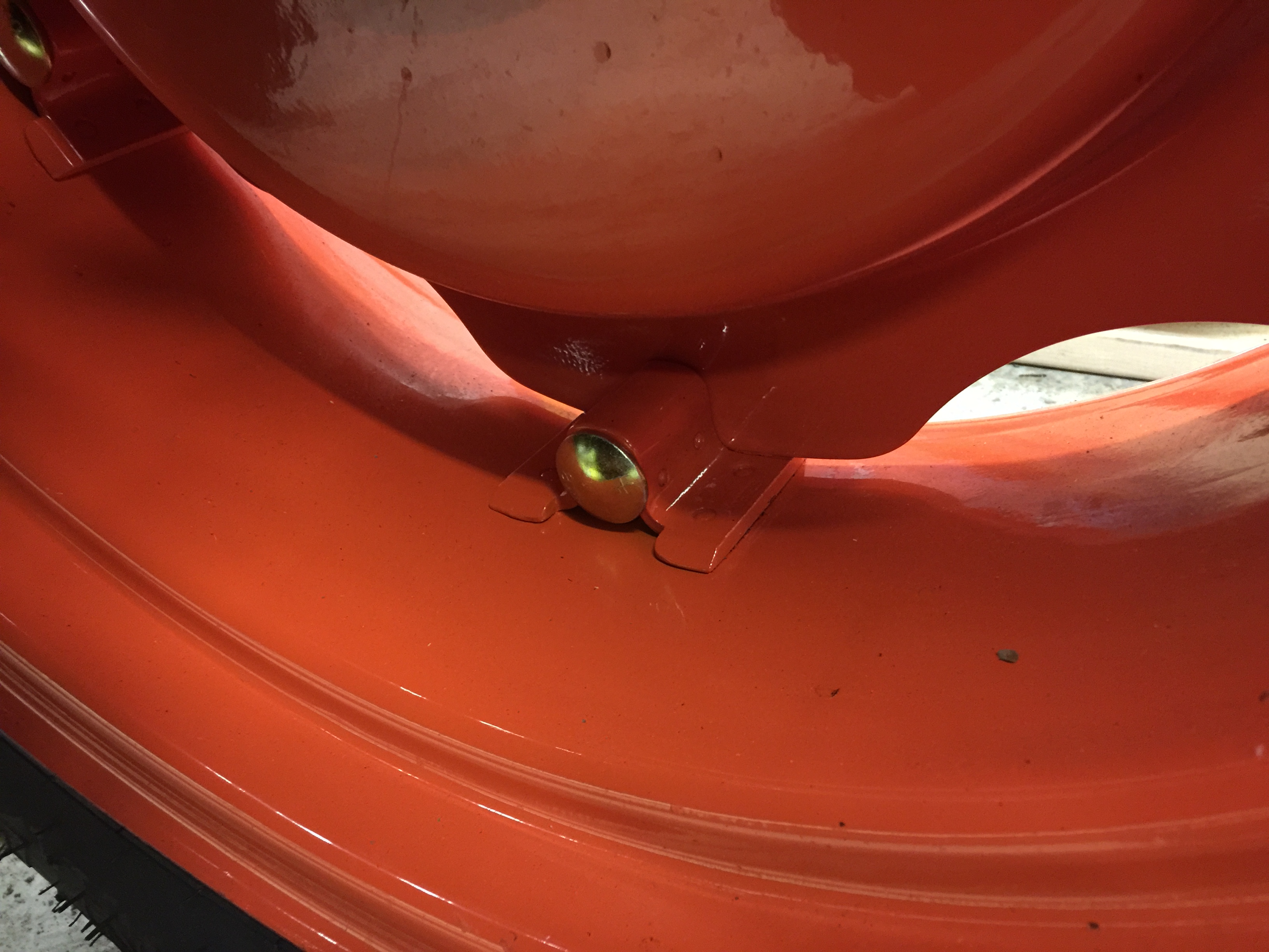

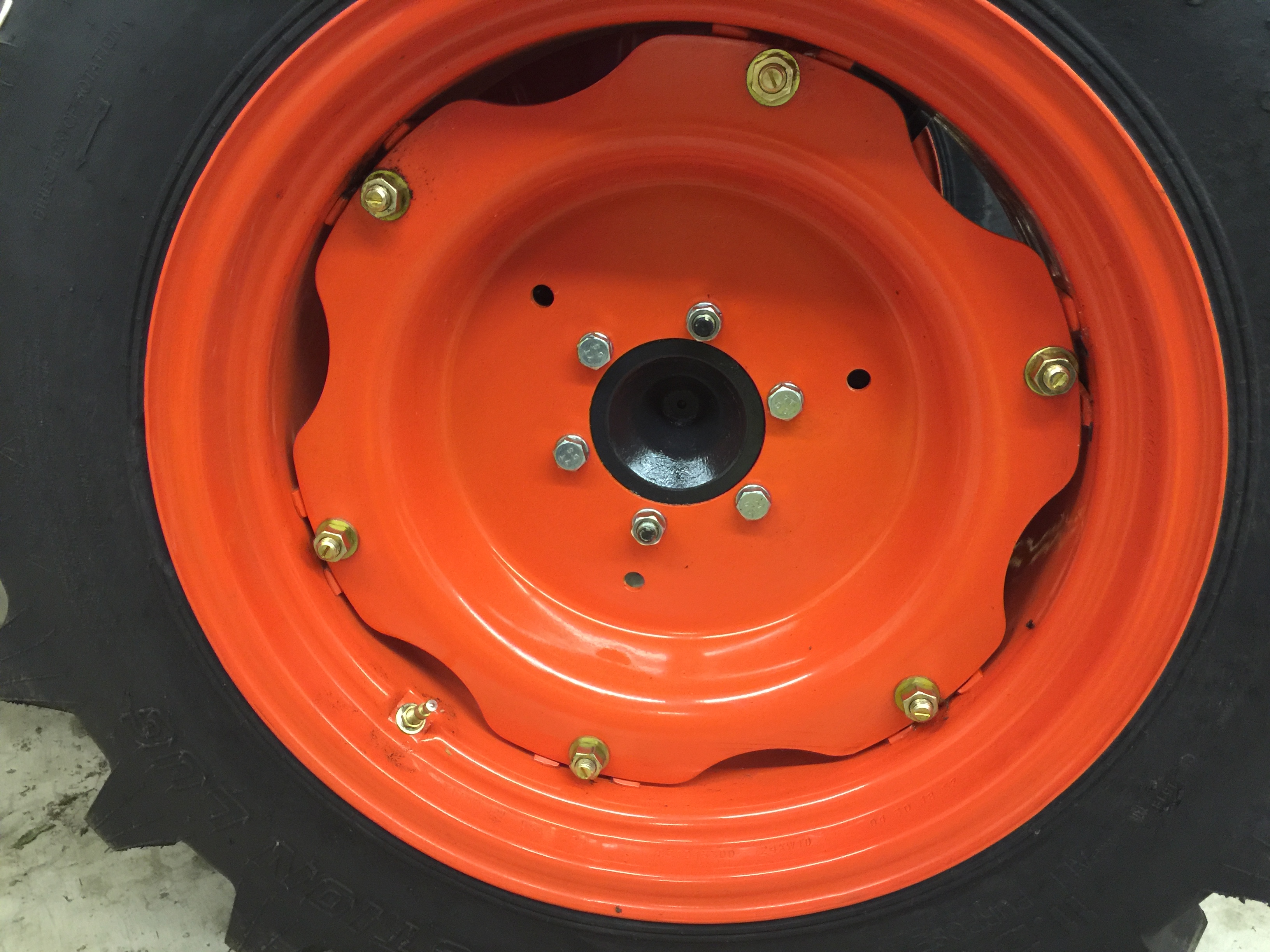

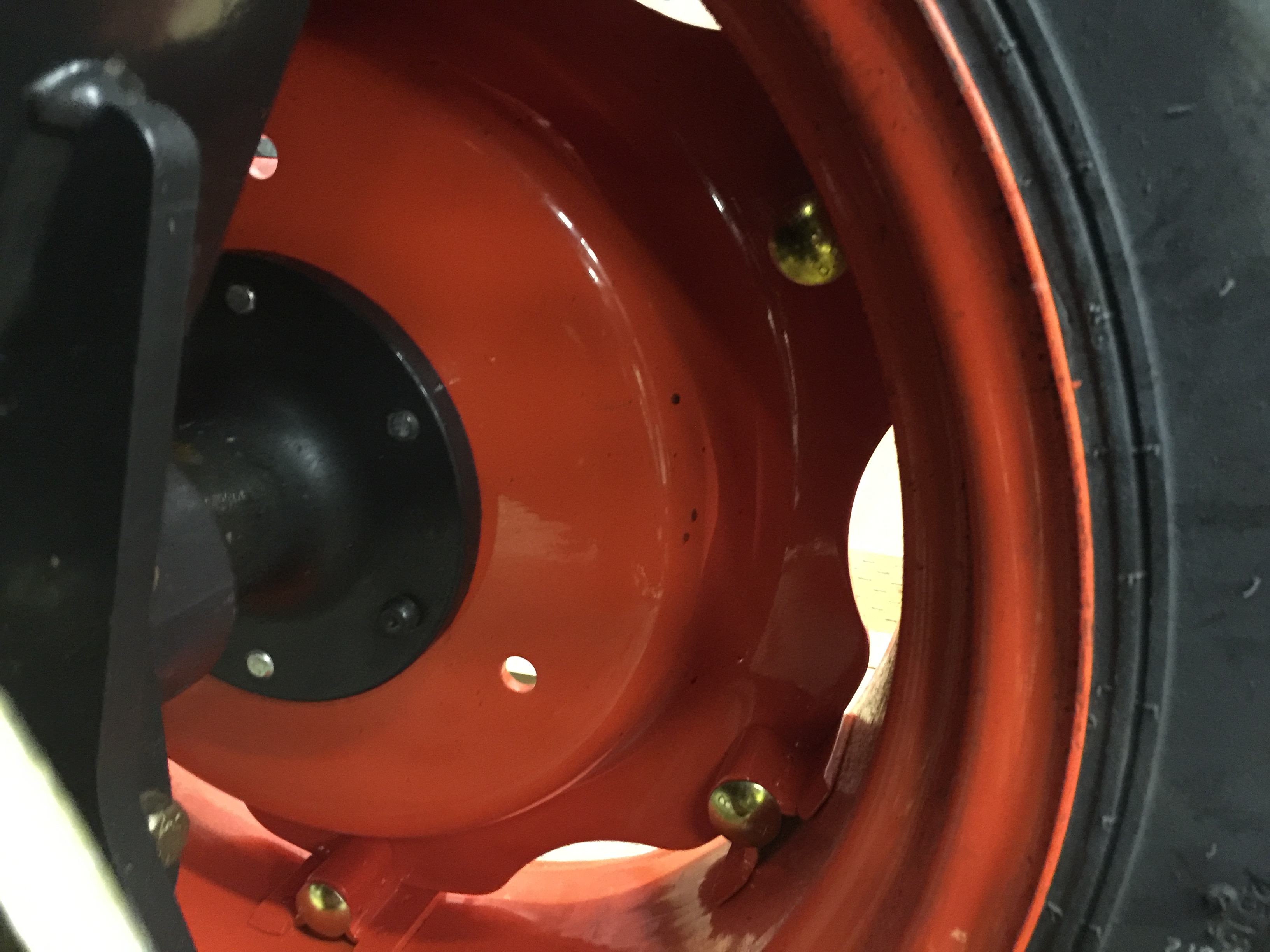

Thanks mtsman2 for the comments! So I gave it a go for the measurement to the edge of the tires, NOT the rims, not the centerline of the rims per the manual dimension noted below. I'm an electrical guy so will defer to the more experienced tractor guys, but I'm not seeing why you cannot reconfigure the bolts/center wheel plate to gain a wider footprint by a few inches in the rear. Your Kioti dealer may totally disagree though.
Tires: Titan R1 standard size
Front tires-
owner's manual states to centerline of rim 44.33 inches
measured to outside of front tires: 52.63 inches
Rear tires-
Owner's manual states two numbers:
Centerline of rims: 43.38 inches
Outside of rims/tires: 54.52 inches
Measured outside of tires: 56.0 inches.
Hope that helps, let me know if you need another dimension. Toukow

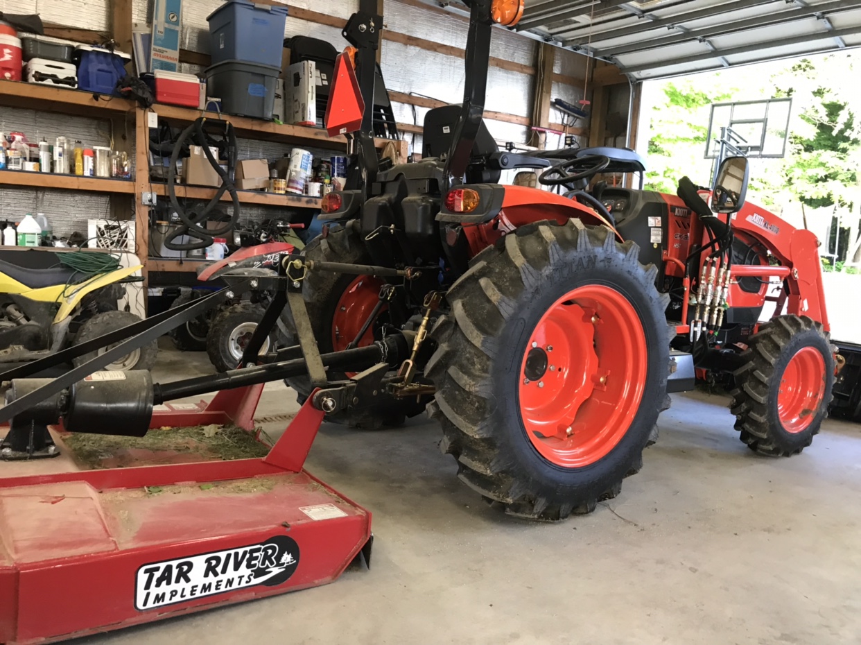

I can take a pic tomorrow, but I have R1s set WIDE. Outside width is between 62” and 64”. They are about 1” or 2” wider than my 60” rotary cutter. The fronts are about the same width as well. I have a 3510SE. It’s a billy goat and mud monster. Much better than my old Deere 4400 with R4s. Don’t regret my choice one bit. IMG_8705.jpg
   / Out with the old Blue, in with the new Orange CK2610HST #19
Oh, one important item to note about R1s set wide in the front. You can’t turn full lock. The lugs of of the front tires hit the loader mount. It’s not a huge reduction in steering radius, but should be noted nonetheless.

View attachment 611707View attachment 611708View attachment 611709
Many thanks TK! Exactly the information for which I was looking. And we can now all see that these numbers are much more useful than the printed numbers. the 3rd photo of the rear wheel is also very helpful. I can see where we can change things up. If you are up for it, can you post a photo of the inside and outside of the front wheel? If not, no worries.
Previously I did ask the dealer about widening the stance. They were agreeable to widen it on the rears and were hesitant to give me an answer on the front for a couple reasons. One of which is that they have not sold a 2610 with R1's yet so they could not give a solid answer.
