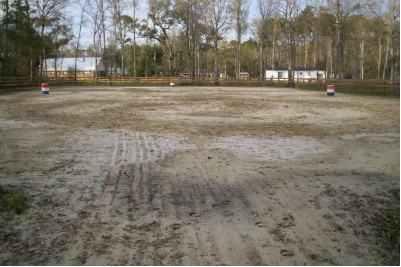

If you don't remove the rocks they will surface at a later date due to the constant harrowing you will be doing to keep your footing good. Best thing to do is clear the round of the rocks and add dirt.(all depends on what area you are in for what type of dirt you need to fill with).
good luck - here's mine
   / Outdoor arena question #16
If the gravel is large unfortunately you should probably remove it. The larger rocks will definitely surface when you work the ring. We have a 10" compacted crushed stone base that was put over the compacted subsoil with a network of drainage tile beneath that. The riding surface is 2" of sand. The compacted stone was laser leveled. My ring was definetely over-engineered but it drains really fast. You could ride in it 1 hour after a 2" rain storm. The most important part of the ring I think is the base - you could get away with a thinner layer of stone dust but the gravel should go - my two cents - Mike
