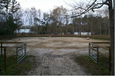

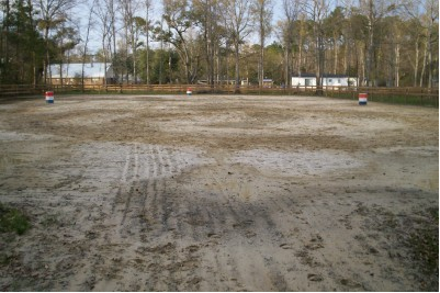

If you don't remove the rocks they will surface at a later date due to the constant harrowing you will be doing to keep your footing good. Best thing to do is clear the round of the rocks and add dirt.(all depends on what area you are in for what type of dirt you need to fill with).
good luck - here's mine
